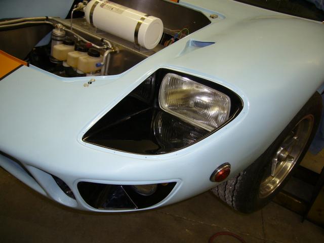

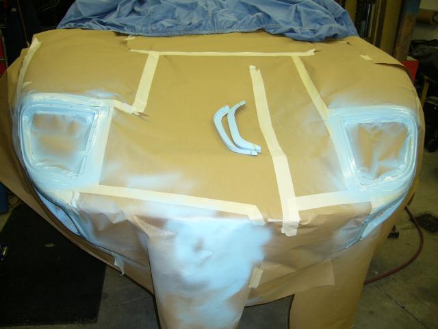

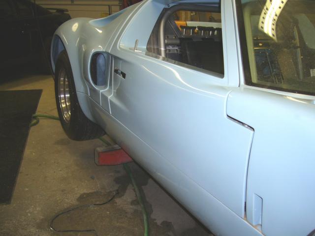

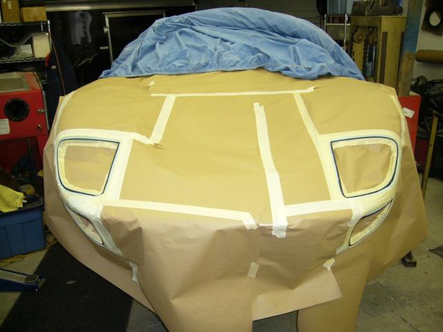

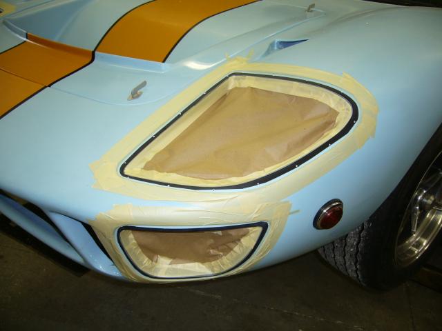

Finished the head light buckets this weekend. Ultimately decided that there was only one way that I could do it that I would be OK with. So, jumped in prepped, masked and painted the bucket lips. Took all weekend, but I can feel good about the result, and won't regret the end appearance.
For the record, I did do a test panel of sand blasting and painting. It looked good. From the top side the luster was beautiful. This would be a totally OK way to go. What I didn't like was that it "looked" like the underside of the plexi was painted, as there was a missing perception of depth and gap between the two surfaces. This is not what I was looking to achieve.
Anyway...once that was finished I got back to the wet sanding and rubbing out the paint. Probably about 60% done with first pass at this point.

Rob: looks very nice. Neat, trim lines, very professional.
I was a bit unclear about your intentions. Do you plan to paint the edge of the plexi on the back side or leave it as is?

Hi Chuck,
Nope...plan to leave it exactly as is. That is why I circled back on the paint work. Bottom line: I didn't plan ahead well enough, and there was only one way to "fix" it that I would be satisfied with.

Another question: Did you use a gloss, satin or flat paint for the light wells?

I used the same paint as for the car, so it was base coat black with clear. I wet sanded and buffed out the black just as with the balance of the car.

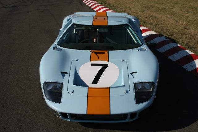

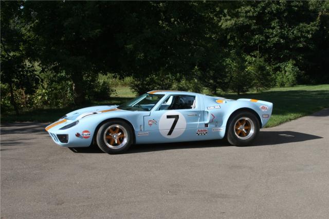

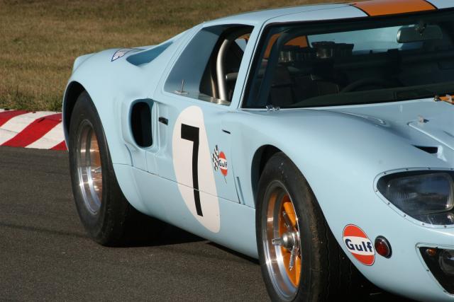

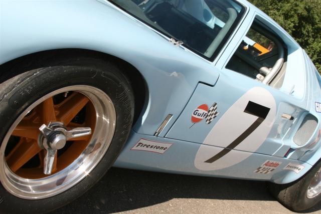

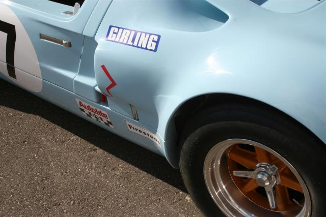

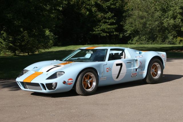

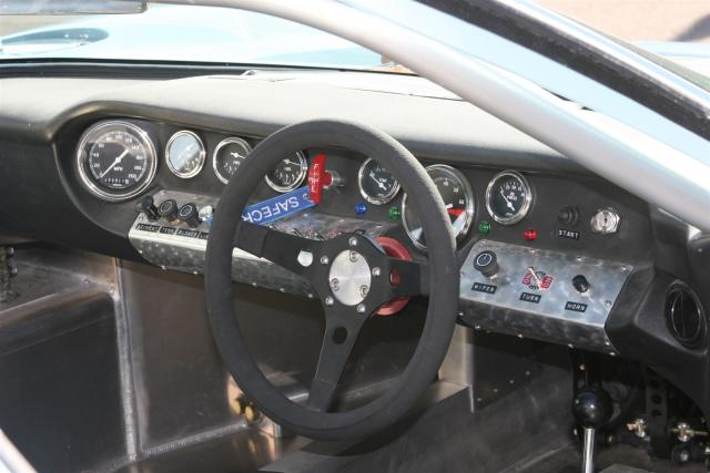

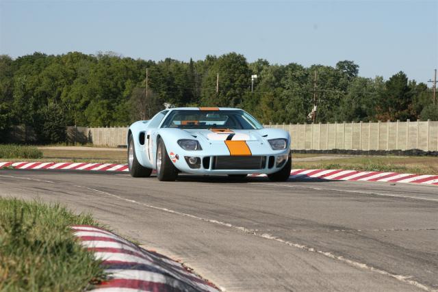

I Had the Mach I on track on Sunday, so took advantage of the photo op with the 40....
Thought I'd share.

Join Date: May 2008
Location: Silverstone-UK
GT40: SL-C023
Posts: 127
Rep Power: 2 Craig7L is on a distinguished road
Re: Rob's RCR40 Build
great job...great photos....build finished?
cheers
Craig7L is online now

The advantage of painting the back of the headlight covers is also that any dirt and dust going inbetween it and the body ( And i know from my motorcycle windscreens that there will be a lot of things going there especially in this exposed area) will not be visible. As cool it looks, i believe it won´t stay like this for long if the car is driven.
But with the setup you have right now, there is always the opition to repaint also the covers.
