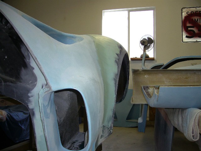

OK guys... just a few quick pics. I know I've been saying I was going to do this for a while... but spending as much time as possible working on the car.
Chassis is on it's feet and now set aside while I do the body work. Induction system from Weber Carbs Direct has been returned and Red Line system in place. ZF inversion done, Custom drive axles installed, still need to work out water neck situation and coolant tanks.
Body cut outs are all done accept frt marker lights and driving lights, as I am still deciding which config I will be utilizing. Head lights are hung, seems sanded with first coat of filler down.

Rob, it's looking great. What are you putting in the top of the tail? Looks like cutouts for turn indicators or similar.

The cut outs are for under body air pressure vents. I simply mimiced the cut outs from some vintage pics. The also make great handles for carrying the body around, and I imagine will come in handy for pushing it around too.... ;-)

I love the way you added the rear cutouts. Are you going with a fabricated spoiler like mine?
And can you explain the headlamp mounts? I need to do mine this weekend.

1) Yes, thinking I'd like to do the spoiler too. Do you have a template that you are willing to share.....:-)
2) I will be updating the tech support site with the head light assy in the coming days. Sorry, but don't think there is any way I can have it done by this weekend.

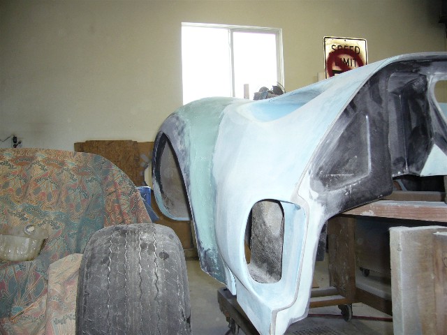

Got back on some more body work today..... had help........so it took twice as long as it should have. The pic is my daughter filling a tiny little pock hole in the gel coat....check out the volume of filler.....
Driving light mount are now also done.
I really can't help but appreciate the lines of the car while I'm working on it. The air inlets to the engine cover are just sexy as hell.....
Fortunately the RCR body needs very little work. For anyone who is building an RCR but hasn't build any other kits, you may not realize how good we have it. (No.. Fran is not paying me to say this....) I am just really appreciating the fit of the moulds very much while working the body. For those that don't know/remember from previous comments, I have build two Factory Five cars and the panel quality and mould alignment is not in the same universe. I used a gallon of filler on each of those cars. I cracked open a new gallon at the start of this project and it doesn't look like I will use 20% of it, including the work for blocking off the roll bar clearance notches.
Hopefully I will start some primer work next weekend, providing I don't get too much "help". It really slows me down, but no way in hell I'm gonna complain.

Worked the fender flares in today. Pleased with result so far. Will continue in the morning..
