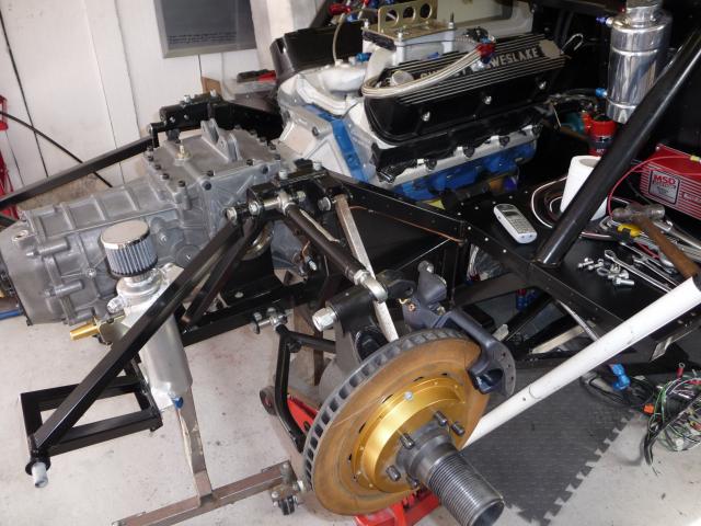

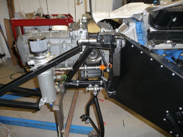

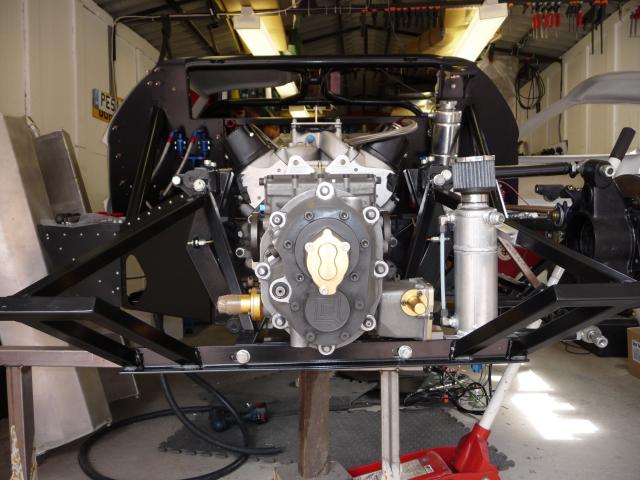

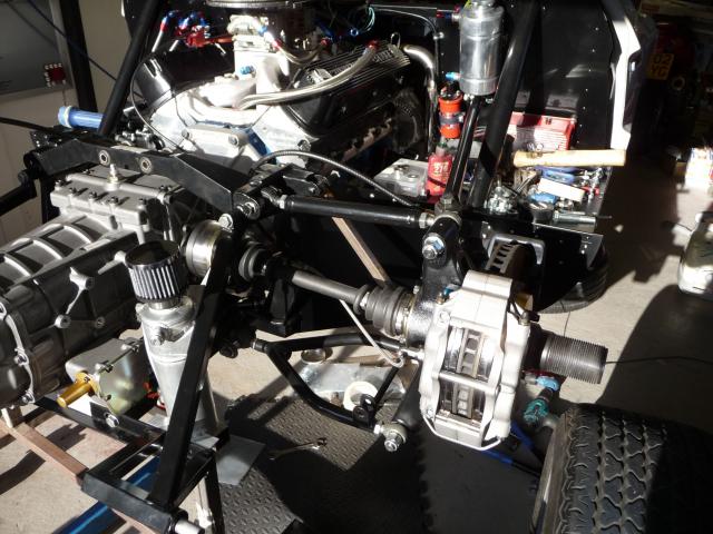

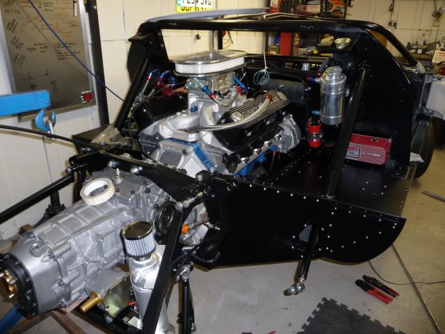

Monumental or (mental) day today. Managed to get the engine and transaxle married together and into the chassis. Did it with some help from a mate a lot of cursing and some cups of good tea. I fitted the engine into the chassis to start then jacked up the back while bolted to the engine mounts. This gives the necessary clearance for the trans to clear the chassis which I have to say was quite a bit with only a few degrees of engine tilt. Its a major step forward (or it feels like one) as I hope it is all staying together for the rest of the build. I have also managed to get the handbrake all working which was easier than I thought it would have been. I can now start to bolt things in which will now stay on the car.

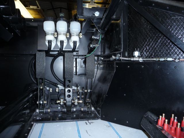

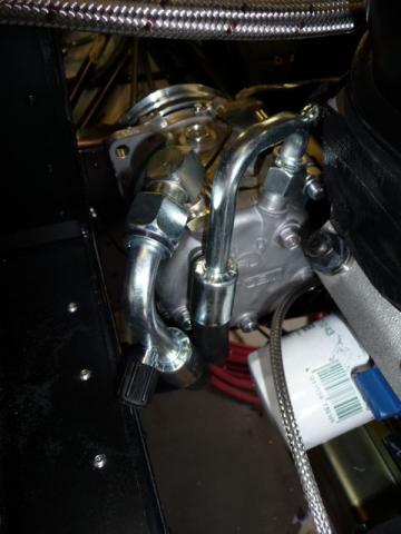

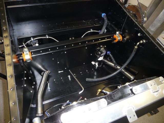

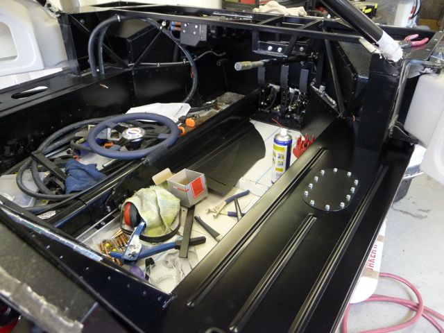

A few steps forward and a few steps back. I have managed to fit the brake and clutch reservoirs into the footwell and pipe them up. All the steering is now connected and a lot of work has been done on the air-conditioning.
Unfortunately in an attempt to save a few quid I got some of the chassis panels powder coated through the back door of a place I have used in the past. The guy did save me a few quid but has not undercoated some of the panels which have begun to flake. I have therefore had to strip the panels in situ with paint stripper, they will be etch primed and painted fairly soon and then painted with that rubbery paint used on porches etc. You live and learn as they say. Their is some good that has come out of the mess in that I have found a company that knows what they are doing and do a fantastic job.
I should have all the suspension hung tomorrow and the gearchange fitted by the weekend all being well.
ID:	39702   Click image for larger version
ID:	39703   Click image for larger version
ID:	39704   Click image for larger version
ID:	39705   Click image for larger version

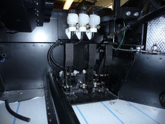

ID:	40804   Click image for larger version
ID:	40805   Click image for larger version
MartinGough is offline

Martin, great looking build! Take your time and get well. The '40 will be there when you are feeling better, more to enjoy both the build and the finished car. Best!

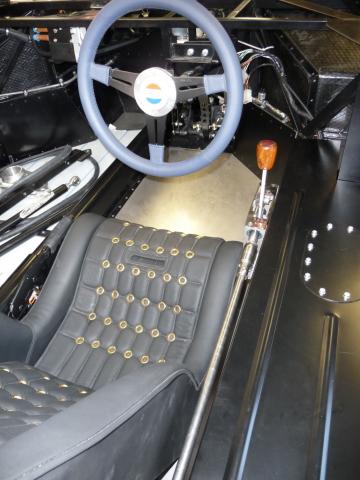

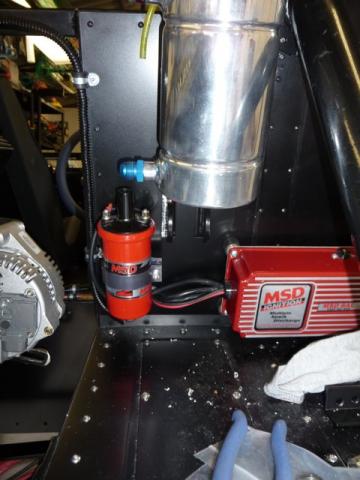

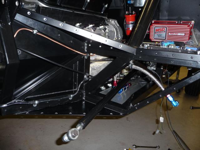

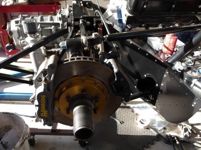

Done a bit more today. Wired up the MSD ignition, fuel pump on the drivers side, final fit on the fuel pipe work in the sills. Started fitting the suspension on the drivers side and the panel work. Finished the gear change this evening.
ID:	40842   Click image for larger version
ID:	40843   Click image for larger version

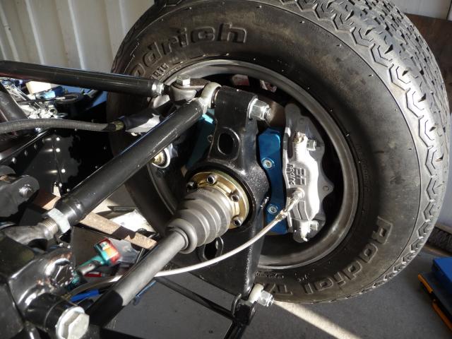

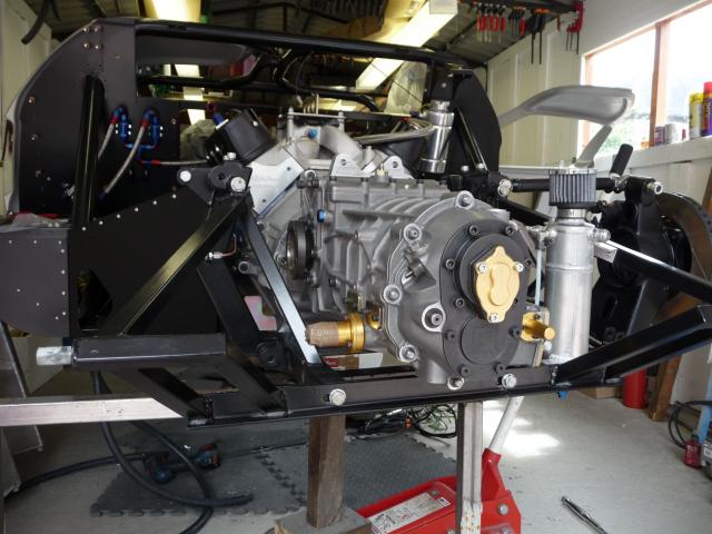

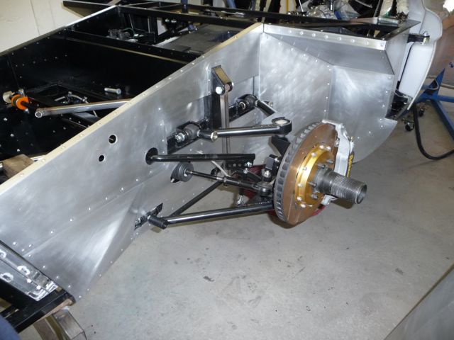

Done a bit more and hung the offside rear quarter. Taken two days but done it.
ID:	40881   Click image for larger version
ID:	40882   Click image for larger version

Still got my design springs and shocks on it then , Martin

Looking very nice. Great choice on the AP Brakes.
Garry
