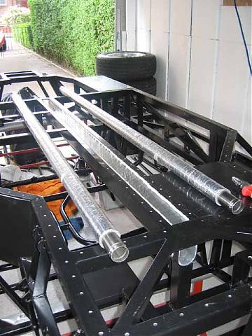

Finally managed to get the floor fitted yesterday. Started by insulating the tunnel with floor and tunnel shield from thermo tec. I then wrapped both pipes in Thermo Gaurd FR double sided. This gave a really good snug fit of the pipes in the tunnel. I then applied sikoflex to the chassis then with my neighbours help lifted the floor in position. Some more rivetting will be required as some were too short where the floor support is and where the pedal unit fits so I have temporary ally rivets in place at the moment. Will turn the chassis over early next week and begin the panelling.

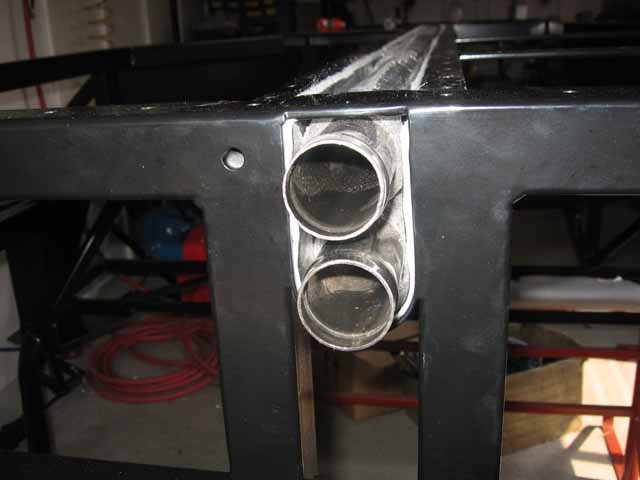

The pipe work.

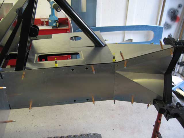

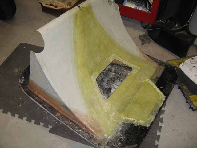

Done some work finally this week on the panels. I have to say the fit of the panels is first rate only needing the odd trim here and there to fit around welds etc. Any questions I have directed at SouthernGT this week with regard to the panels etc have been answered immediately. Excellent service.
I have also recently fitted to my current road car some deep nostrils (from Wealden Engineering) to aid cooling and have today added a panel to make use of the back of the nostrils as storage space.
Regards Martin.

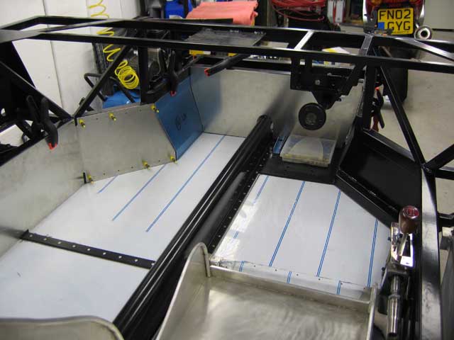

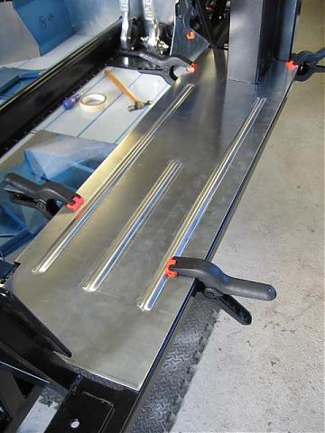

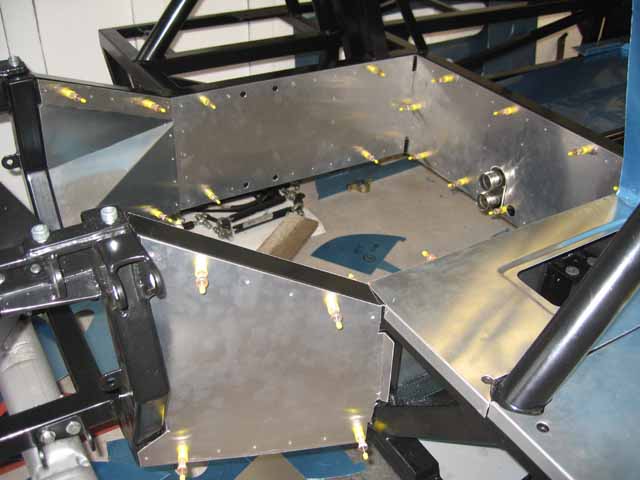

Today got back to work on the car after a bit of diy on my house. Fitted the dropped floor pan, gear change and steering column. Then started on the panel work inside the cockpit. More tomorrow.

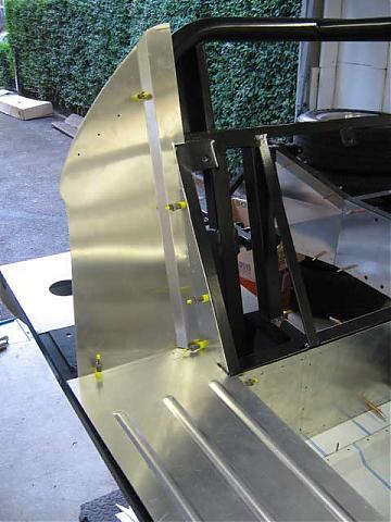

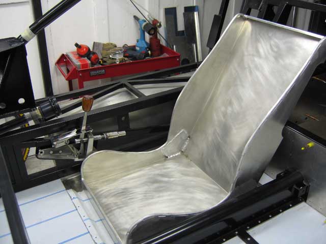

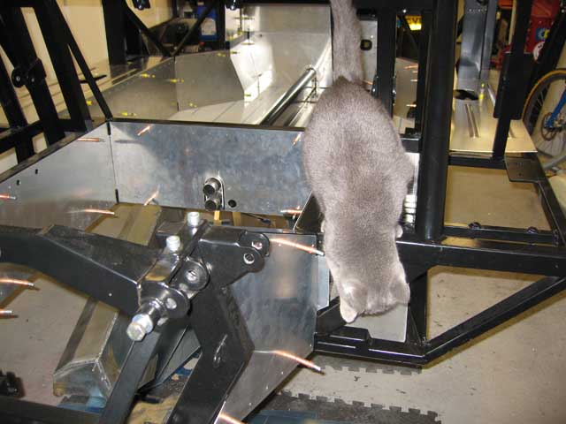

Done a bit more panel work today. Very time consuming but rewarding. Holley the cat came along to check out the rear suspension mounts.

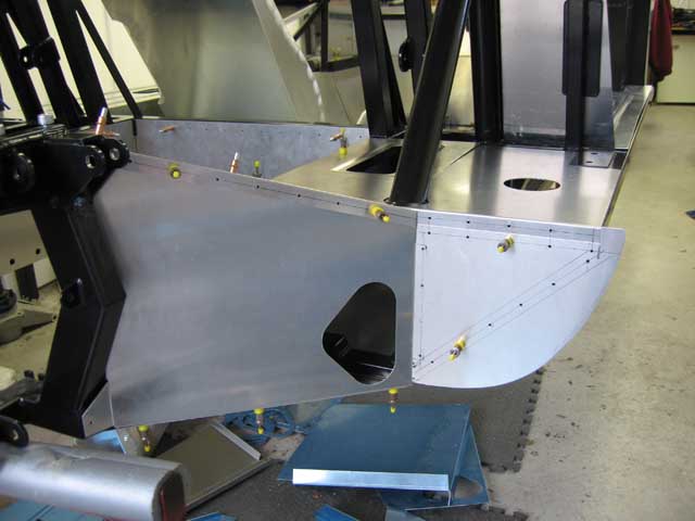

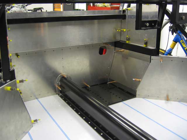

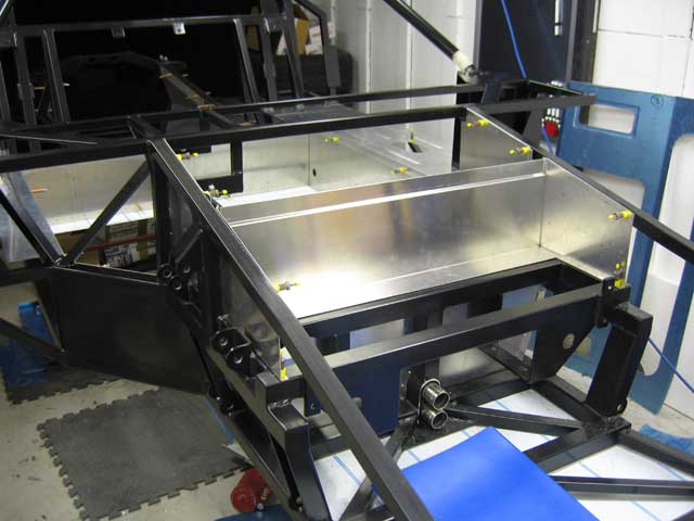

Holley goes well on kitekat and seems to be enjoying the build. Bit more work today around the offside rear wheel, tricky area to panel but sorted in the end. I will make some of the panels removable to help maintenance in the future.
