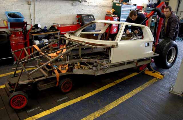

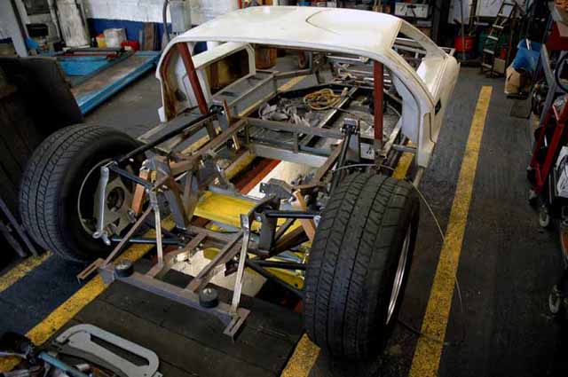

And so the first build post. The car was collected and brought back to Bath to the workshop of Bath Performance Cars. I saw Gary build a Cobra last year and was really impressed, so when he suggested he might be prepared to 'do' a 40 for me, I started thinking. I saw a car on ebay, then checked around for other unfinished projects. I found this car, which belonged to John Bransgrove. It is a KVA frame with GTD front and back sections. The glass was all KVA mk3, but I decided to go Mk 1 (which I think was John's intention). I have ordered bodywork from Chris Melia, and hoping it will be here in a couple of weeks.
2 engines came with the project- 1 a "holding lump" with the bell housing and gearbox, and the real one in waiting. This later one is 302 block built by Repower, and lots of boxes of nice things.
Gary of BPC will do most of the work, with moi painting/sourcing bits/learning/cleaning mastic off things/whatever...

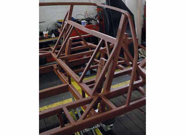

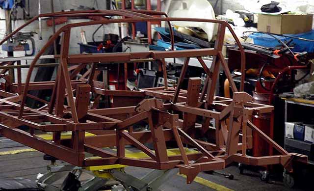

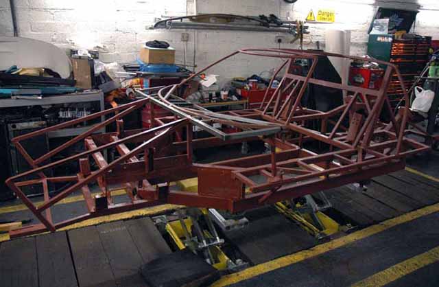

So what has happened in the last 2 weeks? Welding! Gary has cleaned up some of the joins and strengthened things up. He has also cut/welded/strengthened to allow a 2 1/2" engine drop. Below are few pictures.
I have rebuilt a set of instruments for the car (I have 6 spare 52mm oil pressure gauges), sourced some headlights (NOS 2cv), sorted some fans, and been generally running about like a blue arsed fly.
I hope to paint the lot tomorrow with a first coat of black, while Gary starts the engine build. I am hoping to set up a time-lapse camera on the engine and will post a link to the results.

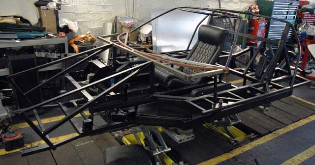

Friday... I got most of the chassis in black today. My son his starts his half-term holidays today, so tomorrow is more painting and then sorting a sump, with his aid. We are going to use a fairly standard one for the moment, with a windage tray. We will also prep the steering rack and column (Triumph). These have been test fitted.
So next week we are on for collection of the gear linkage and pedal box from Southern GT, and will start paneling once a second coat of paint is dry and hard. A set of Panels for the gtd front end came with the project, but the rest (including the bulkhead) Gary is going to make up. The first 2 questions this raises are-
1). Do people make patterns in cardboard, and test fit these? I think this is the way we are going to go.
2).We had a discussion about what to do with the sills. Checker plate is fine if anybody dares stand on it, but is rough on the elbow and hard to finish on the neatly on edges. Stainless might get stratched. Ali the same. I'm not keen on carpet that far out... So we think we are going to use thick ali and cover it with vinyl to match the dash. Be interested in opinions.
We also ordered a pair of ford racing rocker covers, and a conversion kit for the Mallory dist., and a new coil.

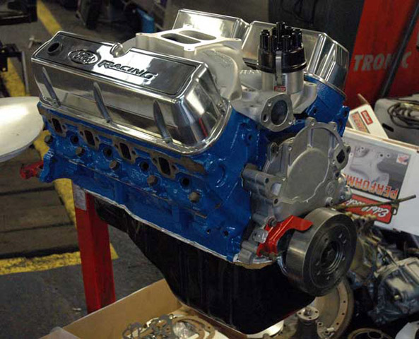

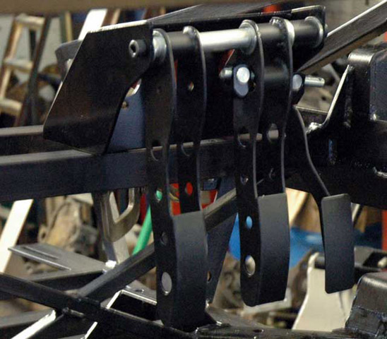

Things progress... Today I headed down to Southern GT to pick up a gear linkage and pedal box. Mick has produced what I can only describe as 'Finested Kind', and what is more delivery was faster than I could have hoped for. Many Thanks! Both items are real works of craftsmanship.
So arriving back at Bath Performance Cars I discovered that Gary had most of the engine together. Joy upon joy. My son and I have almost finished painting the chassis and we decided to place the floor pans in to work out the pedal positions, fixing points for the safety harness, and placement of the gear shifter etc. We even put on one of the door and I discovered I can sit in the car with a little headroom. I will need a Gurney bump if I'm to wear a helmet at any point.
Then there is more joy as Chris Melia says the body bits will be ready end of next week. I am fair chuffed...

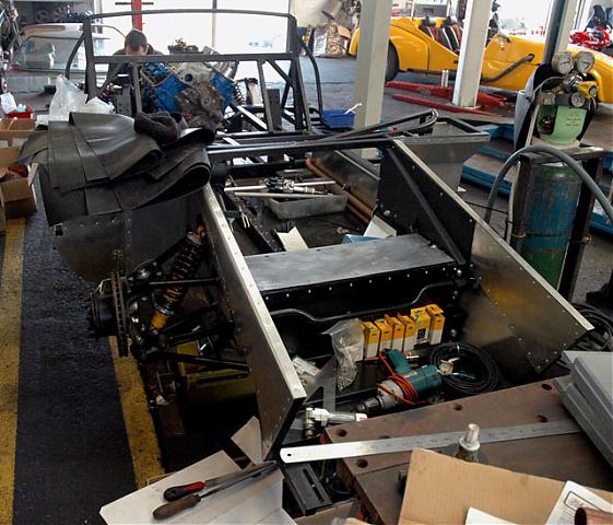

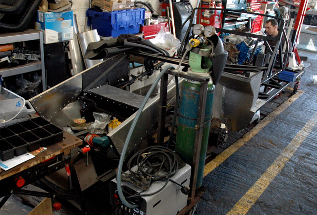

Been a while since I posted on here but we have been busy. The front end is now paneled and panels cut for the back. The gear mec. and pedal box are in and as is suspension all round. These pics were grabbed about a week ago. Since then we have mounted wheels and done a rough body fit.... more soon. Sorry about the rough pics, but mind is else where. cheers al
