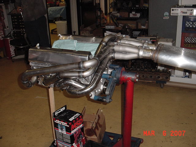

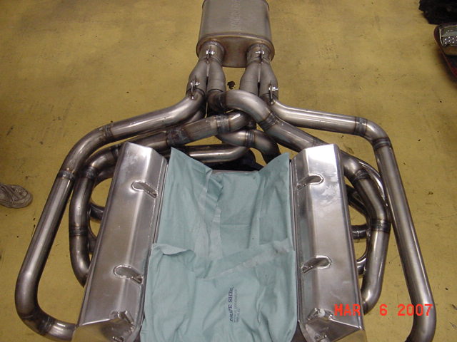

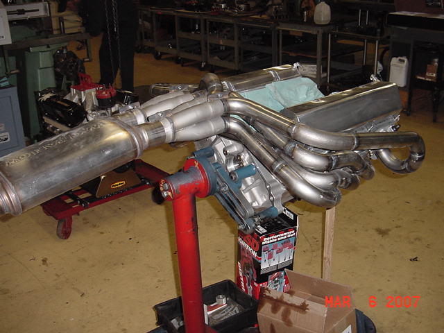

I wanted to give you a quick look at the engine. We are still waiting on the Weber intake for the 8.7 deck height Yates head motor. Check out those Headers! The rear suspension actually runs through the exhaust. The tubes are 1 7/8 to handle the high flow engine. I am not going to coat them. I am just going to spray them with WD40 and let them yellow out naturally.

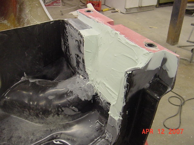

Pete you are right, I have a lot so share. The body shop has been busy but hey work slow. I am always amazed at how much longer it takes to get from 90% to 100%. They have finished up the flares. They turned out great. The 2 inch wider hips are really cool. I actually thought I had better pictures but here it is....

The under side looks like it was built this way after the extra material was removed.

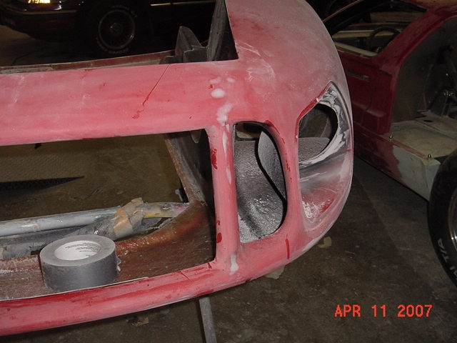

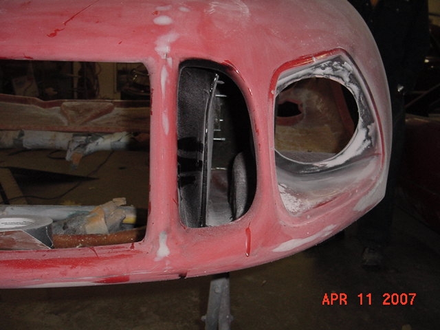

I didn't like the way the front brake duct holes looked when i bent down and looked inside. The fiberglass panel inside seemed to "split" the brake duct hole. I thought it would look beeter if it was over to one side and defininately work better if it was sealed so we did that too.

Now it will better funnel the air to the brake vent tubing.

Dean, I can see by the pics, that the original brake ducts that I make you asked about, probably won't fit in the nose. The inner panel splitting the duct opening in the nose will not allow the duct to fit up to the opening.

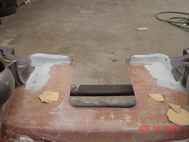

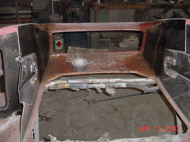

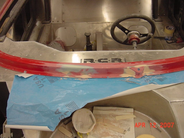

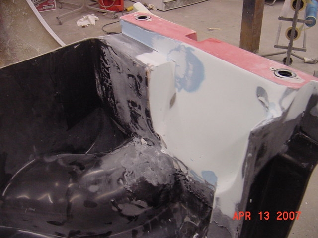

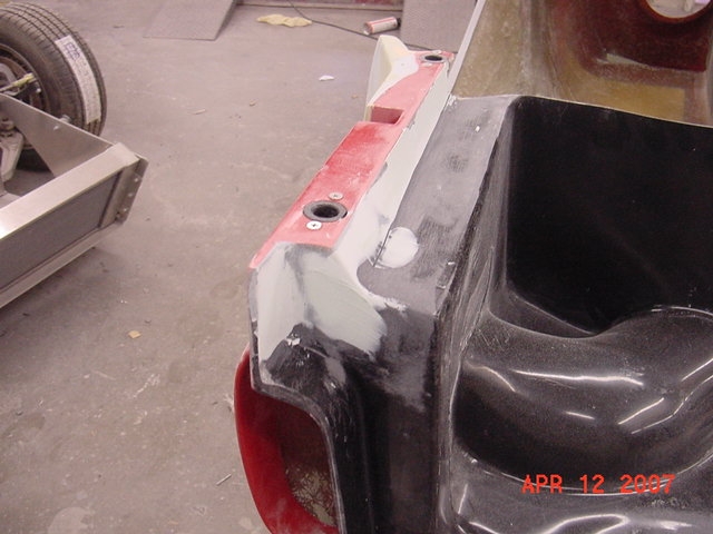

We finished filling all those odd little openings in the rear bonnet, some of which I created! There where a couple of holes where the panels where joined and one I created to clear the oil tank. We finished changing over the wiper to the left side too.
Part of the car was in primer when I left the shop today!
