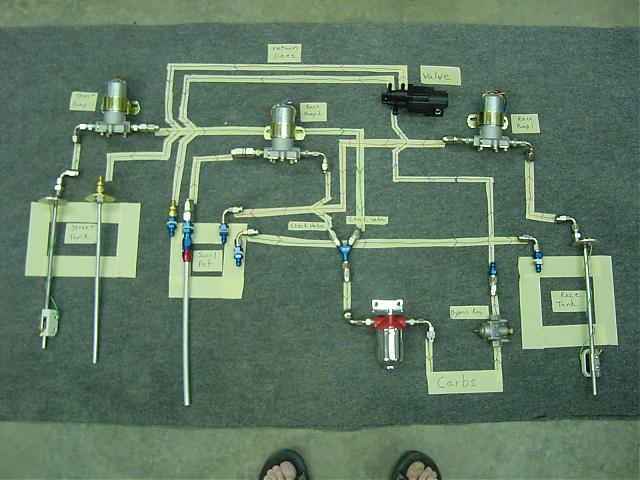

Here is a look at what has been keeping me up at night. This is my fuel system with a swirl pot that works with my "race" tank, a seperate "street" system, electric valve, three pumps, bypass regulator (not the one shown) and tons of wires, fittings and lines to be added at time of install.

WOW !
I thought aircraft fuel systems were complicated !!!
Why two systems Dean ?

Scott, I decided to run 2 systems because I wanted to keep the left tank exclusive for race gas. I don't run the type of events where I will need more than 15 gallons.
Dean,
What is your motor situtation that you need two separate fuels? Do you have an ultra high compression motor that you plan to dial back timing on and run on pump gas, or a "normal" motor you plan to adjust timing up on and run high octane fuel?
Or are you planning to have a hot motor and street motor that gets swapped in and out fairly regularily?

Ron there are two reasons for the seperate tank set up. First, I do have a timing retard switch on the dash. My engine is around 10.7:1 and I thought it would be smart to have a timing retard switch to run pump gas. The real reason is that to use the swirl pot for both tanks, the plumbing gets even more complicated and I don't believe I will need to use the swirl pot for everyday running around.

Dean - Another option would be to use a Ford E-150 Fuel Tank Selector Valve.
Selector valve assy, p/n F1UZ-9B263-B $ 77.99 from www.fordpartsnetwork.com
This would give you one feed and one return line for each tank. I'm planning on using a valve like this but I don't think that a surge tank is necessary..
I'm curious if you have a Duck-Foot on the fuel pick-up and if the fuel pickup is in it's own valved chamber..

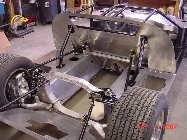

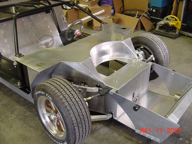

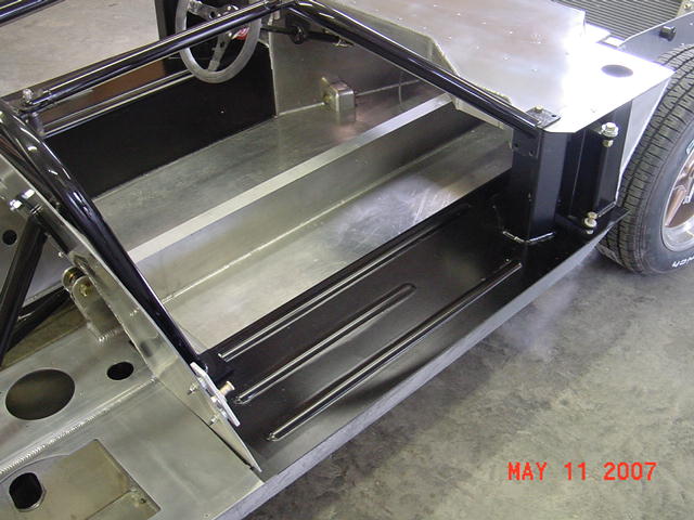

I have been very busy and haven't had a lot of time to post pictures and updates. It is all going extremely well. From this point on, I have cut the car in half. The body shop will continue to do work on the skin and i have the chassis at home to work some magic there. The last thing the body shop did was apply the sill beads courtesy of BillD's supplier. We used body filler to mold them in then we sprayed a spayable bond from evercoat to really build up the sill to make it look like a bead roll. The chassis is polished in the exposed area's although it is hard to see in the pictures and I am sure I will have to go back over it when I am done working. The guy in the car is a good friend of mine that is the master mind behind the electrical system. You guys thought the fuel system was complicated, wait until we start show ing pictures of the electrics!
Dlampe is offline

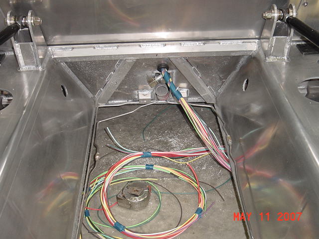

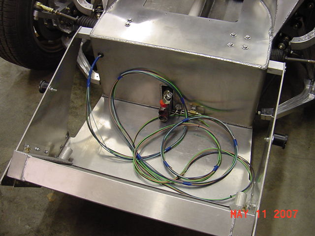

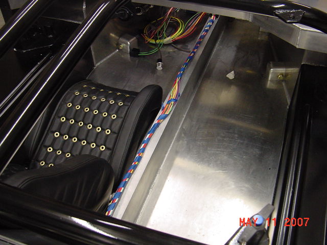

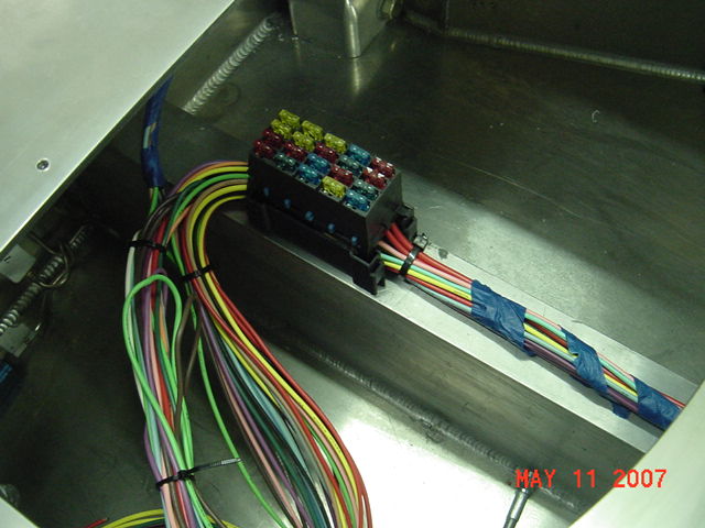

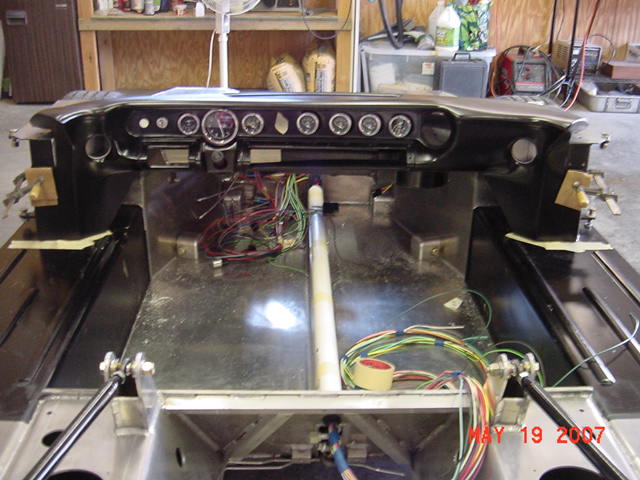

I wanted to get the wiring laying in the car and start to get a feel for how it was going to fit. I took the fusebox wiring loose so I could run the rear wires to the back and the front wires and the dash wires to the front.Click image for larger version

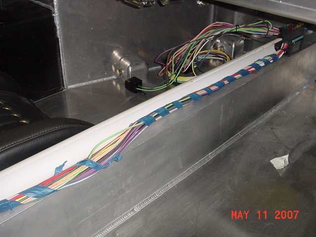

I am going to run the wires down the center tunnel to keep them away from the AC lines and the cooling tubes.
I am going to cover the wires with a peice of PVC pipe cut long ways and fasten to the top of the tunnel. It was a lot easyer option than an aluminum peice bent to fit. After all my buddy, Craig, that is helping with the wiring is a plumber!
Dlampe is offline

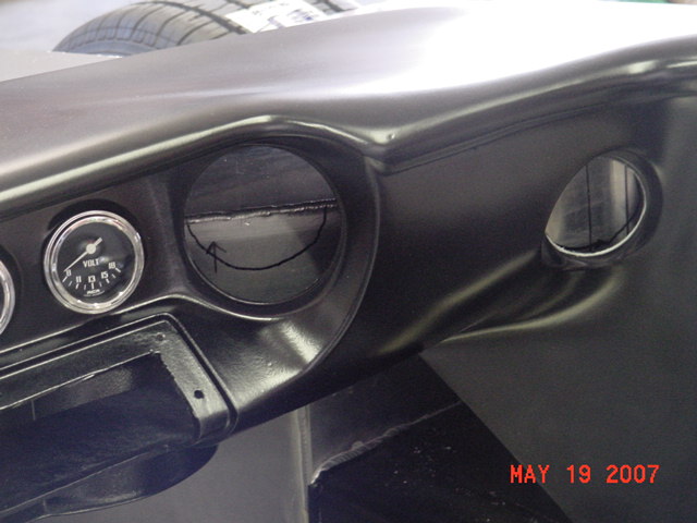

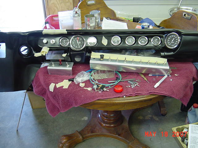

We started to wire the dash but for some reason the pictures didn't all get transfered to the computer. Here is the dash with the gauges installed and the typical wire nest that we have all seen before.
I was suprised that the dash fit as nicely as it did. I had read on another post that the dash didn't fit well, but mine fits like a glove! I will have to cut holes in the chassis for the AC vents and the speedometer will need a little clearance as well.

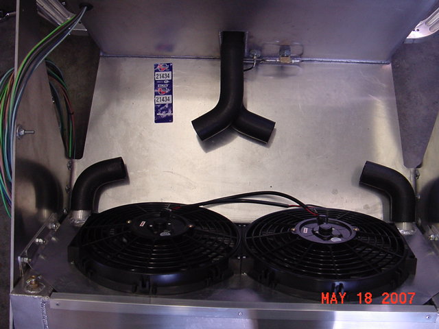

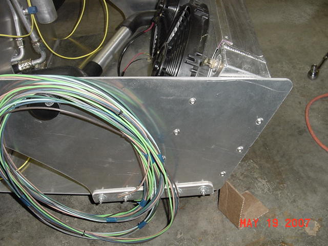

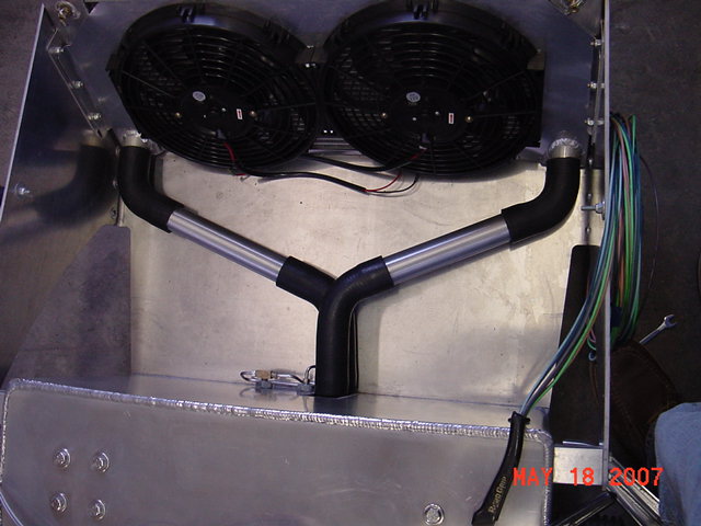

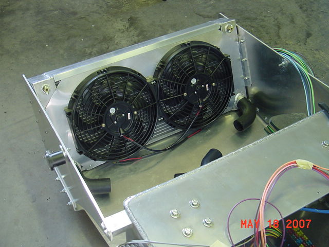

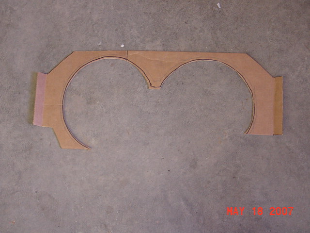

I finished up the cooling system on the front of the car. I mounted to the fans to a shroud the I cut from a template out of aluminum. I also found the perfect hoses, see the carquest part numbers. Then I just added the aluminum tubes and some hose clamps and that was about it! Again, this car is going together incrediblely well. I am amazed at how well the parts fit together.
Dlampe is offline

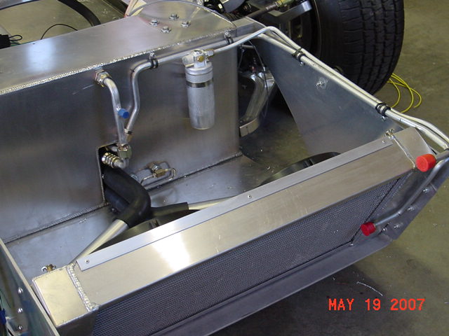

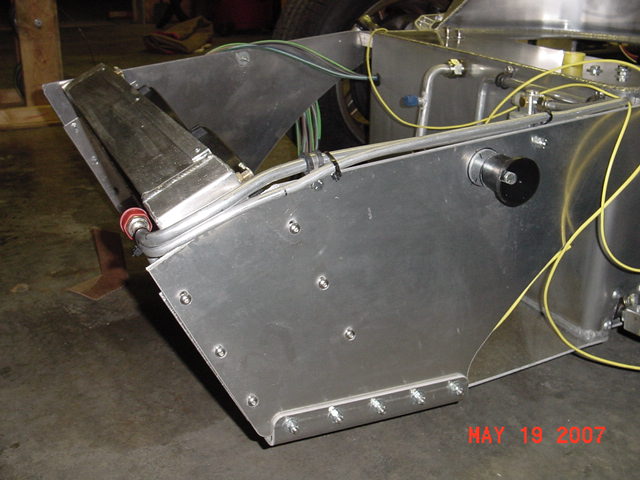

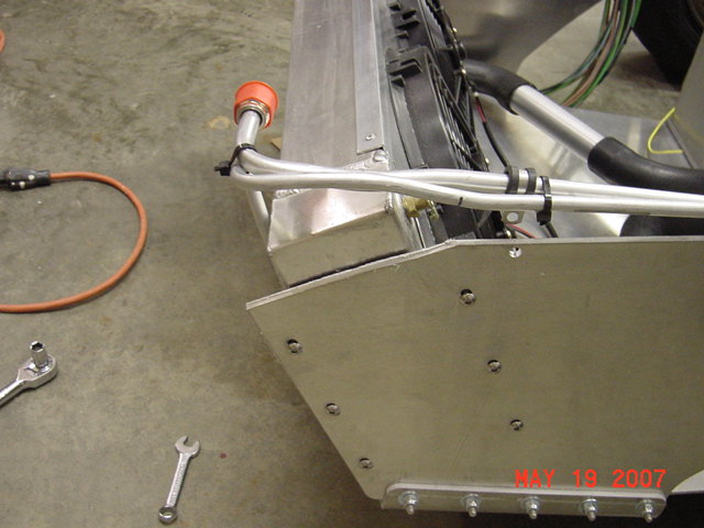

I have also finished up the AC system to the extent I can. I am waiting on one hard line from Hot Rod Air that needed to be changed to fit my front swaybar. The lines fit very well.
You can see how I had to trim the radiator support to get the lines to fit down by the side as I thought they should.
