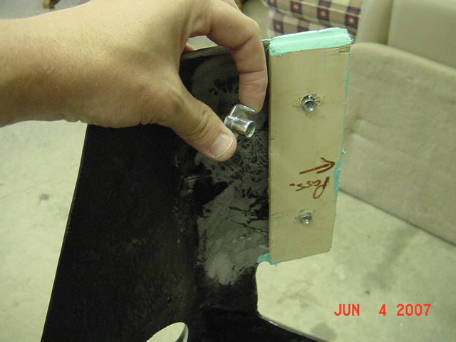

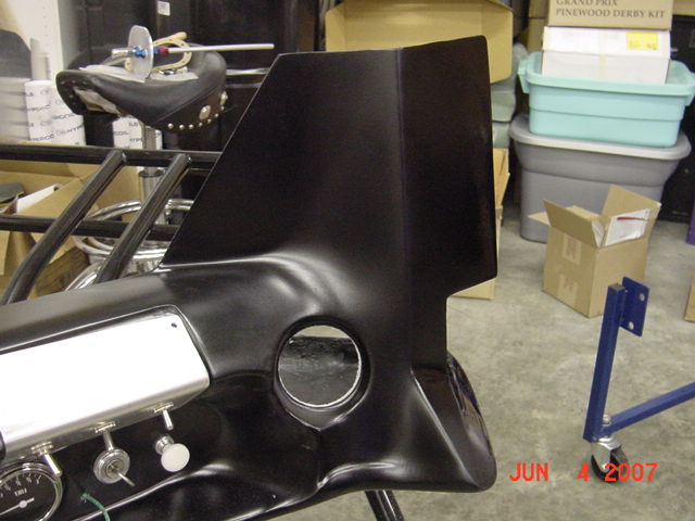

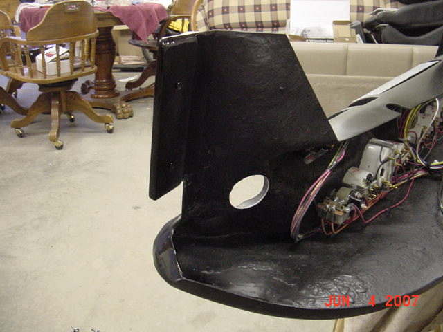

Once I had the chassis clearanced to fit the gauges and the AC ducts it was time to mount the dash in the car but I didn't want to see the bolt heads. I got an idea from a friend on how to do it and this is what it looks like.

You have to drill through the wood and the chassis, then hammer in the threads. Once you have the wood bolted to the chassis you just apply a epoxy of some kind to the wood and clamp your dash in place. After it dries, sand the wood to fit and use a little body filler to clean up the edges.
