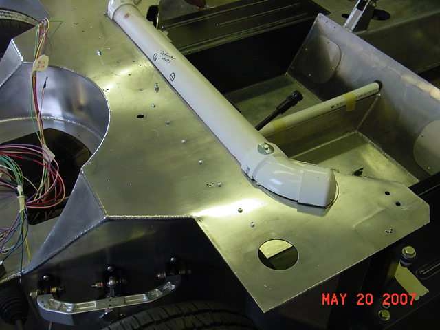

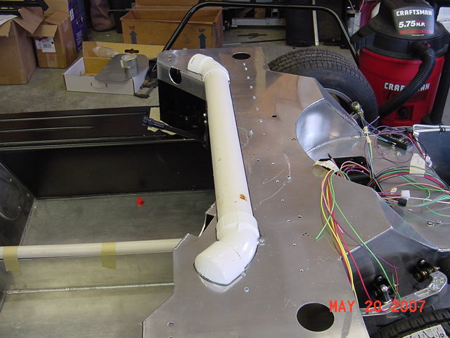

I wanted to get the wiring laying in the car and start to get a feel for how it was going to fit. I took the fusebox wiring loose so I could run the rear wires to the back and the front wires and the dash wires to the front.Click image for larger version

I am going to run the wires down the center tunnel to keep them away from the AC lines and the cooling tubes.
I am going to cover the wires with a peice of PVC pipe cut long ways and fasten to the top of the tunnel. It was a lot easyer option than an aluminum peice bent to fit. After all my buddy, Craig, that is helping with the wiring is a plumber!
