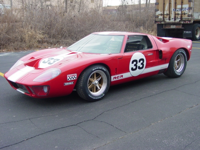

Well the car is finally here! I want to tell you all what my intentions are up front for the car. I am going to try to build the ultimate road race GT40. I will need a lot of advice from all of you along the way. This is going to be a very exciting road to go down. I will try to chronicle all the steps along the way. The car has most of the options Fran offers including the 6 point cage. I am using an all aluminum Ford/Robert Yates racing engine with Weber's and a ZF gear box. I hope to include pictures of the engine build along the way.

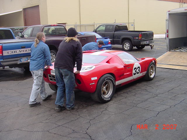

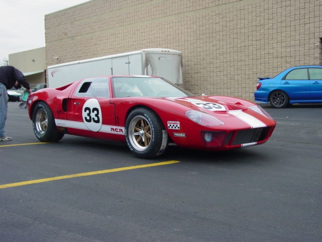

This is how the story begins. It is 4 a.m. and my dad and I leave for Detroit. The wind is gusting to 40 miles and hour and seems to be a cross wind from every direction! About the time we hit michigan, it starts to snow and almost immediatly there is an accident. We are stuck on the road for an hour. we finally make it to Fran's shop at 3:00. WOW, what a place! I was like a kid in a candy store. It was incredible! He has some really cool toys! That was my first face to face with Fran. After meeting him, I have all the faith in the world in RCR and their cars. When i went in the door, there was Sandy's car and just to the right was ole number 33. It was love at first sight!

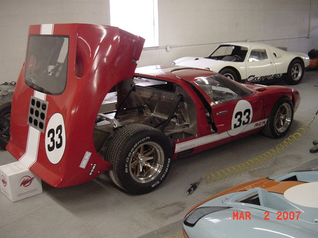

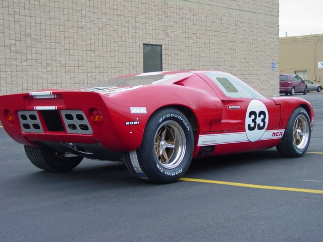

After a quick tour of his 3 warehouses full of cool toys, Fran and the guys pushed the car to the trailer.
Name:	GT passenger side.JPG

At 6a.m. my boys where up and ready to unload the new toy. I spent the rest of the weekend unpacking boxes, ordering parts and bench racing with my buddies! The journey has just begun.

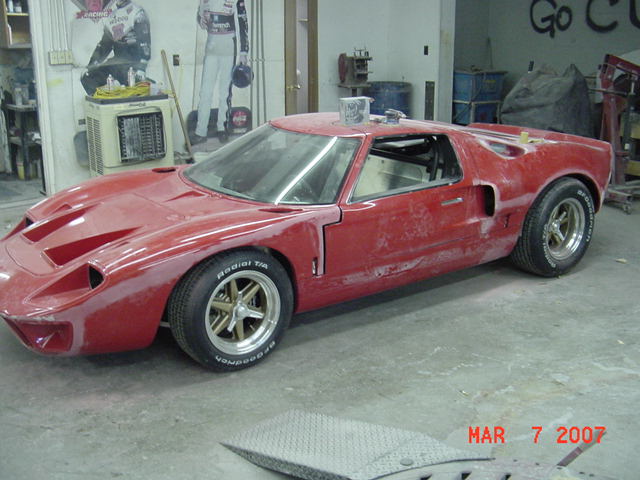

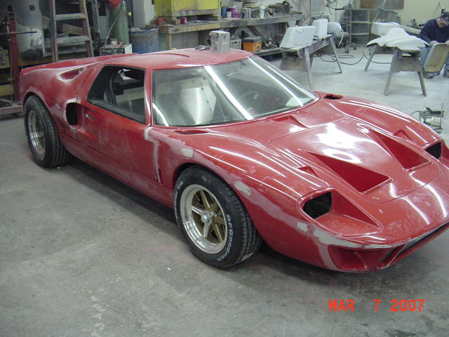

By Sunday night it was in the body shop. Fran and his team saved me a ton of time by fitting the panels, hanign the doors, cutting the holes and trimming all the plexiglass ahead of time. Here are the first shots of the body shop work. Ther will be many more to come.
ID:	18255   Click image for larger version

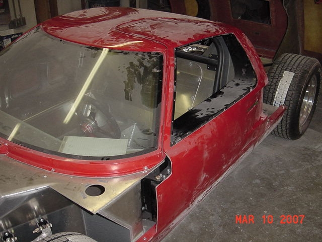

I have been working on the panel fitment today. I was able to ajust the doors within a tolerance that the body shop can finish off. You never know how it is going to go. I spent 4 hours working on one door and 10 minutes on the other! I have been able to adjust the doors to swing in a little high and allow the striker to pull it into postition. That way it will definately not hit the roof as it swings closed.

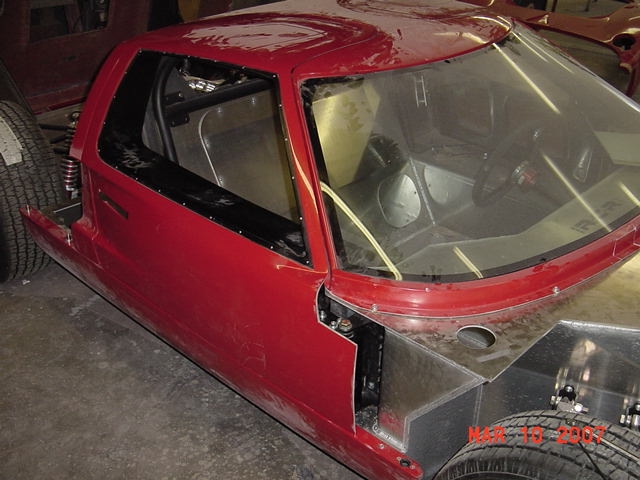

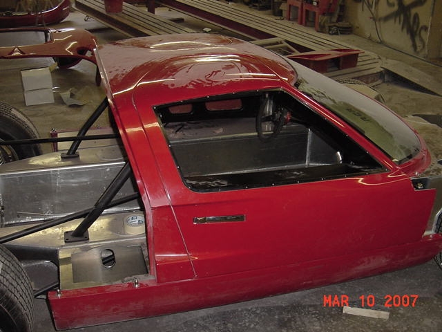

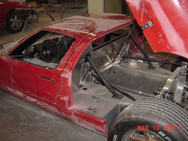

Here are a few pictures of how Fran's 6 point cage fits in the car. It is a great addition to any track car. It is definately visable but it is not in the way at all. The side bar is held in place buy a couple of push pins.

Dean,
Am I seeing things right? Did you notch out your chassis at the "battery" recess? Is that for your oil tank?
The cage looks great!

Dean - Did you already relocate the wiper arm boss to the left side? It looks like maybe it has been but the picture's aren't really clear there.
I'm also curious if the coolant tube tunnel is offset to the right a little thereby giving more room the the left-seated driver?

I did notch the battery tray for my dry sump tank. The Peterson tanks fits right in the hole with minimal trimming of the bonnet. That's why Fran cut the holes the way he did.
Randy, all RCR center tunnels are offset to the passenger side to give the driver a little extra room, regardless of which side the driver sits on. Fran was gracious enough to relocate my wiper arm for me. It was just a few cuts in the spider and front clip. The body shop will finish it off.
