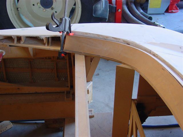

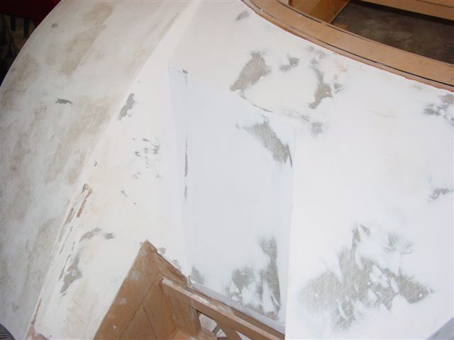

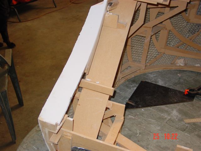

septum temporarily puttied into front guards to set up surface "flow" from one to the other
this will be cut free again and edges finished once I am happy with shape
yes there will be a l/h drive version of the kit as well, appropriate moulds etc will be made
If I have missed any questions bear with me and I will try to answer them, if I miss/ed yours please ask again

The stuff has abated and "90" work is now finally back on track, missed the marzipan smell of the putty
septum has been cut free again and currently working on front guards and will post some pics once there's something to see

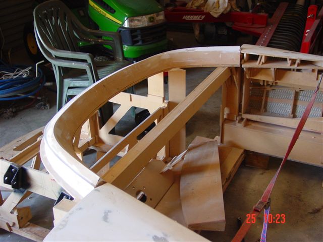

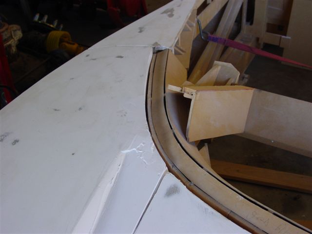

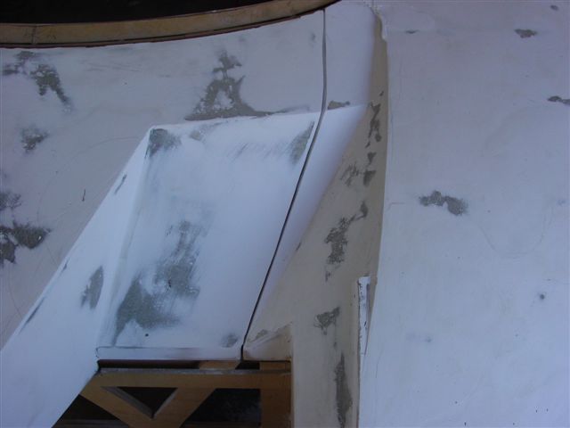

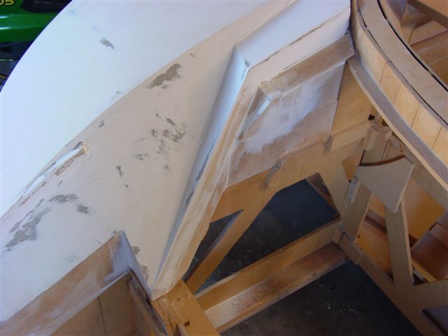

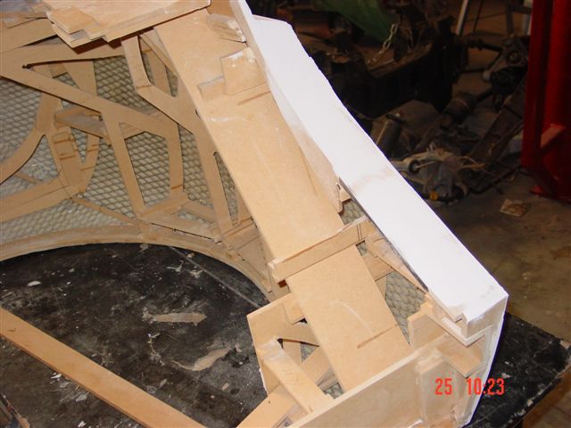

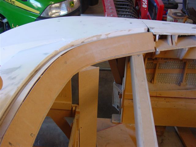

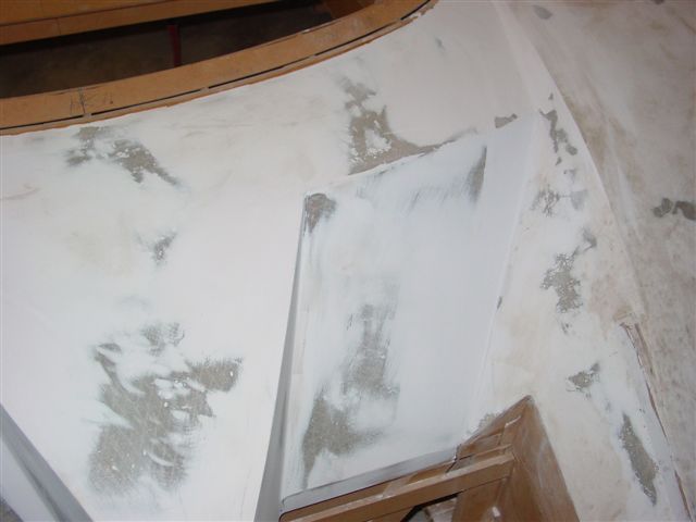

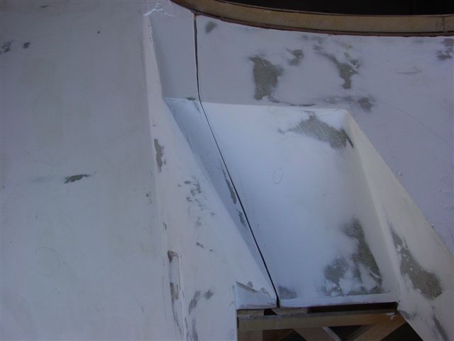

Windscreen support top face raised and reshaped and angle changed as it approaches rear to better match envisaged screen angle
This will give continuity from screen to doors
At front it is approx 25 deg from horizontal at rear/sides it is approx 45 deg.
Matching curves in rear top of guards starting to take shape still need to add return underneath for screwdown/attachment to windscreen support mounting plate
Currently adding a lip to inside of windscreen support so it can attach to aluminium plate.
Also need to add a step on inside face to support the dash panel
Joet
wiper wise I need to comply with swept area requirements for rego so most likely it will be 2 wipers
