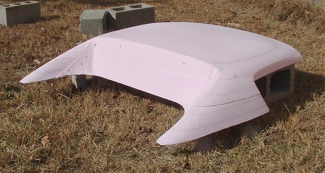

Richard if you need help with the 3d modeling I can get you in touch with some folks. If I were so far away I might even be able to carve your foam for you. I'm currently carving a full body, not a 40, but an new....well, semi-original design. I can't show photos of it but one the customer decides to go public then I'll be able to show some.
After doing this full carve, I kinda want to do one like Des is doing, just for the hands on feel of everything. What would be neat would be to use the mesh system to build enough bulk to machine with a cnc to final shape.
ps I remembered another job I had done. This is done in slices rather than blocks. Removable hardtop for f360

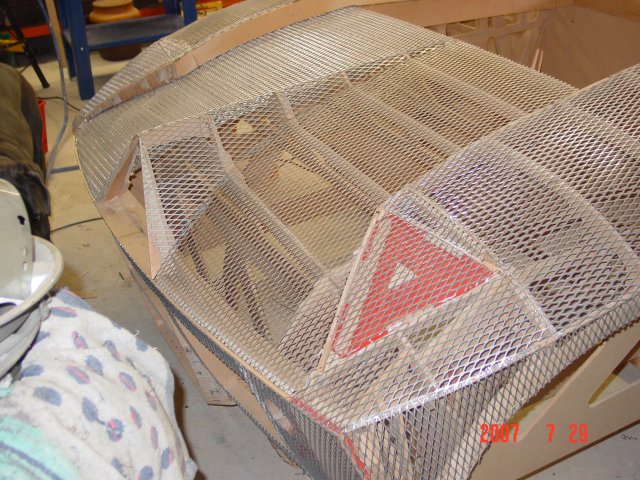

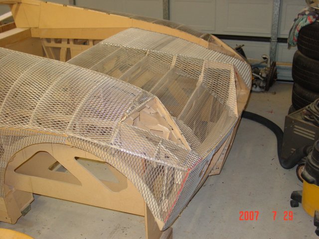

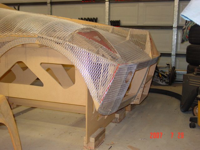

Some more progress finally
rear section fully meshed
Reversing light recesses in place
"Tail lights" meshed over to provide surface contour for real lights (yet another project)
and a pic with them removed
Trevor, I agree the foam is acccurate but it was not deemed suitable for how I am running. My 3D CAD skills are not the greatest either, I like being able to run my hands over it and sit in it full size.
Thanks for the kind words.
Des

Des so you will actually sculpt the cockpit during this process as well? Will you install the intended seats etc for that real feel before you final everything up. Your last comment is why I told Richard in my response to him is why I think I want to try one like this one day. At least I have the cnc machine for cutting whatever ribs and runners I need.
I appreciate you putting this up on the web like this. Not only is it interesting but it is quite educational as well.

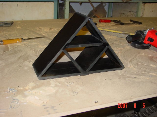

anyway some pics

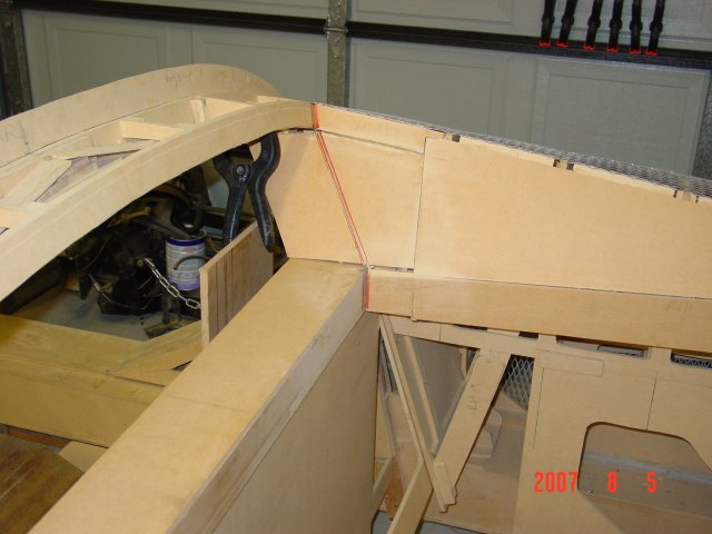

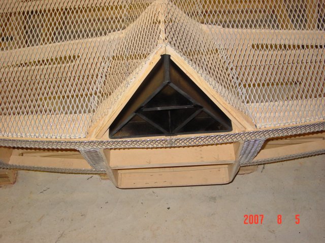

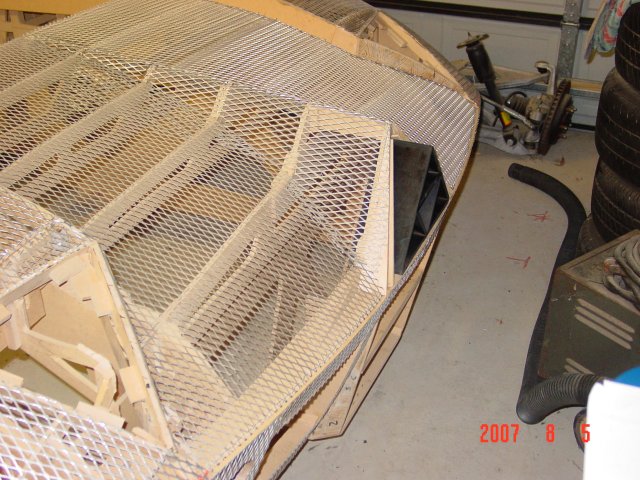

made a model of the exhaust "ceramic" insert and the opening in the rear deck has been roughed to accomodate it with clearance.
simplified the front face of the rear guards where they meet the window frame they now join on red line instead of the zig zag originally intended.
currently doing battle with fuel filler panel and arch
Des

exhaust "tip" looks great !
what did you build it from? it kinda looks like PVC

Raca
Nothing so "exotic" just MDF and a quick mist of black enamel so it stands out against the rest. The real item has proven challenging but is now in the mill and will be prototyped in due course.
