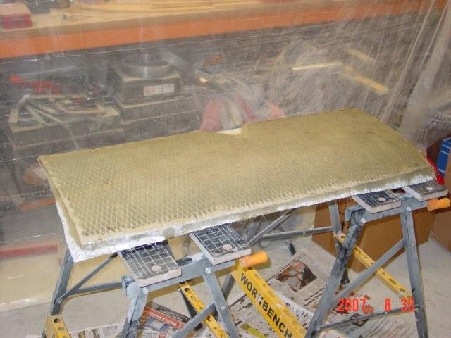

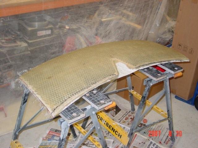

Re: GT90 from ground up
Sticky stuff under way
Did a test piece and then the bonnet today.
It uses a fair bit more resin than I expected, but understandable as it is wetting and flowing around mesh to a degree.
Resin is a much nicer product to work with than bog due to the longer working time to cure.
It was still too tacky to trim when I took the pics, should be well and truly cured by the time I get back.

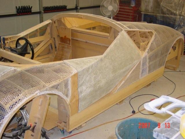

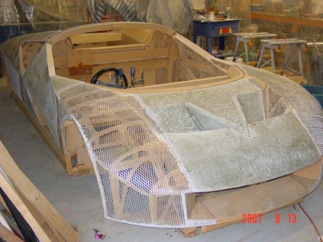

Bonnet cleaned up.
Skinned doors as well as septum and all cleaned up and rough sanded to get rid of jaggies.
Sections look and feel different now they have put on some shape and weight.
Decided I will cut in the lower front indicator lights before I skin the front guards.
rear guards next
Des

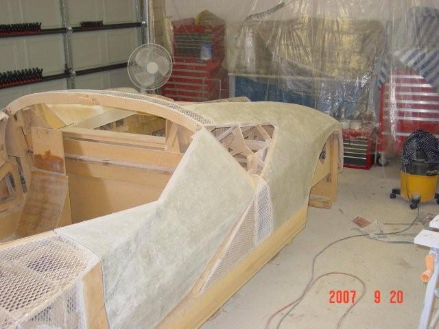

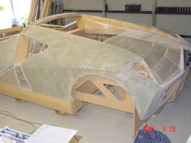

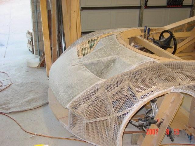

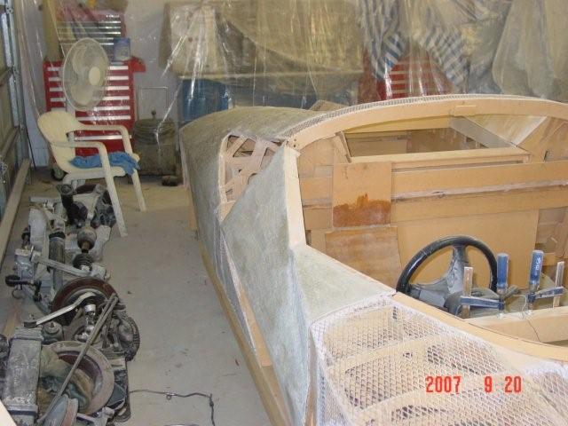

Some pics
Rear guards skinned and rough sanded.
Rear deck underway.
The "itchies" are not as bad as I expected.
Des

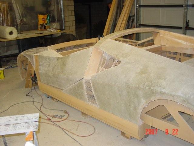

Troy
Lots of sample points, lots of patience.
6 weeks were invested in measurements and drawings before I cut any wood.

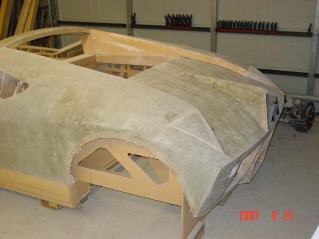

Some more pics
Rear deck and rear face skinned
tail lights and under door triangles done as well as top of main arch.
On to the front guards, sides of main arch will be skinned at same time to save mixing small quantities of resin.
Des

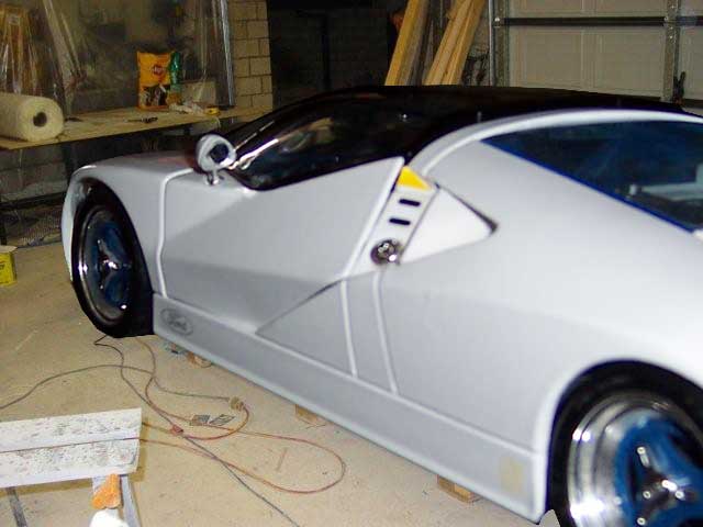

I can see it coming tgether!!
Looks great!
