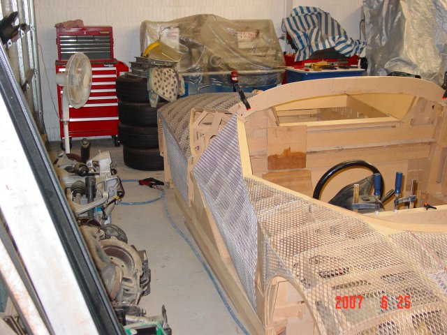

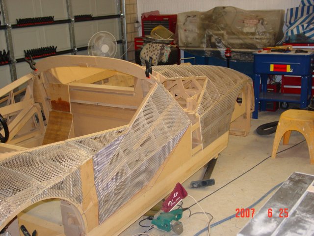

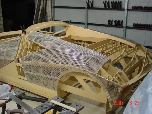

Got some time on the beast over the last couple of days.
Meshed on top of rear guards as far as tail lights and down sides around rear wheel arch.
Now we see if Murphy says I need to buy another sheet or not.....
Des

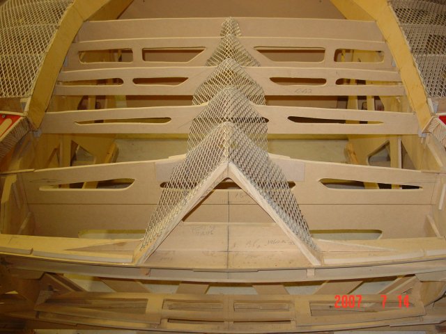

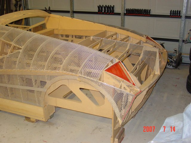

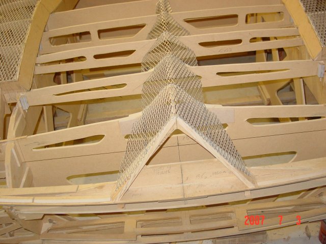

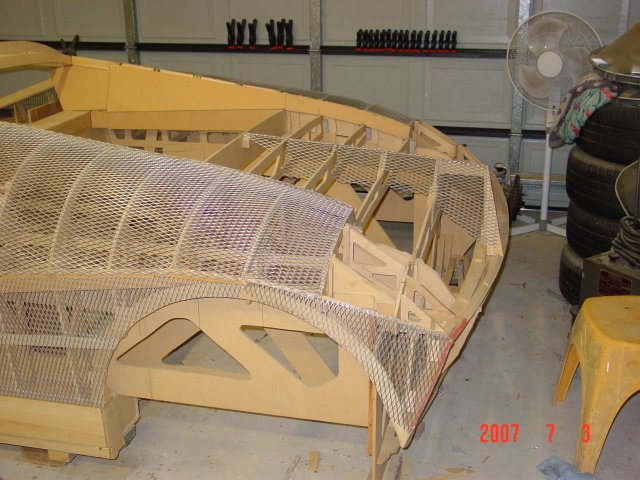

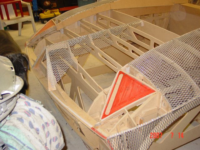

Finally some more pics
meshed "V" recut the stations under the guards to fit chassis and added "tail lights" in prep for meshing
extended slope on inner edge of guards to rear alongside tail lghts(roughed at this point)
meshing the valley/rear deck next
