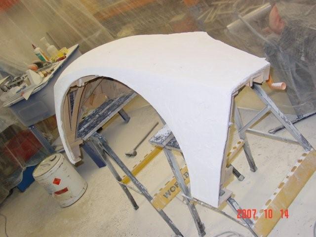

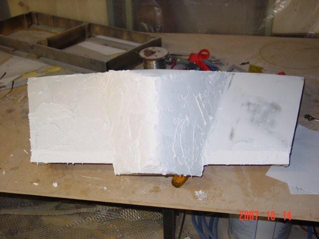

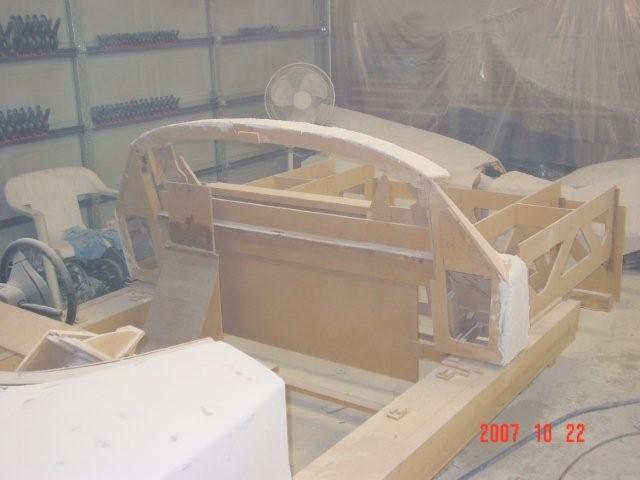

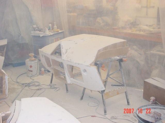

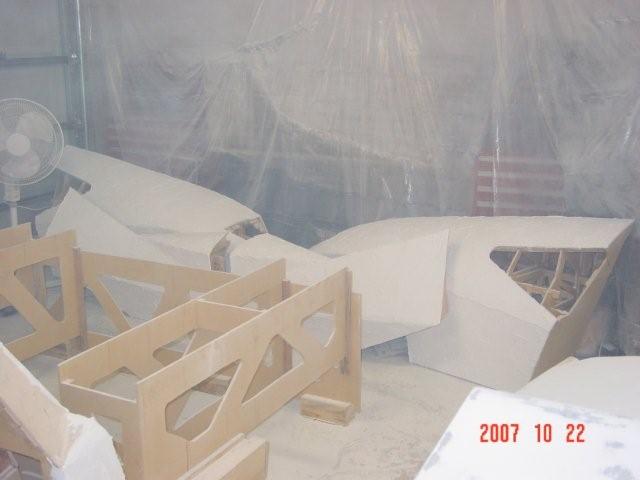

Some more progress pics, doors are coming along nicely. pics will follow in due course.
The stacking up to the right is my Opera browser it autoloads the attachments, so ignore the question.
Fantastic work, Des. Please tell me it was done with CNC and not a jigsaw!
I too would like to see as many build photos as you care to show us.
-Please tell me it was done with CNC and not a jigsaw
I could do that, but try a bandsaw, jigsaw and matching on a linisher.
-Where did you get your drawings
Hard work.....some smoke and mirrors, more hard work.
Anyway some more for you
Leaving rear and moving onto front end.

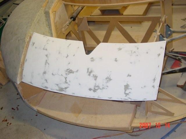

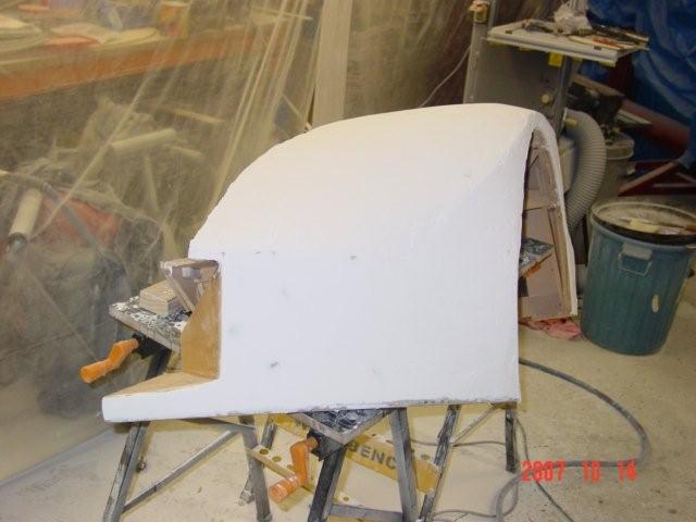

Starting on base of nose section, main air intake and stations (ribs) added for upper surface of guards, nostrils and bonnet (hood or radiator cover)
Door pillars and windsscreen front edge added as well
More to come.
