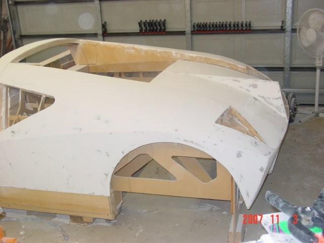

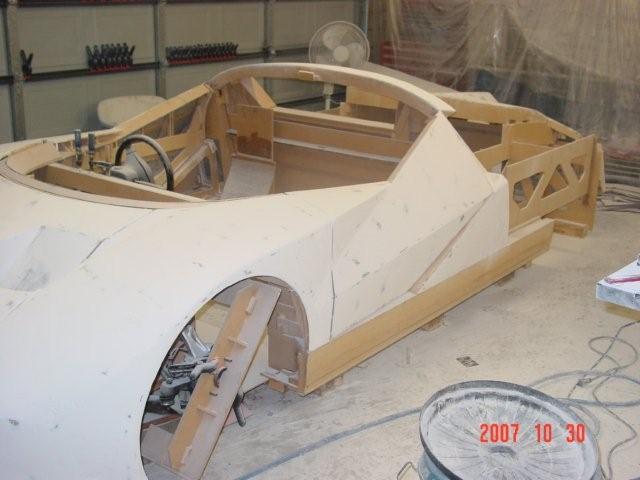

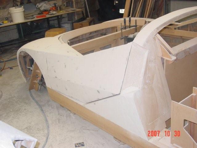

Some more pics
Doors, under door triangles and arch initial sanding done
rear guards under way
Des

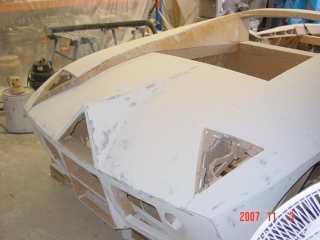

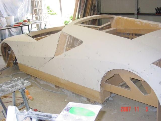

some pics
Rough sanding finished
Detail and panel matching work begins

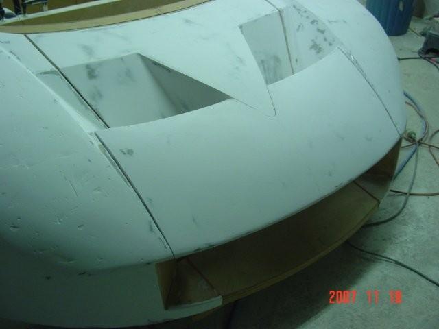

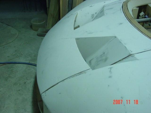

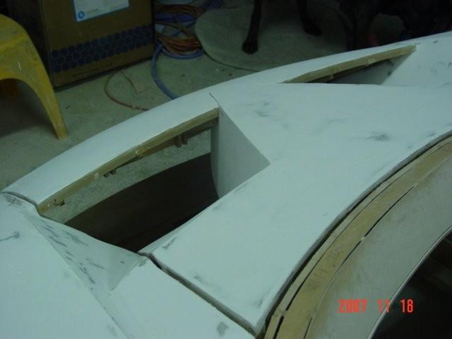

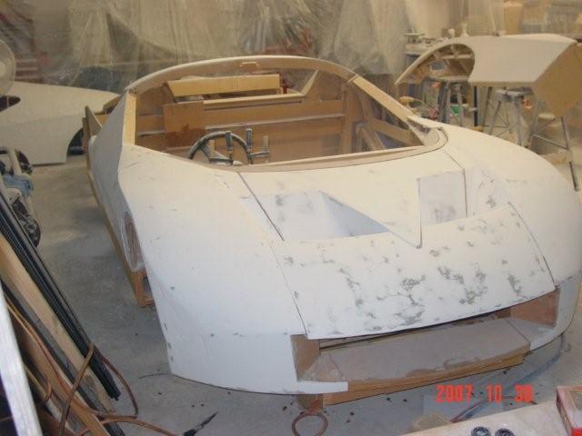

as requested this is what I am currently working on
adjusted the bonnet vertically to fit the guard contours and re puttied/sanded.
fixed "rebates" on guard where bonnet meets
adjusted the septum accordingly
all edges of bonnet are now straight
rear edge is now approx 20mm wide still needs a bit of putty work on top
guard edges need filling/sanding/straightening to match mating panels as does septum.
guards still need some contouring as well as obvious pot holes filled
Des
