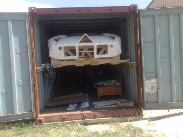

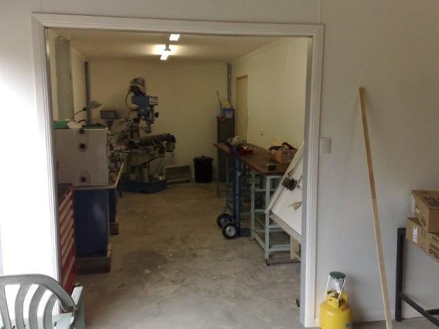

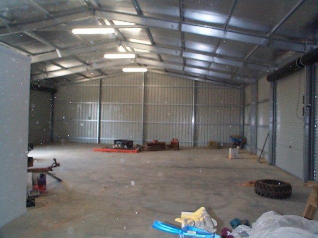

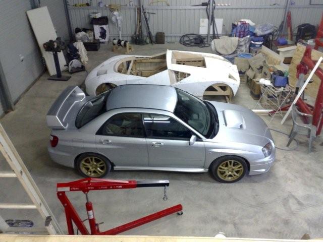

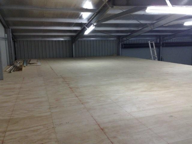

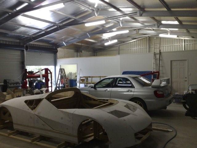

Some pics of the new place
empty as we got it
The plug in the container just before it was unloaded
I now have a sizable mezanine for storage.
The 90 is small compared to the MY03 Subaru.
the new "clean" workshop before the doors went on
still some mess but getting there
shed heater turns up this week, it was -2degC last night......
Des

Nice work space ...... looks like the ''shed'' could use some insulation to go along with that heater.

Great new work place Des! Looks like you have 3-4x as much space. The 90 looks so good too. Thanks for the update.

Des, I think the 90 may have shrunk when you see it next to the Subaru? . . .it didn't seem that much smaller. I bet she is getting a little chilly down that way at the moment!!

Des, looks amazing next to that beast of a Subaru. Really low down. It's so nice to see a size comparison to another car finally. Years of not really knowing how big the car would appear.

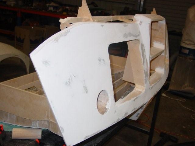

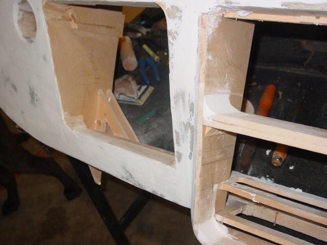

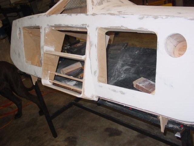

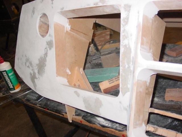

some pics of rear face of deck
corners of outer openings done in timber as for front air intake
inner ones done in straight putty as a trial, it's way faster than timber
seems to work fine, only drawback is I need to turn it upside down for the top ones
more to come as I finish this part off
fwiw the heater works a treat

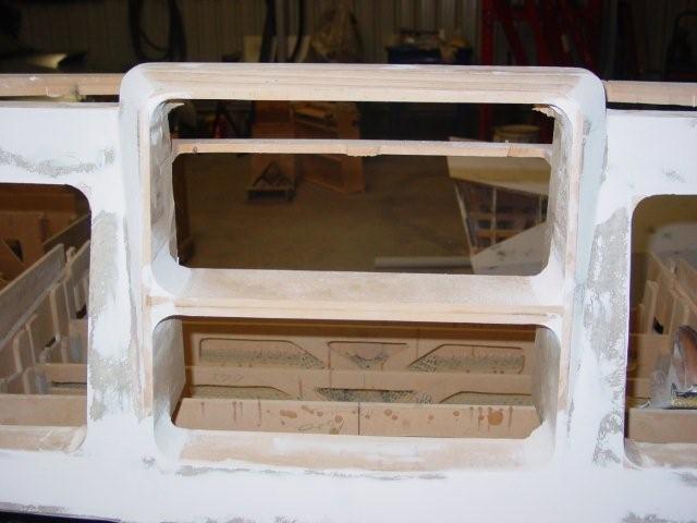

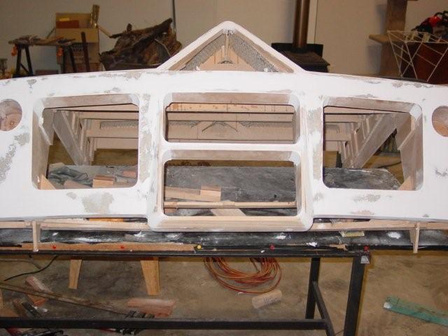

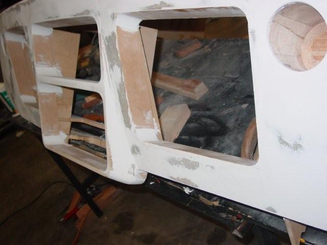

Upside down rear deck
Working on edges of openings and bottom edge as well as actual rear face itself
Next step should be infills of openings and checking tapers etc for mould release.
gav
thanks for kind words
still too early for any accuracy with pricing
glass and lights are such an unknown factor
Des

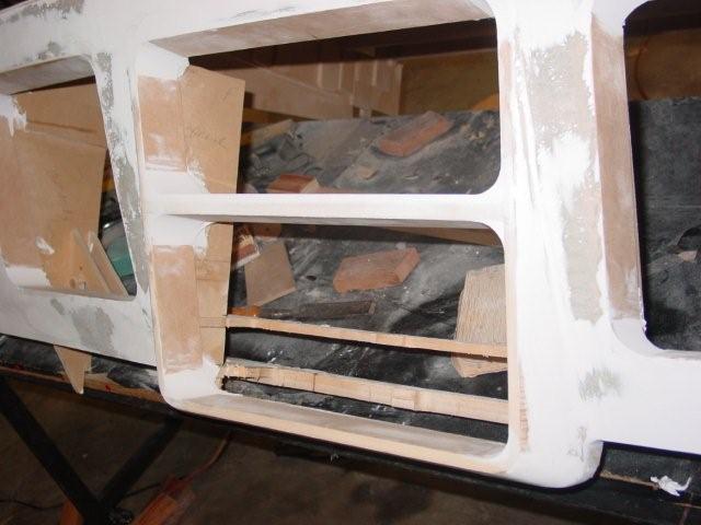

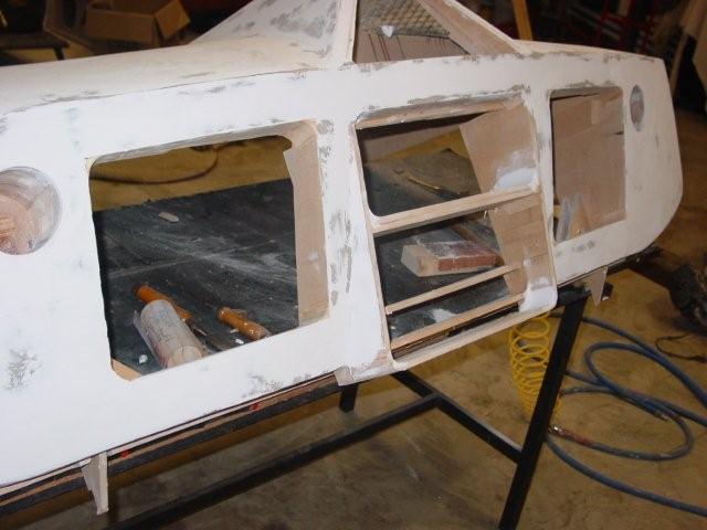

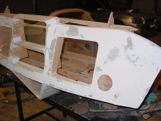

wasn't happy with the tapers inside the openings, added to them and redid all internal corners as a result
tidied up rear face
infills next
Des
