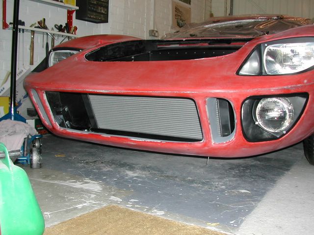

Getting a little tired of the body work and so are the neighbours so I decided to fit the radiator. It's all progress..
Name:	Radiator installed 2 [640x480].JPG
