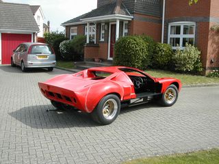

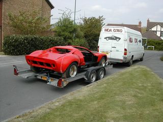

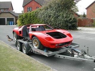

Today I took delivery of my MDA. This is MDA's latest MK2 chassis (That is Mk2 as in 2nd generation of chassis not a distinction between GT40 Mk1 and Mk2)
I opted for the Mk1 body with Gulf flares in red gelcoat.
The chassis is fully panelled and black powder coated.

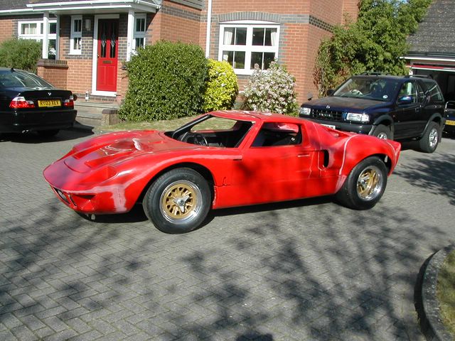

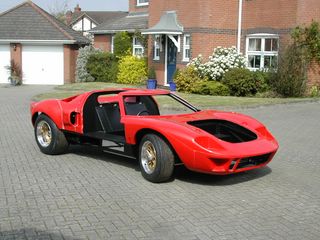

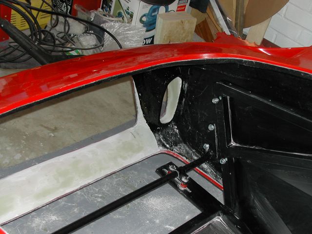

Started Sanding and filling. Placed all the panels loosely on the body to check initial alignment. Doors had to be trimmed on the back edge about 1/4" to fit. Still enough material left in case I need it when I finally gap the body. Think this process will take a few months !

The wheels are reproduction Halibrands from 'Image' wheels. I especially liked the champagne style with sunken sections.They are 3 piece wheels but with the bolt pattern hidden on the inside of the wheel. Looks as original as I could find and MDA recommended them.
They are 15" diameter, 8.5" fronts and 12" rears, offset to fill the arches. I asked MDA to do this prior to delivery so I can't take any credit there.
Tyres are Avons 215/60VR fronts and 295/50VR Rears.

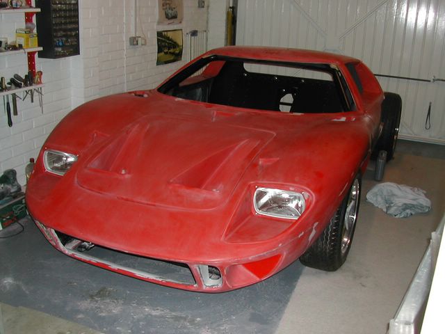

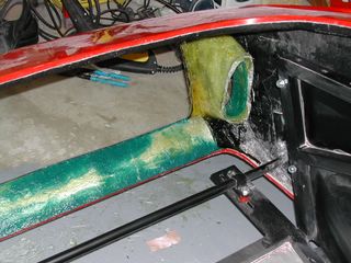

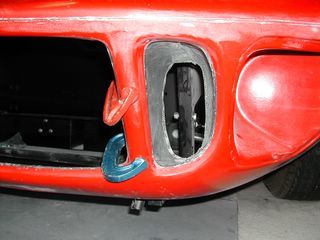

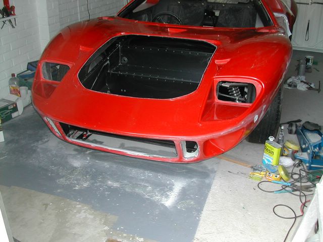

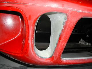

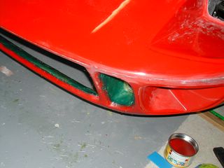

After studying some archive photos I decided to add some detail to the front intake. It seems that on some cars, the front brake ducts finish further inside the car. With the books I had to hand it seemed to me that most of the cars that seemed to show this were the later gulf cars, which suits me fine.
I also extended the bottom of the main intake back inside the car. I'd seen an original a couple of weeks ago at Brands Hatch with this feature and it made me think. It seems to provide more regidity to that section as well as more surface for a painted finish. I like to see the stripes dissapear into the car in this area.
Comments welcome
ID:	21036  Click image for larger version
Name:	Finished Duct1 [320x200].JPG
ID:	21037  Click image for larger version
Name:	Finished intake [640x480].JPG

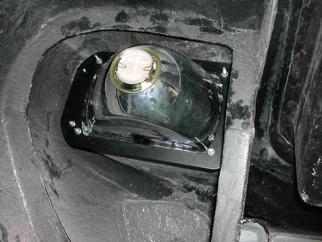

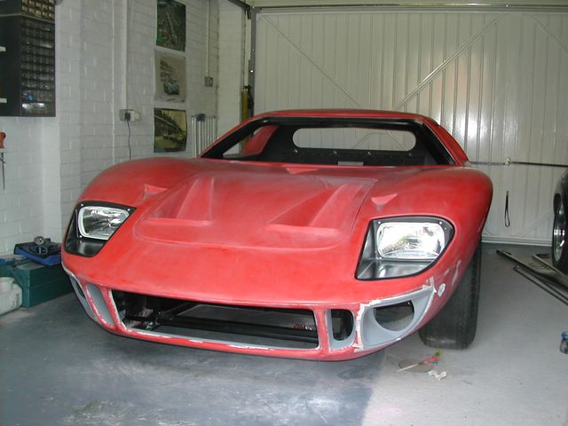

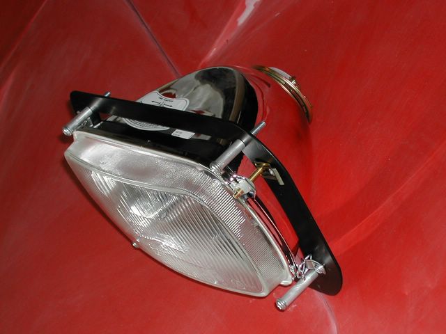

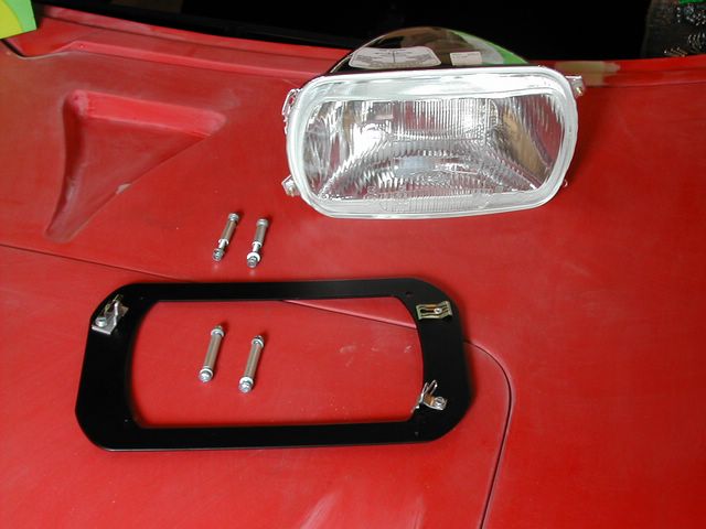

Headlights Fittted. She has Eyes !

Nice work. I like what you've done with the ducts, it gives them a whole different appearance.
