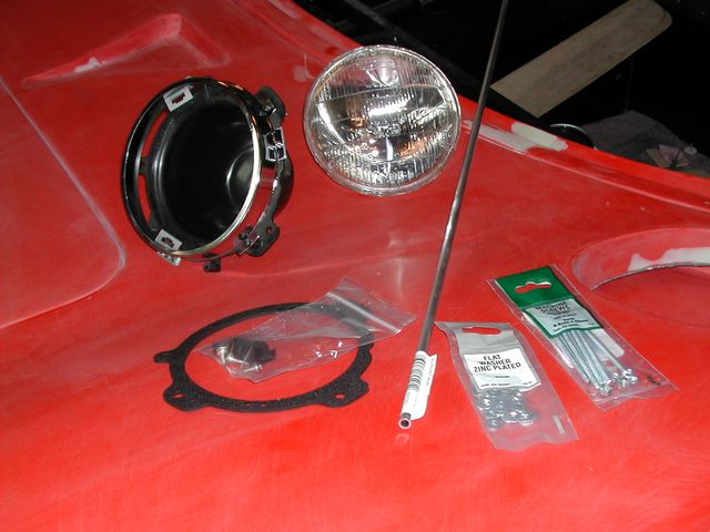

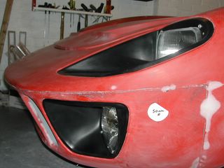

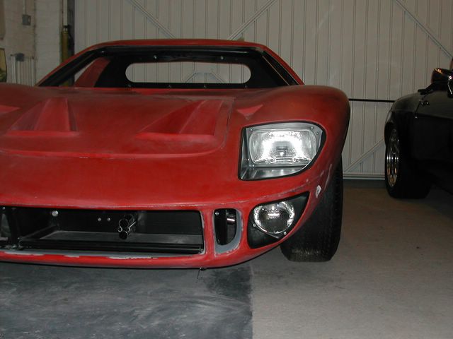

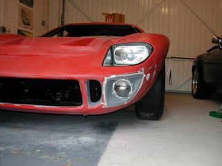

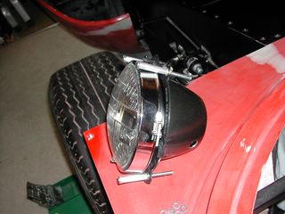

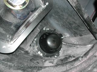

O.K Here are a few pics of my Spot Lamps. They are mounted from the inside and are fully adjustable if required.
Name:	Spot Lamp assembly [640x480].JPG
ID:	22963  Click image for larger version
Name:	Spot Lamp assembled1 [320x200].JPG
ID:	22964  Click image for larger version
Name:	Spot Lamp in position [320x200].JPG
ID:	22965  Click image for larger version
Name:	Spot lamp rear in position [320x200].JPG
ID:	22966  Click image for larger version
Name:	Finished Spot lamp2 [320x200].JPG
Name:	Finished Spot lamp [640x480].JPG

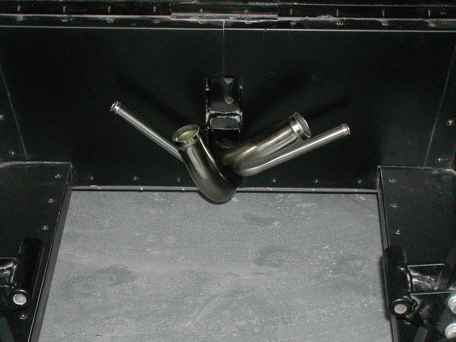

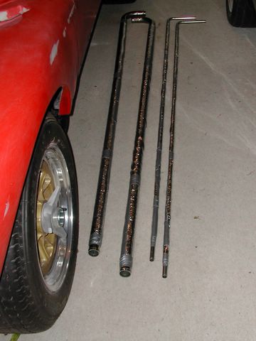

I've installed the main cooling pipes. I lagged the main pipes in an attempt to keep heat away from the interior of the car. The photo shows all the pipes lagged but I had to remove the lagging from the smaller heater pipes as they wouldn't fit in the hole otherwise.
Don't forget to run lines for the A/C - it is hot as hell riding in the car with the cooling tubes running down the center panel! I didn't have A/C tubes in mine and caught hell pulling the lines through the side panels near the gas tanks!

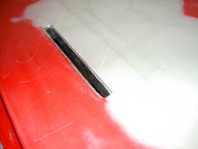

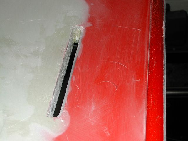

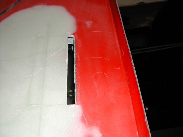

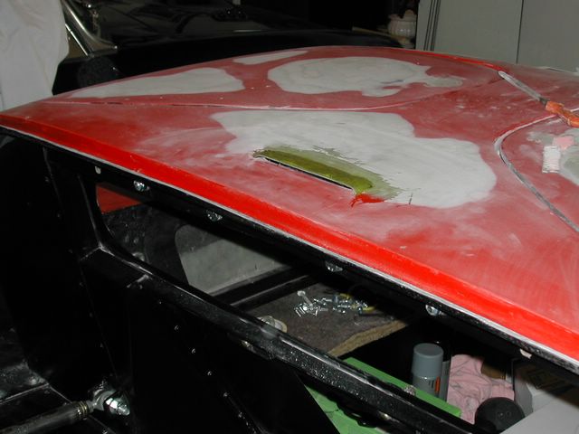

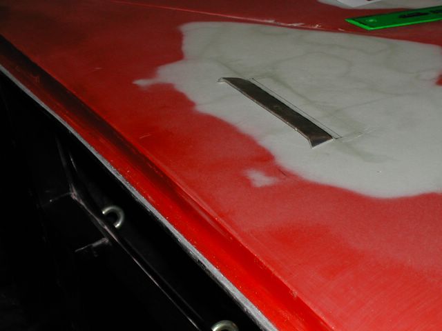

Next mini project is a roof vent in the style of the Gulf Cars. I started by making the vent cover in aluminium, then cut out the holes in the body. I made a plenum from aluminium to go between the two skins of the spider, then glassed it in along with the vent cover. It's not finished yet but i'm pleased with progress so far. I intend to make another plenum for inside the car with a water trap and drain. I'll post pics when it's done.
Name:	DSCN2192 [640x480].JPG
ID:	23036  Click image for larger version
Name:	DSCN2196 [640x480].JPG
ID:	23037  Click image for larger version
Name:	DSCN2197 [640x480].JPG
ID:	23038  Click image for larger version
Name:	DSCN2198 [640x480].JPG
ID:	23039  Click image for larger version
Name:	DSCN2199 [640x480].JPG

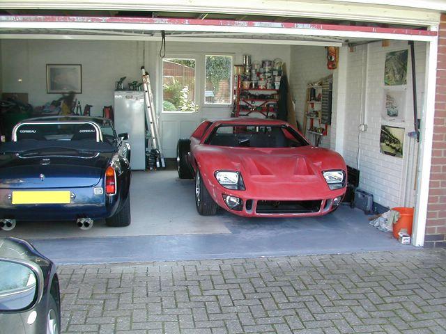

Just coudn't resist opening the garage door and taking a pic of the car. First Sunny day in a long time.

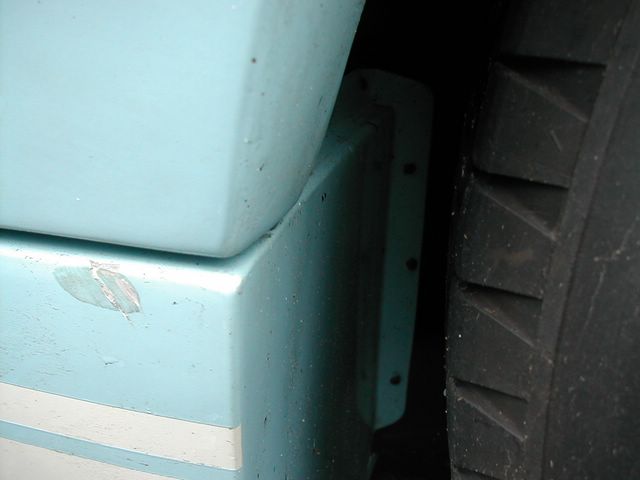

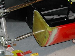

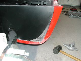

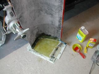

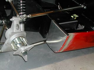

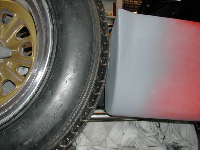

With the roof vent finished, at least on the outer bodywork, I moved to the Sills. When I came to initially align them I wasn't totally happy with the curvature going back under the car so I didn't follow exactly the line up to the pre-cut panels. The front was o.k but the rear had a different radius. I decided rather than trimming the sill and making it fit, I would go with the curvature that seemed correct to me and make a new rear panel to cover the gap.
I saw that on some original cars the sill did have this rear cover extending back into the car. I've attached a photo I took at Brands Hatch some months ago showing this feature.
So here goes....

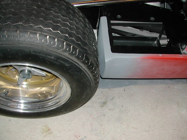

Name:	Original Car [640x480].JPG
Martin Potts is offline
Old 09-01-07, 03:25 PM   #34 (permalink)
Martin Potts's Avatar
Martin Potts
Join Date: Jan 2007
Location: Hants, U.K
GT40: MDA Mk1
Posts: 185
Rep Power: 3 Martin Potts is a glorious beacon of light
Re: MDA Mk1 with Gulf Arches - Martin P

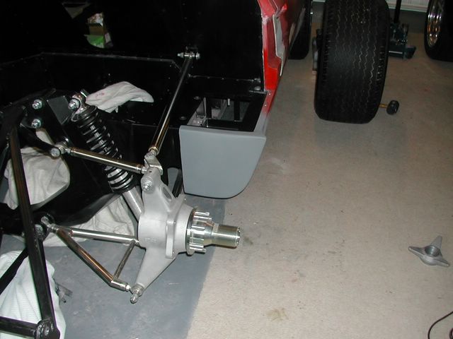

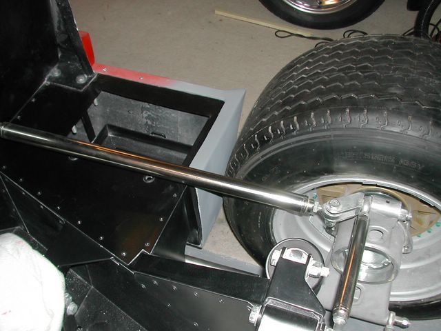

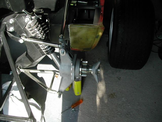

Finished Sill Panel. The other side to do now. This one took ages so no updates for a while.
Name:	DSCN2230 [640x480].JPG
ID:	23258  Click image for larger version

what is that blue car near the geetee in your garage?
If you do the front of the sills like you did the rear, very nice by the way, make sure you don't loose any clearance for the tire being turned. Because the rears don't do this they will be fine but if I did that to my front I wouldn't have been able to turn the wheels. The tires would have rubbed on your "cap" at the front end of the sill.
I would recomend you do the same "cap" on the fronts but with a recessed "cap" instead of a flat one.
I also wish I had thought of that. Very nice finish for the ends of the sills instead of a flat piece of sheet metal.
I would cover the "cap" with leading edge tape to prevent rock dammage when you get her painted.

An MGB with a V8 perhaps?
