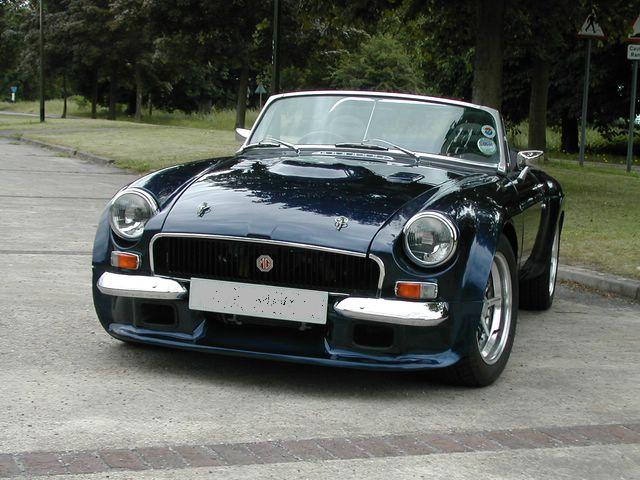

what is that blue car near the geetee in your garage?
An MGB with a V8 perhaps?

Howard, Thanks for the tips, I only intend to do the rears like this at present.
Paulo and Kieth, it is indeed an MGB with a V8. It was my first attempt at a restoration come customised car. It's not at all standard and I'm sure the purists hate it. I however love it.
Cheers Martin
