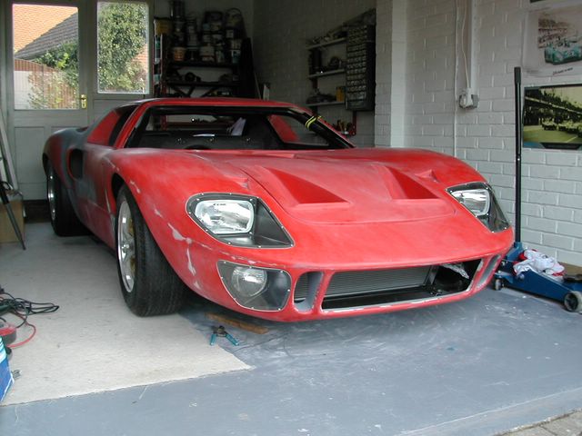

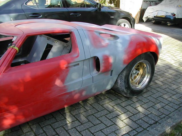

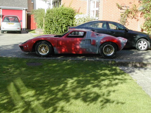

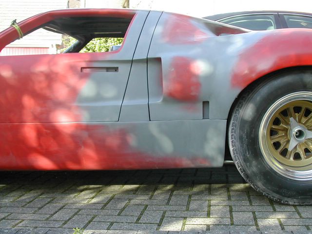

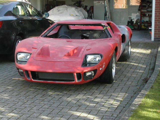

After much admustment, sanding, filling, grinding, shaping and more sanding, i'm finally happy with the fit of the rear body and i've gapped the passenger side from front to back. The drivers side is still to do but it shouldn't take me as long as it's quite close already. I've also dropped the car on the springs to see what it will look like when the weight is on. It still has about 1.5cm left to drop before it's right, but it's close enough for now. Hope you enjoy the pics,
Cheers,
Martin

Schweeeeet!! That's going to be wicked when done!

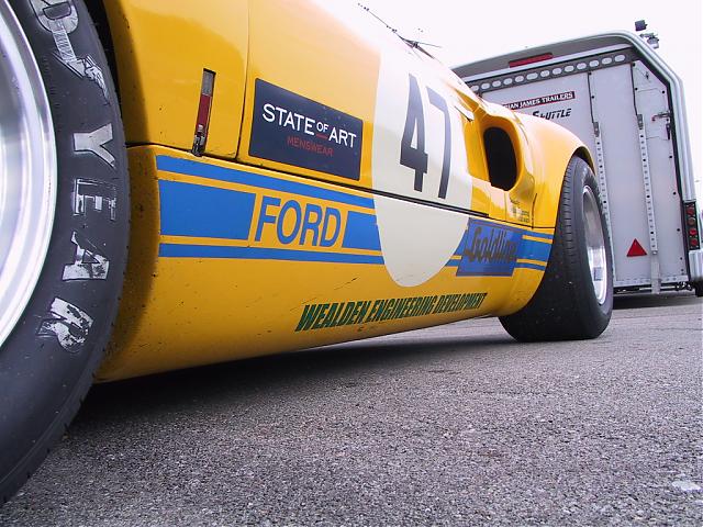

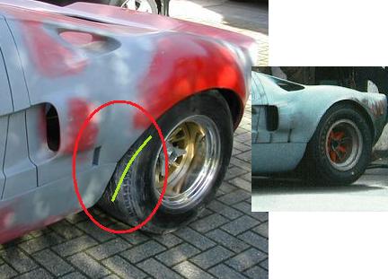

Martin, you might also want to consider flairing out the sills to get the lower profile right, Frank

The sills don't seem to flare so much on 1075. (the transition between the siil and arch is not a smooth curve, and it seems that martin has replicated this) But then again we don't know what Martin is replicating (or if he's replicating anything at all...) so i could be talking rubbish. Are you replicating an original Martin? or is it going to be your own design?

Yes, I think Joe is correct, there is no "right" in any of these cars, they were all individual and different, just an alternative then. Frank

Funnily enough, my eye was drawn to this area as well, as not being quite as flowing as other areas of the car. As Joe pointed out 1075 wasn't flowing in that area either. hmmmm. I'll sleep on it.

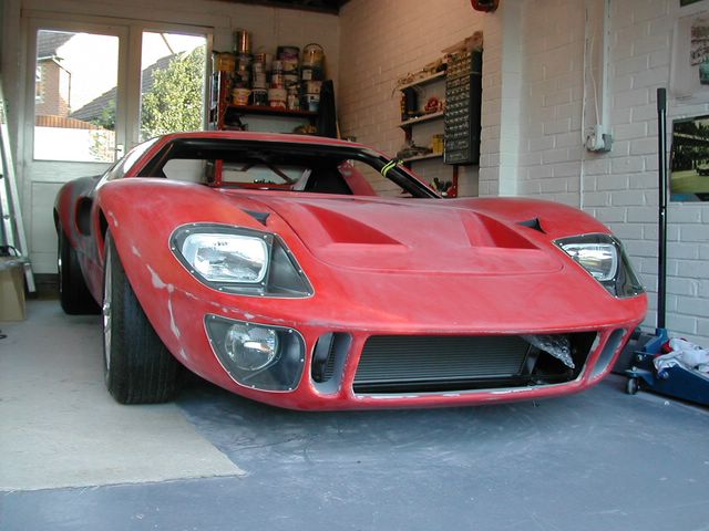

Good weather in the U.K this weekend so i decided to fit my light covers. They are Repsol perspex and don't like being manipulated in cold conditions. Even with my attention to spacing and using a heat gun to make sure they were plyable, I still managed to crack the passenger side headlight cover.. Bugger ! It was a bad fit to start with so I'll try again with a new one soon I hope.
The other covers fitted a treat and I found trimming and drilling them quite easy. It was only the top bend that posed some questions.
The bodywork on the drivers side is coming on nicely. You can just see it in the backround. Gaps look good, just a bit of finishing work.
I've been looking at photos of 1075 and I'm pretty happy with the sill to rear arch lines. I like Franks' car very much, it looks very aggressive, but for now I'm going to stick with what I've got as I see it's a pretty close replication of the original.

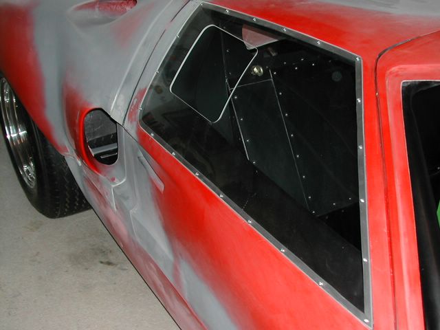

Pressing on, Drivers side passenger window fitted with Matt Black inner door recess.
