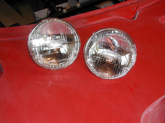

I was wondering where you got the buckets for the spot lamps, and if they are adjustable after being mounted?

Hi Phil,
The spot lamps I've chosen are 5 3/4" headlamp units from a Triumph Vittesse. The old Triumph herald has square headlamps but the Vitesse (2.0 litre sportier version) came with 2 round lights. Normally the headlamps mount on the outside with a mounting ring and a chrome trim to secure it to the bowl which is on the inside. I intend to do away with the chrome trim and mount the lamp to the bowl all from the inside using spacers so that the lamp will just appear through the round cut out.
I will post pics once I'm done with it.
Lamps and bowls I ordered from Rimmer brothers in the U.K.
Parts Spares & Accessories for Triumph MG Rover Land Rover Discovery Freelander Defender Range Rover & Rover SD1
Here's a pic of the lamps.
Cheers Martin
