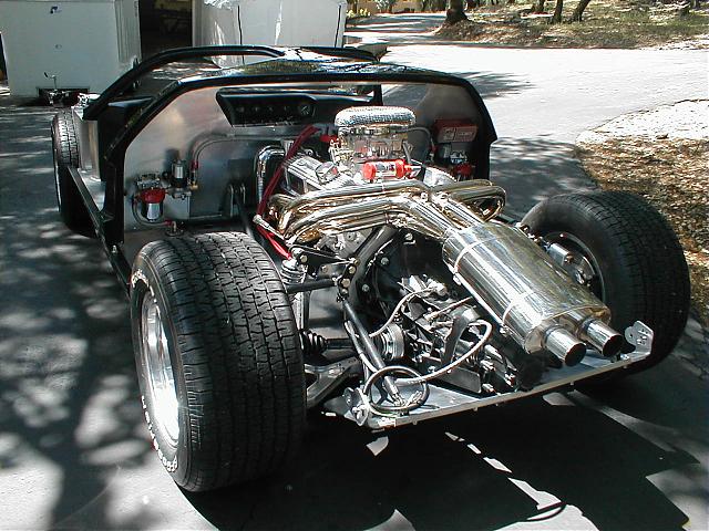

After getting my car on 11-21-2006 I took it for the first shake down run. WOW! My first impression was that it felt like a go kart with a V-8. Although the engine is not broken in yet the car really feels good on the road. I am kinda a semi authority on go karts as it has been my hobby from the time I was 10 years old. I would like to thak everyone that has posted their builds on the forum and of course Fran for such a high quality product! Oh by the way, my neighbors love me More pictures to follow....

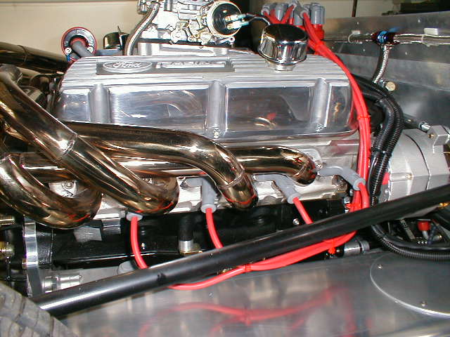

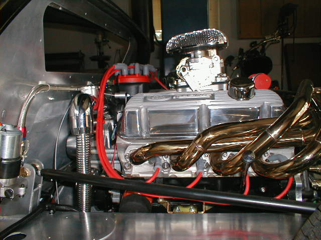

Re: 1st RCR Go-Kart
Looking good. What did you do about the bump for the water pump pulley?
Bill D is offline
Old 05-15-07, 12:33 PM   #13 (permalink)
Bill Pinzini's Avatar
Bill Pinzini
Join Date: Jul 2006
Location: Cameron Park Ca.
GT40: RCR work in progress
Posts: 53
Re: 1st RCR Go-Kart
Thanks Bill,I have about 1/2" clearance now w/ no bump.
Bill Pinzini is offline
Old 05-15-07, 12:45 PM   #14 (permalink)
Bill D's Avatar
Bill D
I Have No Life
Location: Earth
Posts: 2,515
Re: 1st RCR Go-Kart
How?????
Bill D is offline
Old 05-15-07, 12:56 PM   #15 (permalink)
Bill Pinzini
Join Date: Jul 2006
Posts: 53
Re: 1st RCR Go-Kart
Bill, I used a Ford racing short water pump. Since Audi output shafts sit low on transaxle,the engine sits back further than a ZF.

Since I'm using a G50 trans - I'm wondering where my engine will be located in reference to the ZF and Audi? I understood that the Audi trans made it necessary to mount the engine 1.5" higher in the chassis. Given the angle of the bulkhead, that would move the water pump pulley closer to the bulkhead.

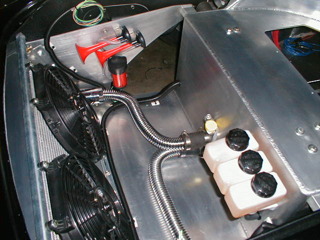

Re: 1st RCR Go-Kart
looks incredible in black!!

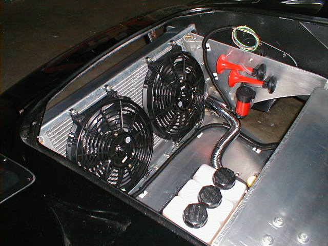

what do you have mounted above your coolant tubes in the front? i spy a little yellow cap.
no0one is offline
Old 05-15-07, 08:03 PM   #19 (permalink)
Bill Pinzini
Join Date: Jul 2006
Posts: 53
Re: 1st RCR Go-Kart
Thanks Mark, That is the lines for the AC system, I am working on it as we speak.

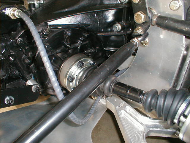

Re: 1st RCR Go-Kart

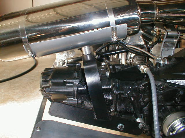

Bill, could you post a photo looking straight down at your half shafts. I am fitting the engine and trans right now and I am curious how far forward you have mounted yours. It would also be helpful to know how long the spacers you used to mount the trans adaptor to the frame are.
