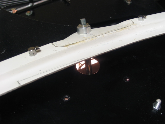

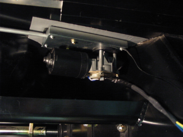

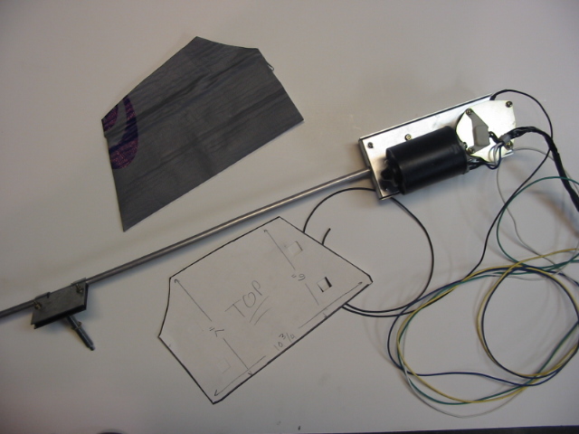

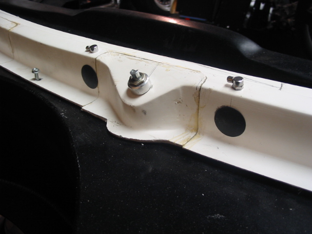

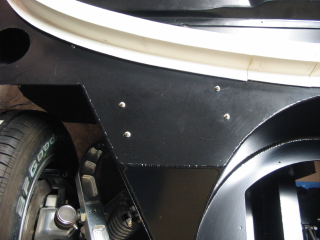

Windshield Wiper
The wiper motor supplied with our RCR was a “It’s A Snap” brand. Can’t say I ever heard of that particular manufacturer before, but it is well suited to the GT. Two tips for a successful installation: (1) Lots of grease and (2) A short and direct connection between the motor assembly and the wiper cowl mount.
The cowl mount shaft is just long enough to make a clean, neat installation. After drilling a guide hole in the spider, we continued drilling so we had a corresponding guide hole on the chassis below. The spider was drilled with a 3/8” bit to accommodate the cowl mount shaft. We then drilled a 1 ¼” hole in the chassis to clear the shaft mechanism with plenty of room to move it around for future adjustment. The shaft was long enough so that it came to rest fully below the chassis with a quarter inch to spare.
Finding a location for the motor was easy. Locating the motor forward of the evaporator on the passenger side, secured to the top surface of the chassis, provided a direct, short route for the connecting tube. The four mounting holes were elongated slightly to give some lateral movement for adjustment purposes when the spider is secured in its final position. A double thickness of sound insulation material was placed between the motor and the chassis. (We made our usual pattern before cutting the insulation material, shown in the picture below.) The mounting bracket that came with the wiper kit proved unnecessary.
The aluminum tube was carefully cut to length and the ends flared making a nice, tight fit on both ends. The excess cable was cut off, leaving a couple of inches sticking out on the opposite side of the wiper shaft mechanism. A short section of aluminum tube to protect the free end was added with the necessary flare to keep it in place..
Grease, grease and more grease. The cable was thoroughly greased. The slide guide mechanism was also thoroughly greased.
The final step was to test run the unit to make sure the sweep was appropriate. We removed and replaced the unit a couple of times before finding the right hole on the motor assembly for getting an appropriate arc.
Next we cut a piece of aluminum and expoxied it on the back side of the clip to give a bit more strength to the wiper shaft mechanism. We also drilled the hole for the windshield washer sprayers, adding a 7/8” access hole to the front of the clip for access to the bottom side of the nozzle so that the connecting hose could be added later. A black plastic plug covers these holes.
This part of the project went together well.
