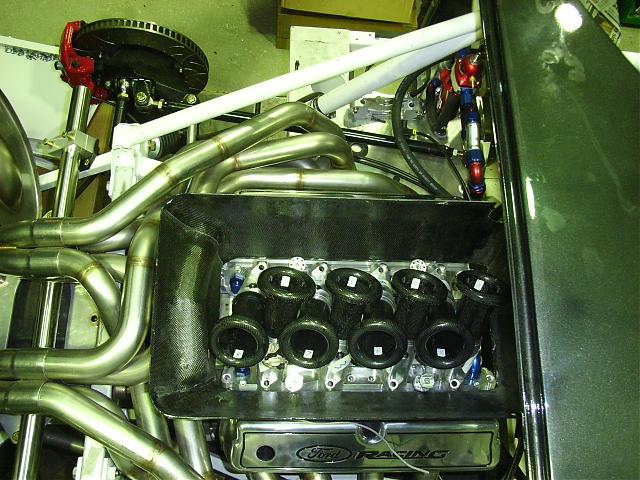

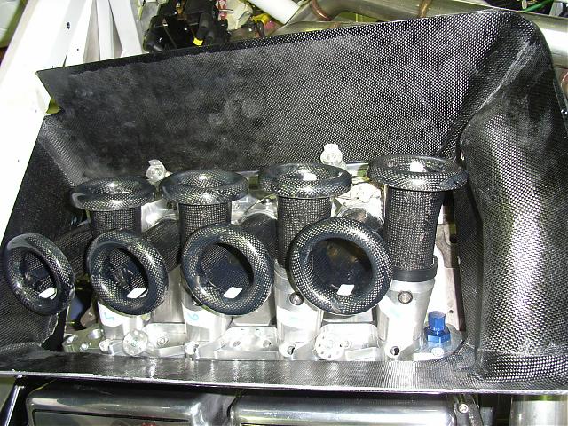

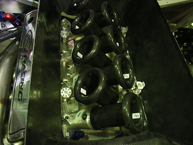

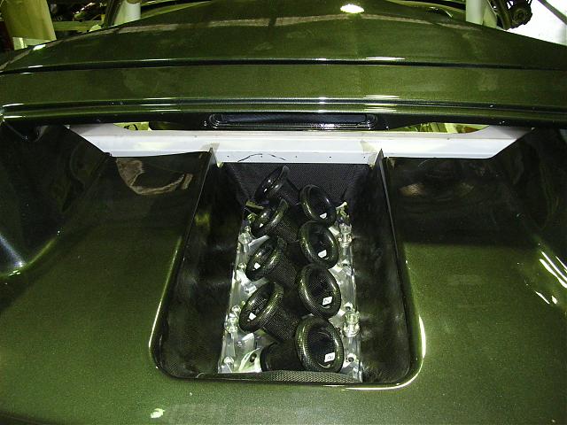

After a long and tortuous process we have finally resolved the intake trumpets, for anyone who is considering a cross over intake system with 52mm dia butterflys........ dont'..... it does'nt fit !
Iain

Oooh, jealous! Very nice...still happy with my DC&O setup, but carbon bling and the crossover look is that much better. Is that a slide throttle setup, or butterflys?
I've got the same rocker covers on order (along with the rest of the motor parts from the states - if they ever get here...), but in black with red script to match my colour scheme.
Keep the updates coming please!

I have a DC & O setup on the Cobra, we managed to squeeze some fairly serious horse power out of it and I would not hesitate to recomend it especially for road use. This system uses a butterfly set up but on reflection we should have gone with the slide system and stayed with oval all the way thru.....you live and learn !

Iain
Did Terry do the billet work on the manifold or did you buy it from someone.
Very very nice.
Jim

No Terry did not do the intake manifold, but I wish he did ! It would have taken a significant amount of design time from Terry as he would have been starting from scratch, but I just know the result would have been better, we have had a series of problems to resolve that were just not thought through with this supplier. It is not my intention to name him as he is well intentioned but well the experience is one I would rather forget

I can see the linkages must be on the inside off the valley that will be interesting if that is the case.
Still a lot of work and a huge undertaking.

i dont think the linkage is on in the first photo, can be seen in the second last one though. on the outside.

If you are looking at the round disks with holes in them I think they maybe for mounting the fuel rails as they are in the same plane as the injectors.
The throttle shafts look awfully short on the outside of the body.
Iain may clarify.

The throttle linkages run on the inside and the bell crank will sit outside the air box back towards the collectors.
The butterflys are 52mm which is what caused a fair few problems with the cross over system
