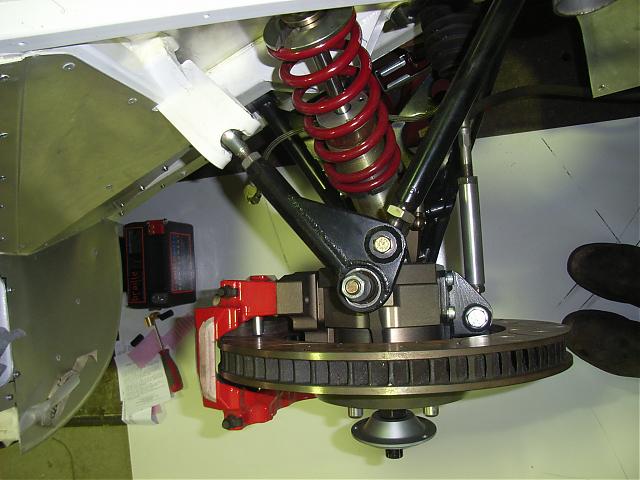

The plan was to engineer the car from day one to try and avoid all the issues that I had previously encountered with the Cobra.
In no particular order we have tried to:-
1.Create the strongest, safest, stiffest chassis that is possible within the constraints of the rule book

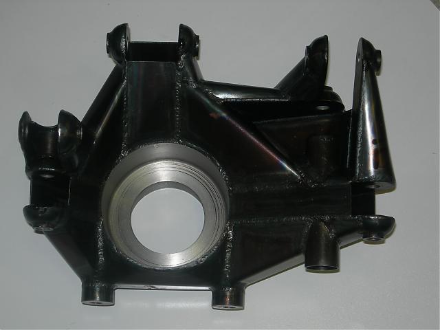

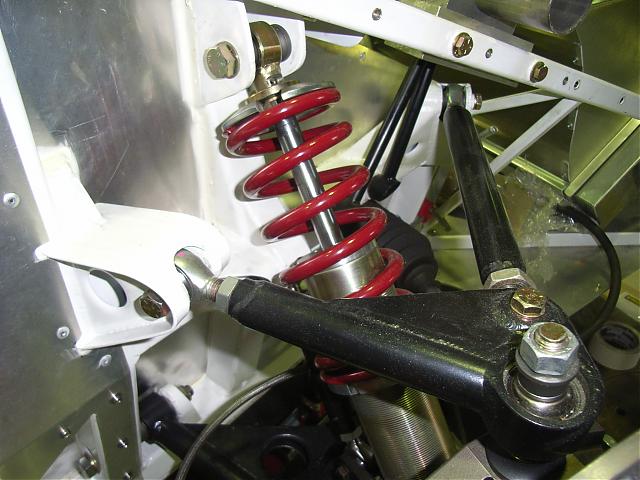

2. Create the strongest, safest, stiffest hub assemblys to provide a stable platform for, the bearings (as big as practical) the braking system, the steering system and the suspension system.
3. Create the strongest, safest, stiffest suspension components to attach #1 to #2
4. Source the most reliable Transaxle that complies with the rule book
( Must be H pattern, not sequential)
5. Build a really strong engine with the accent on torque rather than outright power.
6. Build a braking system that can provide feed back during the development cycle then also provide telemetry once things have settled down.
7. Try, very carefully, to improve the aerodynamics of the car. This makes me very nervous as I am conscious that fiddling with the front alone may well upset the existing balance of the car.
We have unashamedly used the 2007 Carrera Cup Porsche as an” information Donor”
We have used components where practical and based engineering designs on theirs where we could not use the actual components.
I know --- shock horror--- the only defence I have is the following quote from RT
“Porsche ? ….. A design disaster covered up with brilliant engineering”

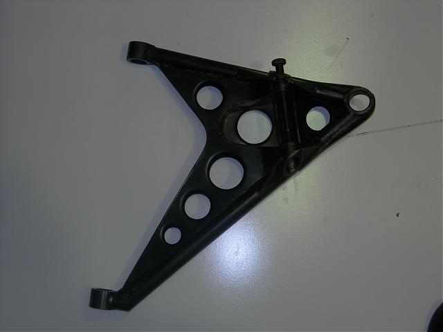

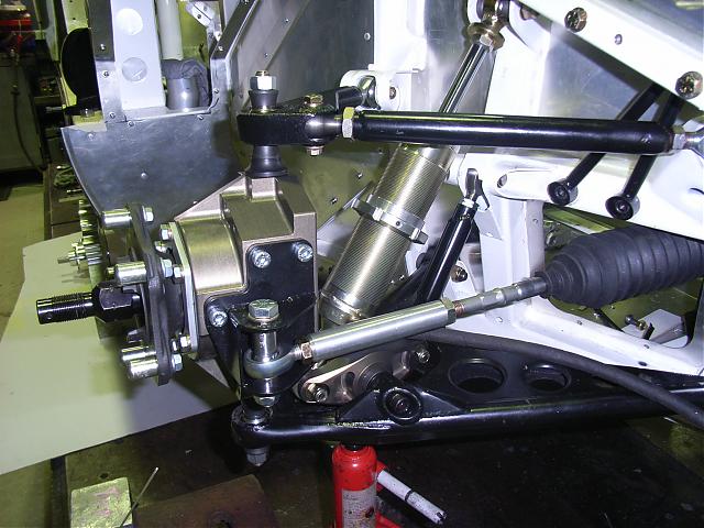

For example whilst we could not use their hubs we were able to use
spindles / rotors / top hats / callipers / rims / centre lock systems etc etc as a basis for the four corners of the car.
We basically placed the the wheels where we wanted them to live in the wheel arches dialled in the desired roll centers, scrub radius, camber, caster, toe etc etc and ran a computer generated programme to tell us where the pick up points should be located, wishbone design etc etc. All sounds too simple doesn’t it ? Well it took a year of full time effort from 2 people to sort it all out and here are some of the results.
All I can say is that I hope all this theory actually works.

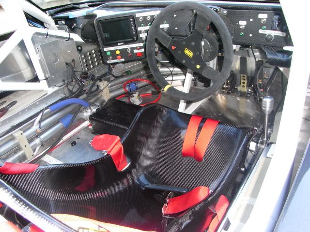

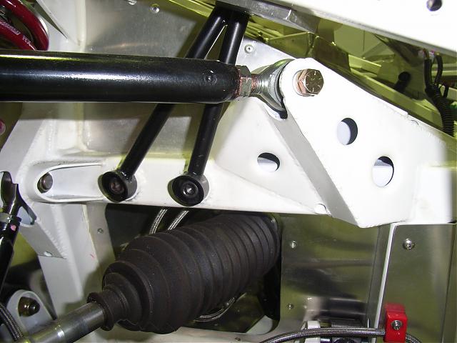

Hi Iain,
Can't help but to agree with Russ, stunning! I been studying with interest the significant mods and bracing made to the chassis.
Given the noise level regarding RF suspension set ups looking forward to your future build posts to see your approach and solutions to various issues. Noticed you are running a drop floor, do you have any thoughts on air flow under the car between drop floor VS flat floor RF cars?
Truly an exciting build in progress, look forward to seeing more updates and photos Thanks Iain!

Andrew, The drop floor is to help accomodate my 6'2" frame, unfortunatley the step in the floor goes the wrong way for the '"aerodynamic gurus" a flat floor is definatley better and I am advised that a step going up towards the rear is even better but I have to keep my helmet 50mm below the underside of the roll bar to keep the scrutineers happy,hence no Gurney Bubble and a dropped floor.
I think it is important to note that the standard RF suspension was never designed or itended to be suitable for race conditions, and I dont think that in road trim you should try and emulate race settings.
Ross is staring to push the envelope and as he gets quicker he will continue to uncover shortcomings in the car, I can assure you that he is not alone in this, with the exception of some of the really exotic sports cars they / we all suffer from the same issues

Peter Delaney
Iain - superb work !

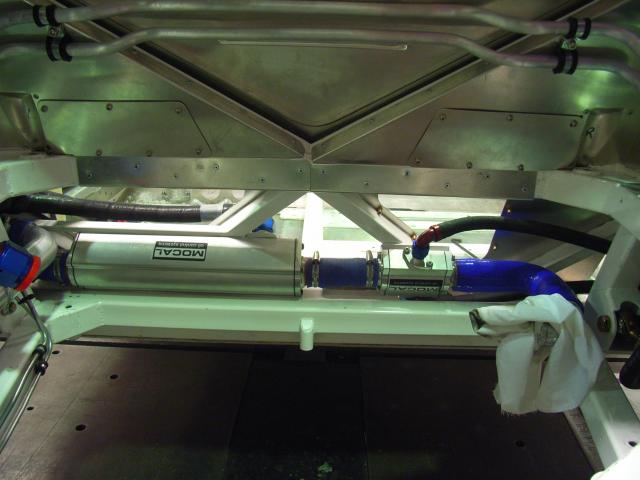

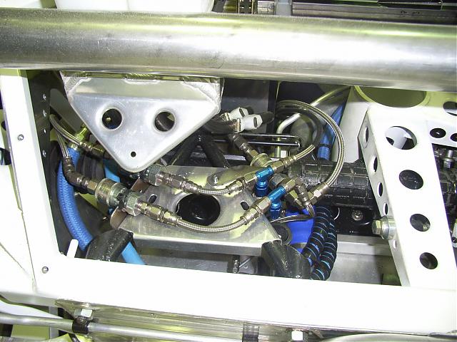

I was also wondering about that big pipe, (& whether you planned any bracing struts from the roll-hoop back to the tops of the rear suspension mount towers) ?
Keep the pics rolling - its so nice to see that level of perfection.
Kind Regards,
Peter D.
I was guessing air jacks.
Tim.
I must clearly display my L plates here, but to my untrained eyes I can only see 1 big pipe so air jacks would be out, please point out the others I can't see... then again a trained eye would pick up a lot more than someone who has never built a GT40.
...Anyway, Iain I'm sure this will be a thread that people can't put down - just like a good book. Look forward to its progress.
cheers
I would also say it’s for air jacks. The rear two appear to be where the battery and R/H hopper tank would have been.
Iain, that’s one awesome bit of kit you’ve got happening. Will follow this thread with great delight.
More pics……more pics :)
Clayton
The tubes are indeed for air jacks, we finally found some units that are made by Harrop Engineering (here in Australia) that give (we think) the right balance between back and front for the car to come up sort of level. They are also quite short by comparison for the amount of lift they provide (which is important especially for the front one. The car does have rear stays to the roll bar, they were not fitted at the time, We have connected them to the top of the rear cradle and the "normal" location (where the battery box normally lives) if I can find a photo I will post.
Iain
Firstly it helps to balance the weight in the car, second we were running out of space in the foot well, hopefully the chassis is sufficiently stiff that it should not make any difference when the jacks are used
