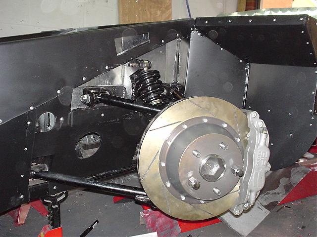

Originally Posted by Iain Pretty View Post
What is the significance of your avatar, is it a prize for the "last of the late brakers" ?
Iain,
Not quite they are my front brakes as I originally got them. They look a little more like the below now.
BTW if you are trying to acheive the look of the new GT, don't forget to add the piece that makes it look like a 100 inset into the lights (an alleged piece of corporate vanity for the centenary).
If you get a picture back from Andy, could you post, as I can't find any details on the Tornado? Years ago I had the same idea as you, and had exactly the same lights I have posted about, but have now reverted back to some Renault 12 lights for a more original look.
Brett

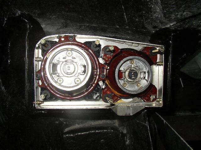

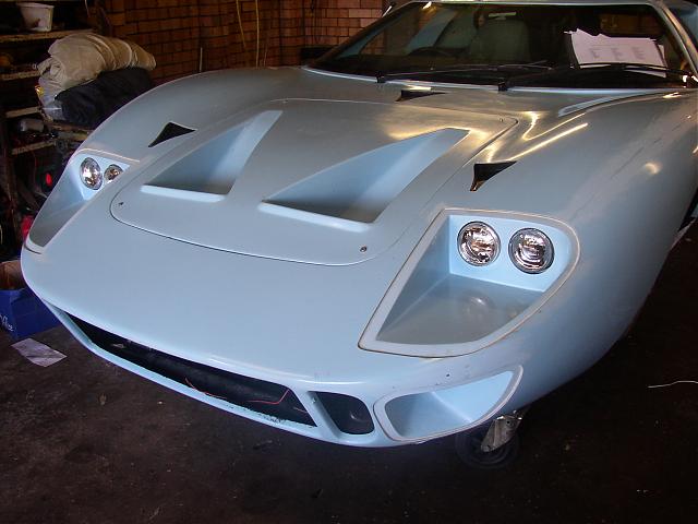

Iain attached are a couple of shots of my DRB with the Hella lamps.
Darrell
DRB#46
LS1/G50

darrell did you make the mounting bracket yourself and i see you have mounted the rivet nuts in the sides do they not come through the bodywork on the outside edges
chris
candc is offline
Old 01-05-08, 07:07 PM   #140 (permalink)
Join Date: Feb 2004
GT40: Newcastle NSW Australia
Posts: 59
Rep Power: 5 DAZPT is on a distinguished road
Re: Rf 117
Chris I make the mounts up with 1.6mm alloy plate to fit the adjusters etc of the lamps, I had a friend of mine glass in two panels either side of them with 5mm bolts going through the panel than some washers to align the lamps in the holes in the front clip. I do have the prototype(stuff up) laying around some wear if you would like a clearer pic.
Darrell
