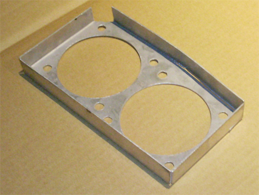

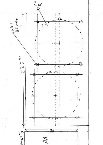

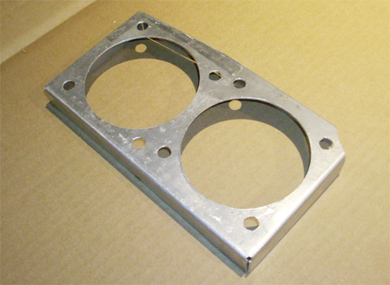

if you could post pics of your prototype that would be great i am fitting the same lights as you i originally had mounting bolts through the front but didn't like the look of it so starting again

Sorry to be so slow to get back, hope this helps.
Darrell DRB#46
