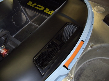

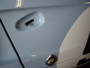

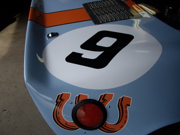

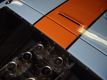

Here are some photos that have been requested by some members.
ray maserang III is offline

That's awesome. Liking those handles. Did you use anything special to make them parts wise?

To remarks/questions on the details:
Was the side light not green in stead of red?
Front spinner not smaller than rear one?

hey brett been out of town just got back saw your post the door handle pocket was sized off pictures then traced on the door then cut out then I bulit a plug with the correct depth that fit in cut hole then I layed many
layers of fibber glass matte over wooden plug from the inside of the door
Old 07-23-07, 12:54 AM   #38 (permalink)
ray maserang III's Avatar
ray maserang III
Join Date: Feb 2007
Location: St. Louis, MO
Posts: 13
Re: Customers car...door handles
layers of fiber glass over wooden plug from the inside next day pull the plug out of door finsh and smoth all edges with body filler .
The workings were a bit more trickey but I have pics of workings & cutting,fillingof stock handel&the plug made of wood . Ray III

fred the light on r quater on # 1075 should be red . Evey picture I have seen at lemans in 68 it is red . as for the spiners being to big in front your right but you tell me where I can buy them and I will thanks Ray III
