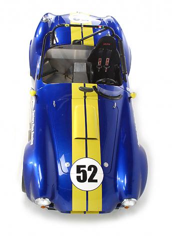

Similar colors. I believe it is Nissan blue with corvette yellow stripes. looks great

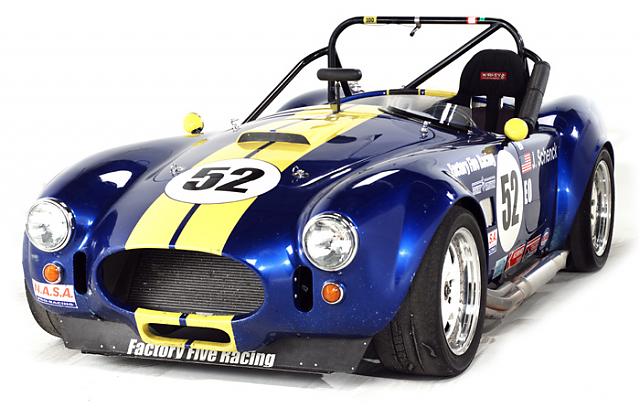

Nissan 350Z blue with Corvette Millennium yellow stripes.

Gary, thanks for posting the colors. I always liked the look of that car. I am actually loooking for a darker blue and deeper gold. The wheel centers will be gold also.

Ant, turns out he used a picture he found on the internet (looks like the same one at the top of this forum page?).
He also added this one:
These are new to us, but you guys have probably had them for a while. Cheers!
