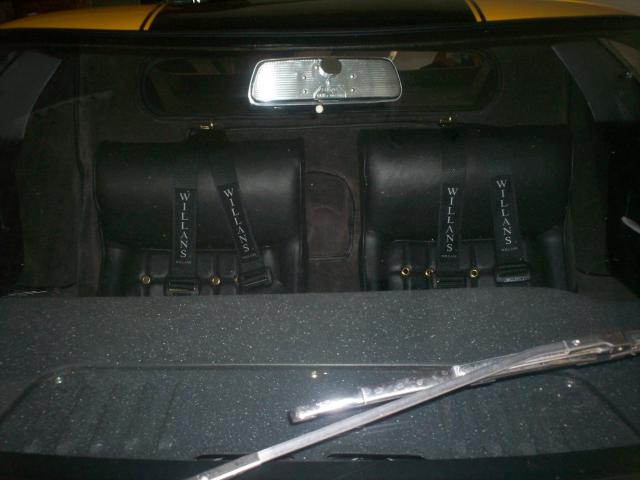

Lucas 608
Soon a new de-mister grill...

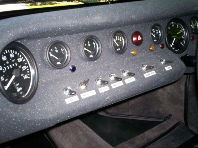

New self-luminescent (Glow in the dark) switch placards installed.
Pics are a little over-exposed.
S

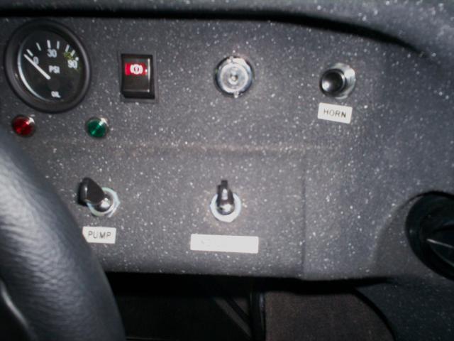

Today I installed my new Tornado replica dash de mister grille.
It only took 30 minutes and six easy steps...
1). Remove the door check straps from the dash side.
2). Remove the 4 dash attach screws.
3). Pull the dash aft just enough to remove the early type grille.
4). Locate holes and drill new grille.
5). Install the new grille.
6). Imbibe several ice cold Heineken's.
JOY
