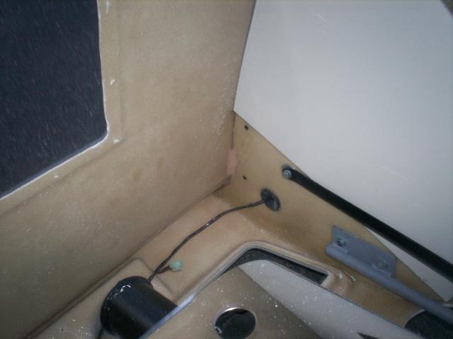

Installed the wiper motor and drive cable.
Note the OEM type pre terminated harness end on the motor assy.
Still need to flare the end of the drive tube and cut the cable to length.

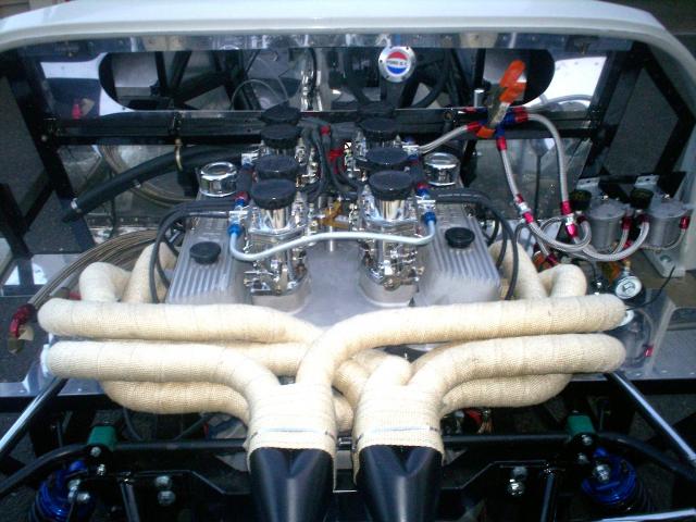

| Re: Tornado TS40 #875 Tonight the the TSC "Twin Pumps and Filters" option was mocked up with fuel lines.
The cockpit closure panels go on at paint, then the filter/regulators get mounted.

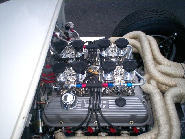

| Re: Tornado TS40 #875 Just a quick update today.
Rigged the throttle cable for the Webers.
It is visible on the front of the engine with the spiral anti - chafe wrap on it.

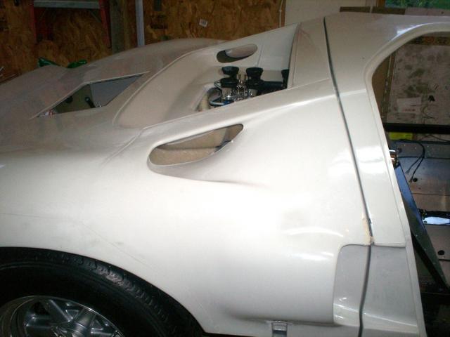

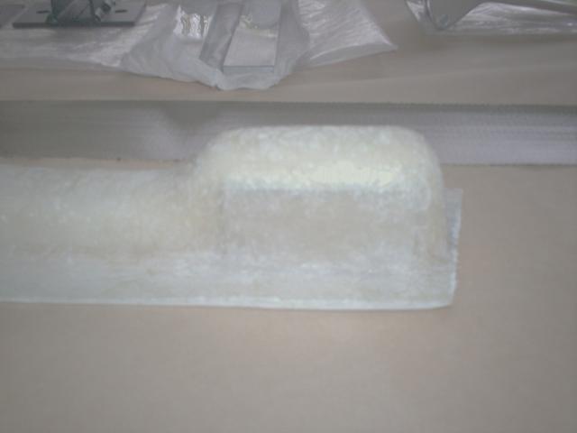

| Re: Tornado TS40 #875 Ok todays progress;

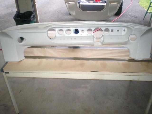

I cut all the openings in the dash for gauges switches etc. It just needs some very minor sanding then it will be painted wrinkle flat black. After that I will install the pre-terminated dash harness and gauge/switch/indicator light set.

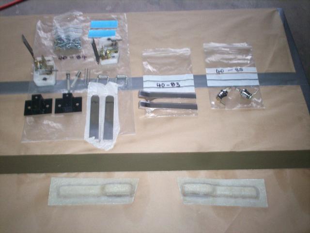

Familiarized myself with the door kit hardware. It comes complete with interior & exterior handles, lock cyl's, latches, strikers etc and notice the glassed in alloy sheet in the exterior handle recepticle.
I cut out and fitted the left and right air intakes under the rear window. They will be glassed in at body/paint.

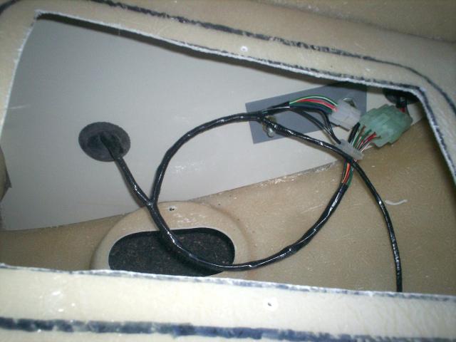

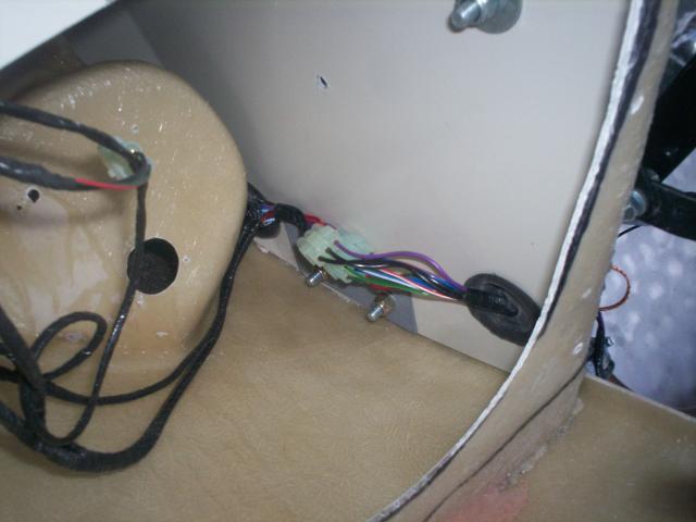

I installed the front & rear plug and play wiring
harnesses.
I cut my ignition wires to length and crimped the ends. I think they look good over the rocker covers and between the IDF's. Don't worry they will be secured from interfering with the throttle linkage.
S

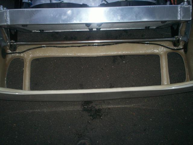

| Re: Tornado TS40 #875 Scott,
If only my progress could be so brisk and still so proffesional. Nice job indeed. Do you have any concerns regarding using copper cooling pipes with aluminium rad ? I'm no expert but just maybe worth a mention.
