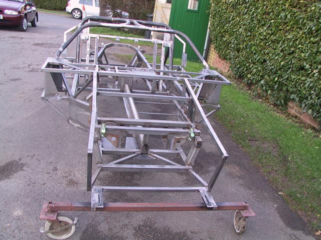

Looks like you have some work to do there - welcome to the club. The roll cage is a good idea but whilst it is apart I would add a strong main hoop to the outside perimeter of the bulkhead made from strong cold drawn tubing of about 2 inch diam. also replace the rectangular tube at the top with 2 tubes from strong tubing. Also put in backstays from the bulkhead main hoop to the rear chassis - remember your head is quite valuable to you! Mount tubes to the chassis via plates of steel. Pic of similar on a Southern GT attached (approved for hillclimbs and sprints by UK MSA)

PS Make the main hoops in one piece. One more pic showing the roof tubes. I also have a GTD. If you need pics drop me a line.

Funny you should mention that about the roll cage that is one of the things on my long list of things to change.
Thanks,

Mike - 2" Tubing??? Man - that's huge.. SCCA and FIA requirements for GT1 / Trans-Am are 1.75" DOM .095" wall.. GT1 and the GT40 both address roughly equivalent weight and speed potential..

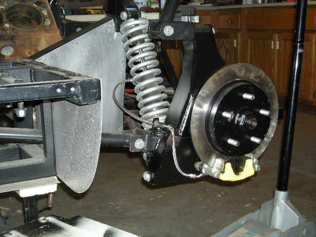

Just a few pics, of the cleaned up brakes and suspension, for now I'm going to leave the brakes the way they are except for the pedal box thats
going to be changed.

Nice looking brake setup Bob. Good progress. Winston is very photogenic!

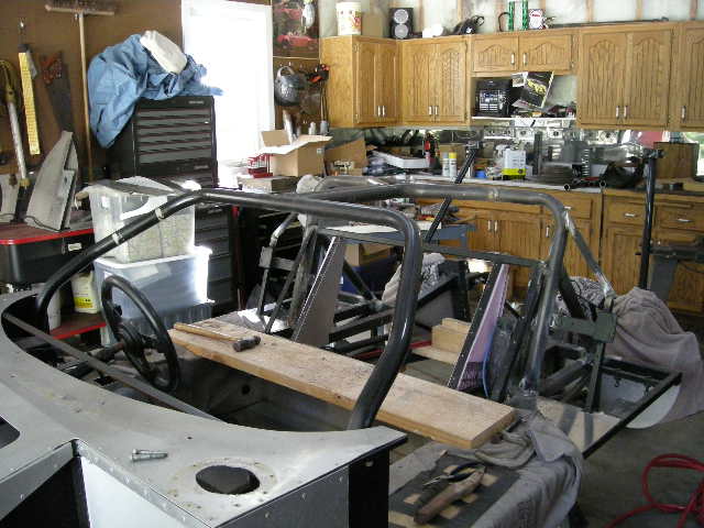

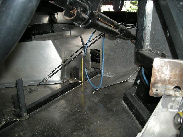

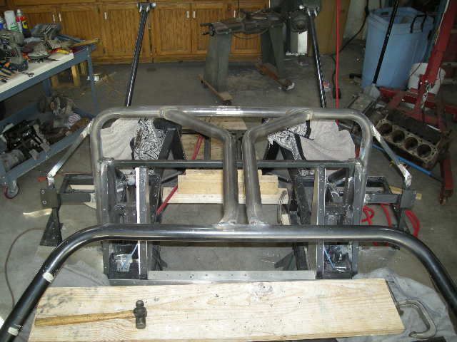

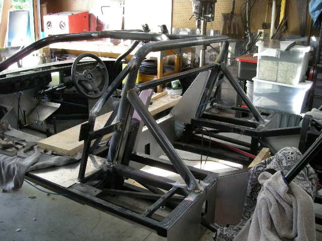

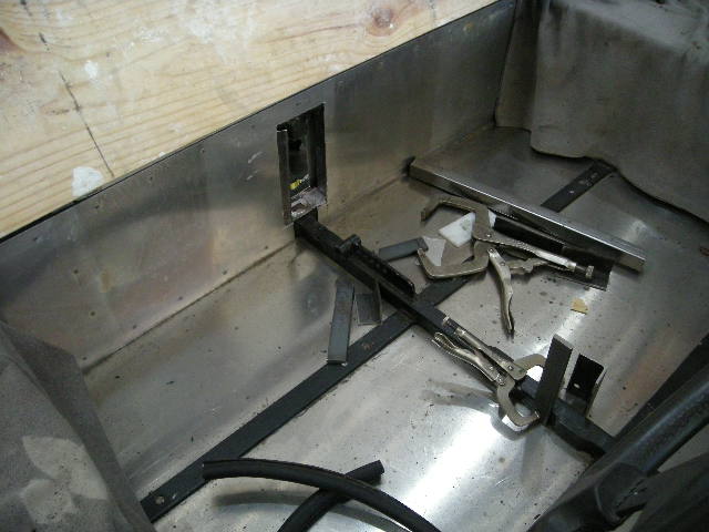

Hi All,
Well I finaly got the rollbar in this weekend and started the center counsil that will hold my airconditioning lines and heater hoses and also a conduit for any electrical that I mite need. I am looking for a hand brake seeing how my car came without one, I will post a wanted in parts also. Well back to work
Bob

Looks like a nice cage Bob. Back to work indeed.
