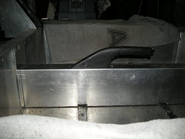

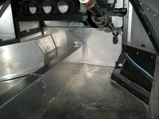

Well I finally got the center counsil and hand brake in its not secured yet but all there. sorry I'll try to keep the pictures coming. I also relocated the steering shaft to give me a little more foot room.

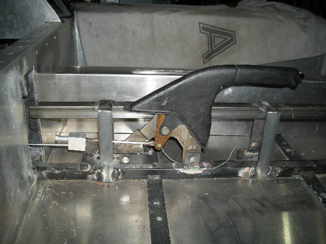

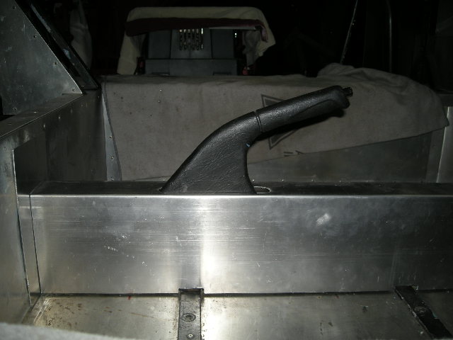

Well after a trip to my favorite salvage yard and the local NAPA store, and about 2 hours of creative engineering and 37 bucks my parking brake set up is complete and seems to work OK. here are the latest pics.

Bob,
You may not have allowed enough room for feet/pedals with the centre tunnel the way you have it now. I fabricated a similar centre tunnel but with less height/elevation(but sufficient for two 50mm coolant pipes) but where I joined the front bulkhead the profile went from being rectangular about 18 inches from the bulkhead to Triangular biased toward the passenger foot well. If this isn't clear I'll get a photo of it this week. I didn't use the pipe covers in the passenger footwell as my coolant pipes are , obviously, down the centre. so there was room to put in a passenger footrest like the rally cars use.
I didn't put a handbrake in the centre position either - I think that as I have seperate hydraulics front and rear, an hydraulic lock lever will work as a parking break in addition to leaving it in gear. Sure - some will chirp up that it cannot be permitted for our Ministry of Transport tests but thats taken care of as well.
Unless you have tiny pieds, try your foot well positions and see how much space you have.
I'm assuming this is a GTD?
Dave M

First concern is to dave, thanks for the imput and I have already tried the foot pedals and they seem to fit fine and as far as the hand brake that stays ingaged with the handle down my fiero had that set up and you don't know many times i've taken off with the brake still on, that sucks because you tend to distroy brake pads very easy that way.

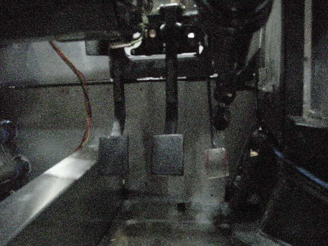

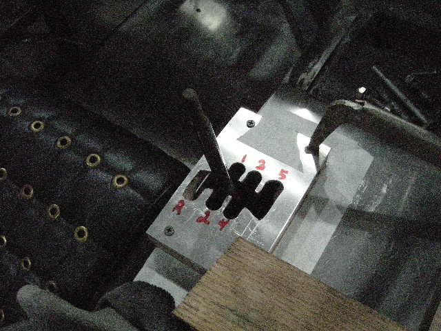

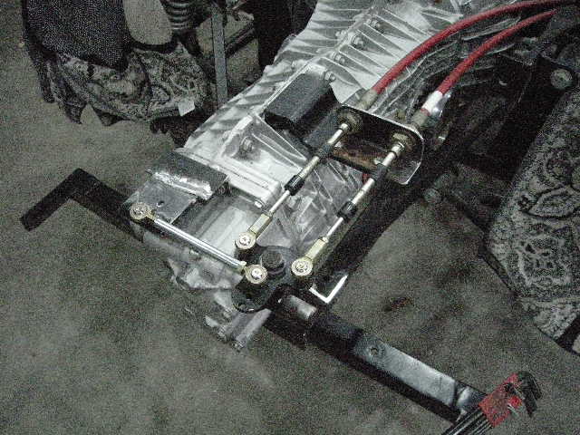

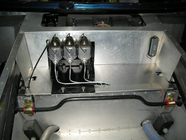

Well I finaly got a little more stuff done on the car the petal box is set up and the shifter linkage is in and working. and of coarse Winston my supervisor is always there to put in his two cents.

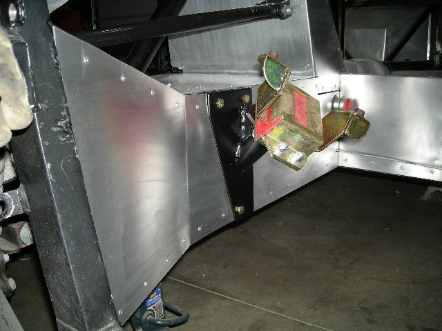

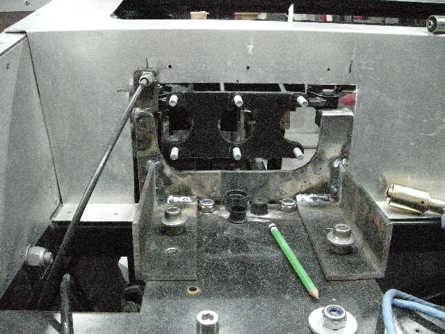

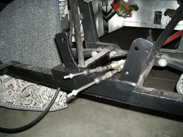

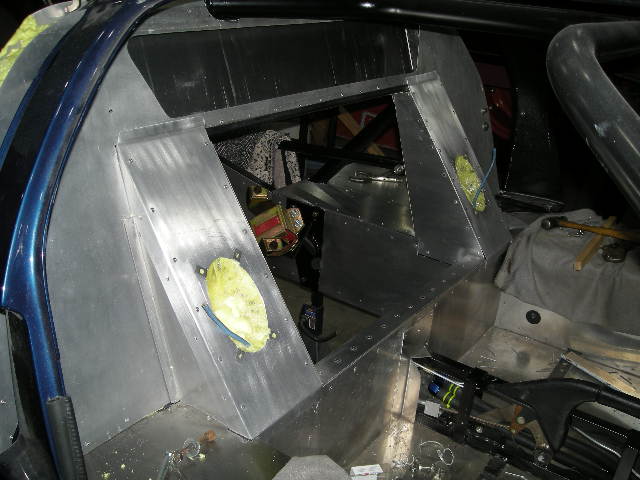

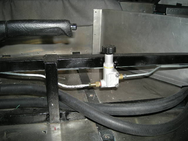

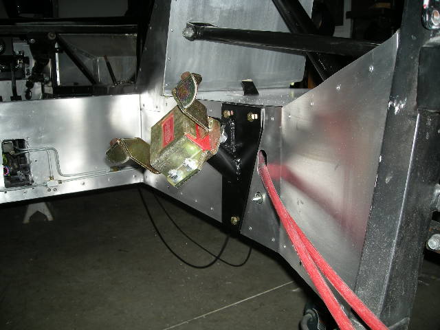

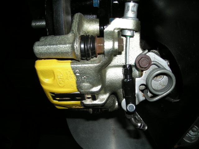

Well I finally got out to the garage and took pictures of the recent accomplishments. As you can see from the new pics there has been some progress, the brakes are finished new lines, proportioning valve, clutch line all the masters and the mounting brackets all powder coated. Also I have done some refitting of aluminum body panels. Also got some speaker holes cut in and wired. Next are the air conditioning lines and heater hoses

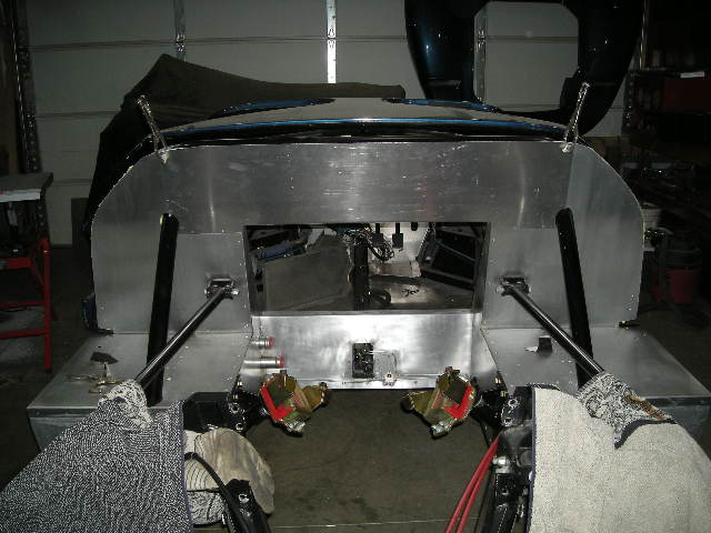

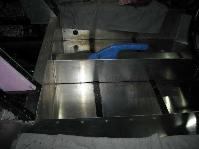

Well I finished off the area around the master cylinders, I built a frame then insulated it aluminum faced insulation the added two cover pieces,
it does'nt look original but it finishes it off nicely, what do you think?
