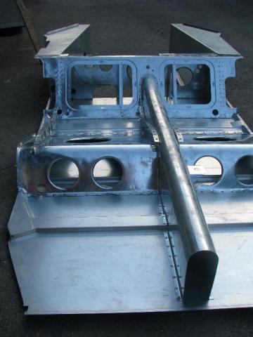

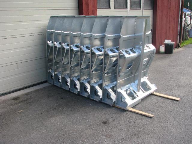

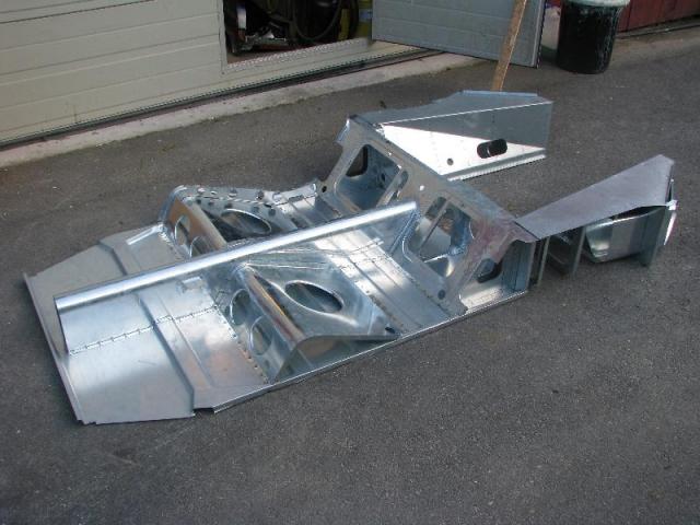

Just to give You a small update on the monocoque project .
Things seems to take more time than planned (I still have a famely that want some time etc), but we are steady moving foreward with the project . Here are some pictures that show the floor spotvelded to other parts .
Most parts are now pressed, bent, rolled and velded together to bigger parts. The assembly have started. The first 8 floors outside the old workshop.
