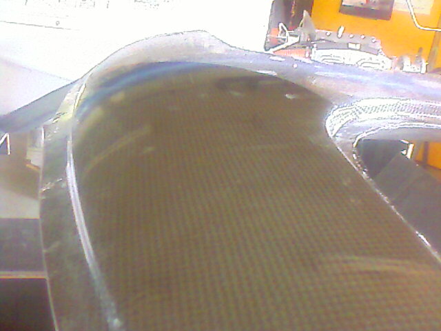

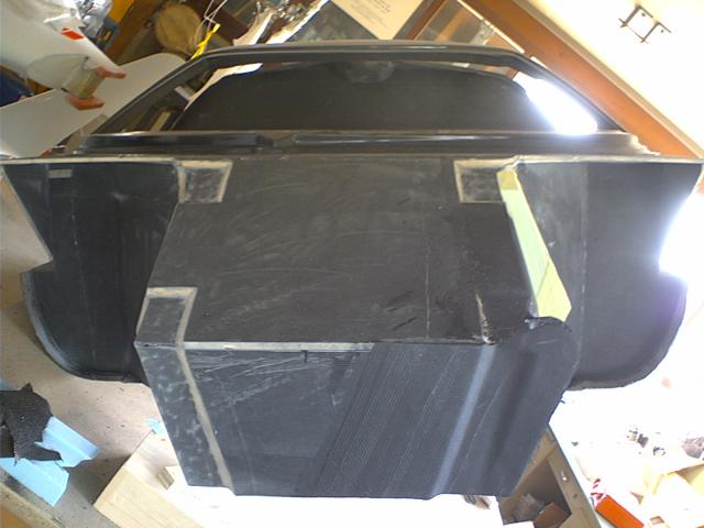

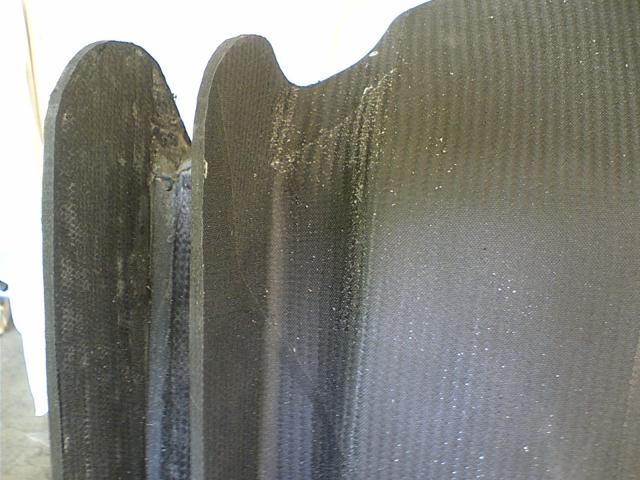

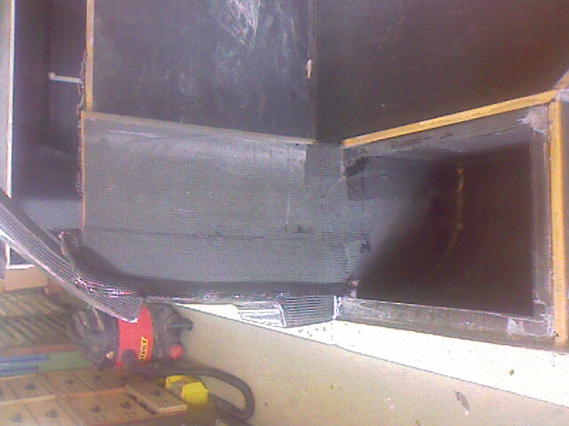

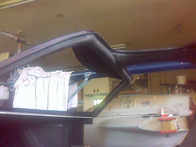

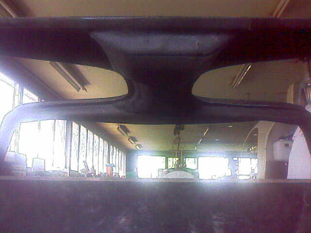

here some pictures of the mono.
the weight until now 40kg
sorry for the bad quality of the pictures i ll try put in bether pictures

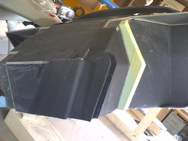

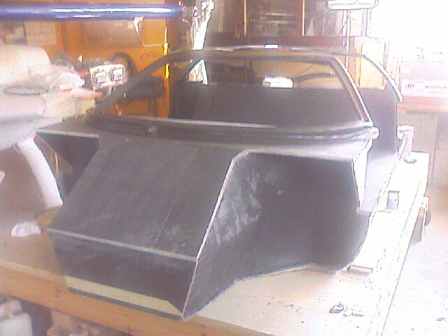

now we start with building up the front hinge points with carbon ribs.
that s only the outer part now i have to laminate the inner part of the ribs.
here some pictures.

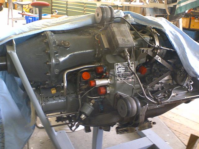

And at last!! For the ultimate lightweight gt40 i will put in the allison turbine!!

Re: Carbon GT mono
Seriously? Holy Andy Granatelli!
