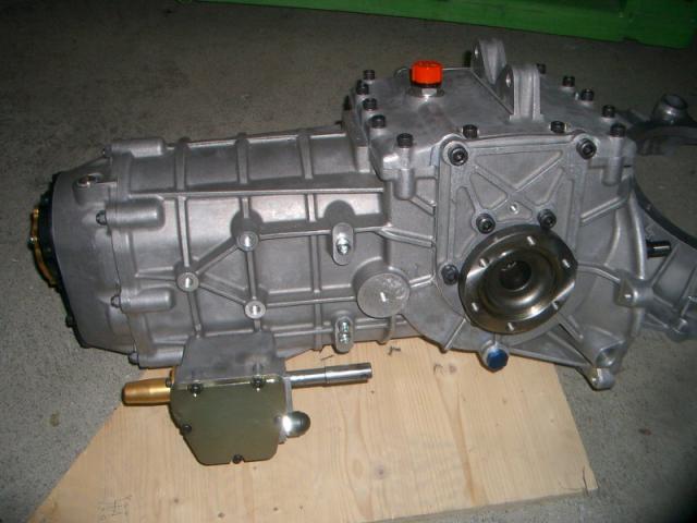

and Scott ,it s a early allison 250 now it goes to check.
and at last something that should be also as nice as driving a 40!!

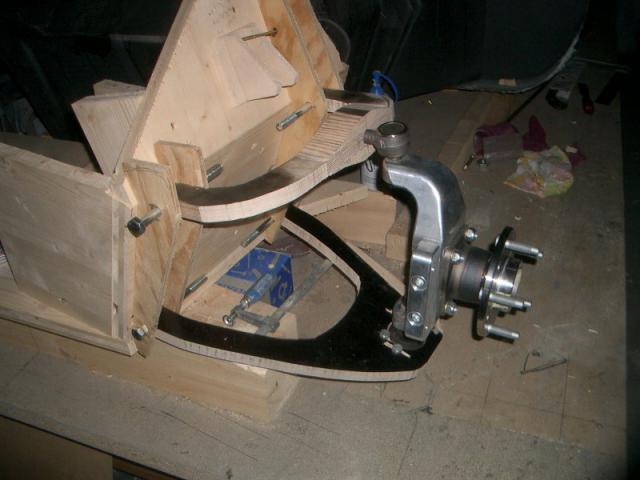

now i startet on the suspension Dummy made of wood ,that we can take of the forms for a carbon upper and lower A arms.

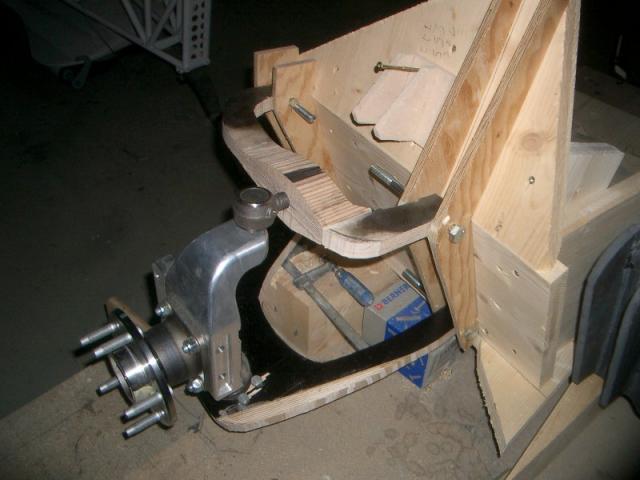

This week i also could do some work on the chassis. I fitted the rcr front uprights to the Wooden A arms.Now we have to measure what the wheel ist dooing when the suspension works.

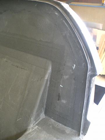

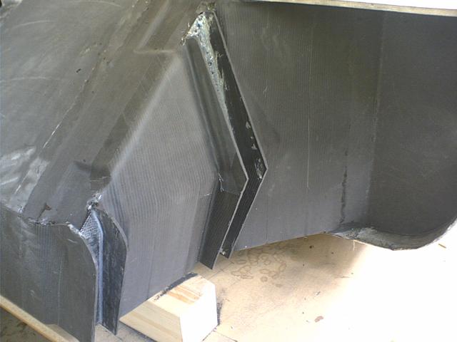

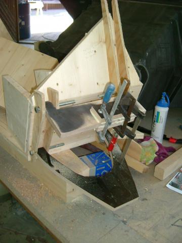

Here some pics.

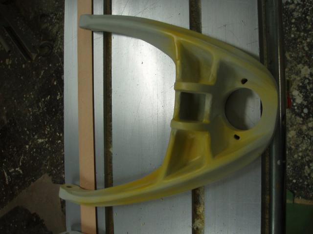

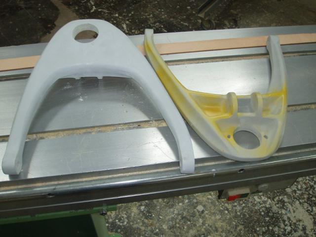

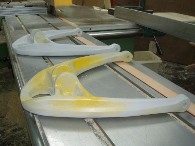

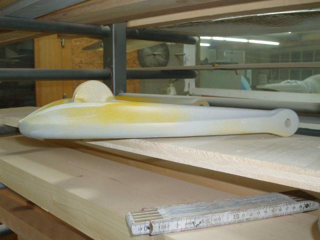

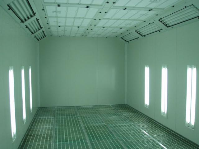

We had a lot to do but not on the gt We builded a paint shop
and i builded the lower front A Arms left and right ,we will do the suspension with a belly crank ,so that we can place the damper unit on the top of the chassis nose in horizontal position.

Can i ask how you controled the shrinkage when laminating the chassis,and did you use a balanced laminated ?
In your first pic was that the plug when you used ply to form the shape then moulded it ?
This would be great !!! Then we could all order a chassis from you..LOL
Those lower control arms are fantastic,are you going to use full carbon in their layup?

@keohep:
What did you mean with the shrinkage?
I builded ribs and i covered them with plywood, like wing of an airplane.and i could use it again.You can place the order = )
To the a arms:
At first, we build them fully carbon an we will look after weigt an stiffness.But it could be a possibility to put in a core to save weight.
At second we study about to put in uniballs that you can do more changes.

So are you forming up ply panels, then useing the ply as the mould then removing the ply to leave the carbon as stand alone panels.
The times ive layed up on a foam core trying to control shrinkage has been a big problem especially when laying up on one side at a time,but if your laying up on ply then the ply would be strong enough to hold its shape.
Would you be using vynl ester resin or epoxy? Ive found epoxy resin to have very low shrinkage. Even Less when Vacuumed.
Can I ask you if your making a mould of the full chassis so you can just lay up in the mould and use vacuum bagging technics, and add foam core and hard points.

I only used the Ply as negative for the Bottom.I drawed the Chassis on CAD,Then i printed out the Plates, then i cutted out de PVC Foam and i covered them with carbon on both sides.then i fitted together the plates an i laminated them together to the chassis, after this, i do the strengthenings and hardpoints where i need them.I take the epoxy which we use for the aircrafts.we never had problems with shrinkage.
It also could be a possibility to take off molds from the chassis but now we building up in positive build.
