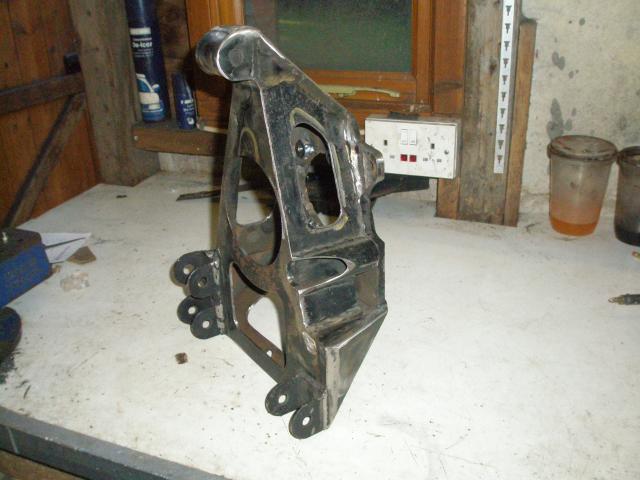

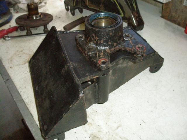

The car was purchased as a part built kit, which effectively is little more than a rolling chassis, but has a 4.6Ltr Range Rover V8 engine installed and is mated to a Renault 21 turbo transmission. However, I prefer the idea of having the correct 'small block' 302 engine. I could swap it later, but it would mean re-doing most of the engine installation, manifolds etc, so I’ve now purchased a stripped 302 engine out of a ’74 Falcon and this is now the plan of attack.
As I had to fabricate new mounts from scratch, I wanted to get the engine mounted as low as possible. Using a bell-housing on loan from Chris Cole (many thanks Chris), I managed to work out where the engine & transmission needed to be and fabricate new engine & transmission mounts. I could have dropped the assembly even lower, but I didn’t fancy redesigning the lower wishbones.
I’m planning to use a 8” deep Moroso oil pan and this will be level with the bottom of the chassis. In fact the lowest part of the car is now the bell-housing, which I will end up machining back. When the pan arrives, I’ll be able to work out where the new engine bay cross-member will fit
I believe that this exercise has resulted in the engine/trans being dropped 40mm compared to a standard Tornado chassis, whilst keeping the crank centre-line parallel to the ground.
I also found out that the mounts on the Renault transmission are not symmetrical about the gearbox centreline, there is about 20mm difference and explains why the alignment never looks right.
Gearshift mechanism next.....:)
Regards
Andy

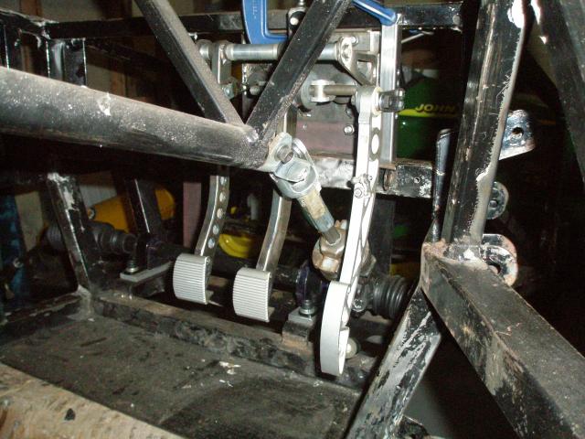

I’ve been working on the steering & geometry over the last couple of weeks. As I’m not using the standard Tornado rack I wanted to check that the bump-steer would be correct. The rack mounts were cut off and lowered, so I could pack them pack up to the corrected height.
The alignment was checked by with a laser spirit-level attached to the front hub, which was over tightened to stop it rotating. The laser image was projected onto a vertical surface, with a sheet of paper attached. As the suspension was jacked up the red dot was plotted on the paper. It seemed a very simplistic way of doing it, but it gave very good results. In fact the further away you move the paper, the more accurate the results get.
The intermediate coupling I’m using is from a Renault and incorporates a collapsible section and a damper and I modified it to fit onto the Ford steering spline. I’m a bit concerned that the damper my clash with the pedals, but that’s another hurdle yet to overcome.
Regards
Andy

I've gone over 30 degrees but not to 45. Per Flaming River (maker of fine steering system products) they recommend 15-30 degrees. From the look of it here you have roughly 30 degrees there..
Reference:
View Image
p_view_image.cfm
I've checked the joint angle and it's only 30 degrees. The photo makes it look worse than it is, due to the installation being a compound angle and the position of the camera.
Regards
Andy

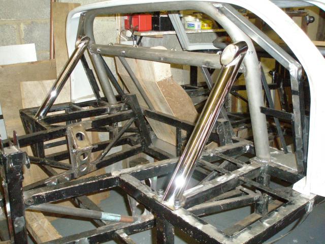

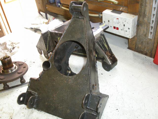

I’d decided as I may want to use the car for sprint & track work that an integral roll bar would be a good idea. To minimise any additional weight, it would replace the existing Tornado bulkhead structure.
The Roll Centre at St Ives bent up the roll hoop to my drawing, which is 50x2mm CDS tubing and complies with the current MSA regulations. As the bar (50mm) is larger than the chassis, I added reinforcing platforms, as well as vertical tubes to transmit the loads into the lower chassis rails to spread the loading in the event of an accident. I’m hoping I can talk my way around the fact that my ‘diagonal bar’ is actually horizontal and doubles as the seat-belt anchorage bar – time will tell. The fall back solution is a diagonal brace over the engine.
I’ve still got to add the rear supports, but until I’ve worked out how the rear paneling will be done, as these may/may not be removable.

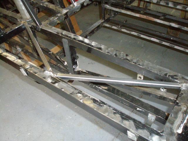

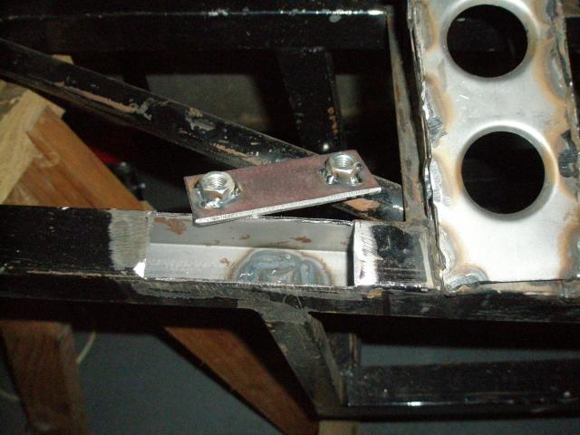

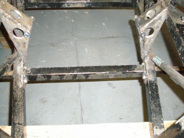

Well, I’ve finally finished taking off all the original aluminum paneling. I’ve decided that the only panels that will get re-used is the floor, as all the other paneling has poor riveting (different sizes, non-equal spacing and in some cases not in a straight line) and this is generally not good enough by my standards. All the old white bathroom sealant has yet to come and as a fill in job I’ve been going round welding up all the rivet holes and then grinding them flush. There’s nothing worst than a drill bit pulling into an old hole. All the old rivet heads have yet to be extracted, as I don’t want the car to rattle!:laugh:
I also finished off the roll-bar stays, which I’ve made removable and will help in the paneling of the rear bulkhead. I’d looked at using a smaller diameter tube, 45mm, but for it to be MSA complaint it would have to have a 2.5mm wall thickness and compared to the 50 x 2mm tubing for the main hoop, it would be actually heavier, so this idea was ditched. This was a big push before a business trip to Beijing for a week, from where I’m writing up this episode.
Regards
Andy
