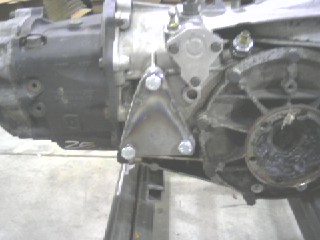

It sure is good to make some progress. I made some mounting plates for the rear mounts of the transaxle. I used a piece of paper and rubbed the bolt pattern and transfered it to the steel using a paint marker and a centerpunch. A bit more grinding to straighten up the sides and I'll be done.
ID:	33754   Click image for larger version
Looking forward to the first drive:thumbsup:

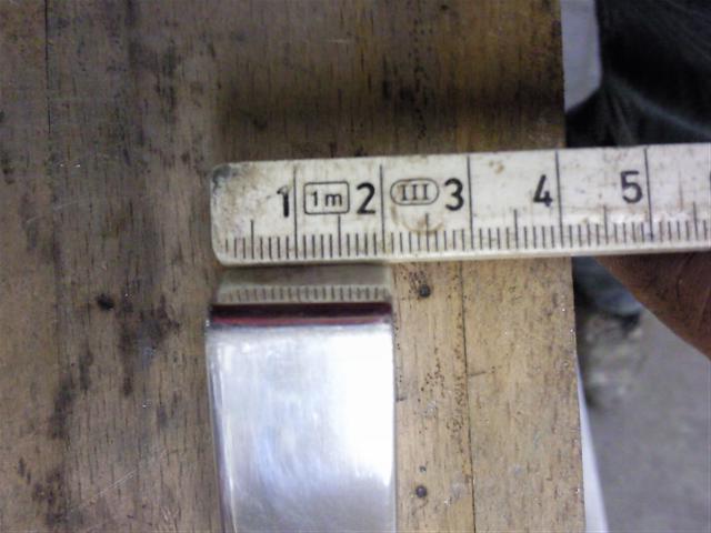

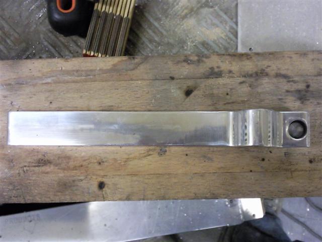

Hi dave
Do you have a bench lathe ?
If i have to make a mounting plate or a mould and cannot copy the holes i put a bolt in the lathe an turn the head of just a couple of mm into a point then put the bolts into the holes put a plate against it and give it a blow with a hammer (use the bolts as centerpoints)
Just an idear
Frank

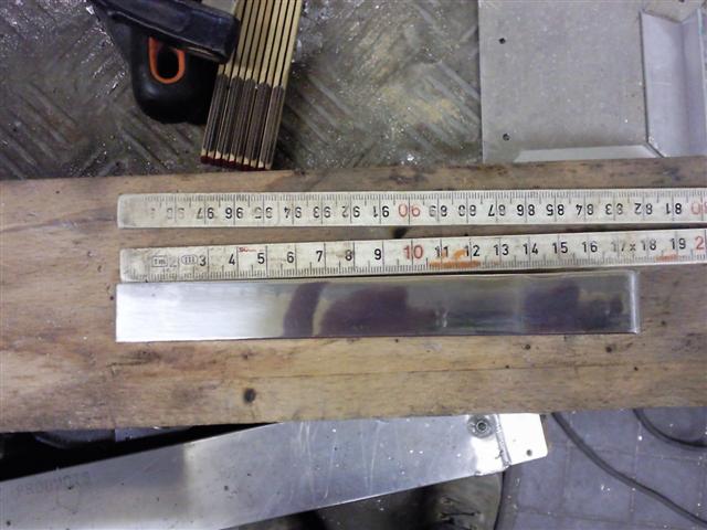

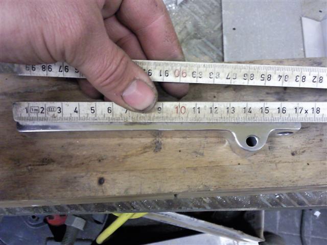

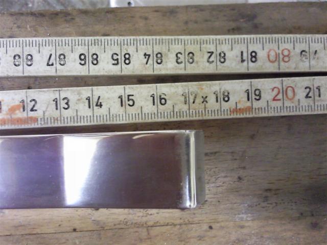

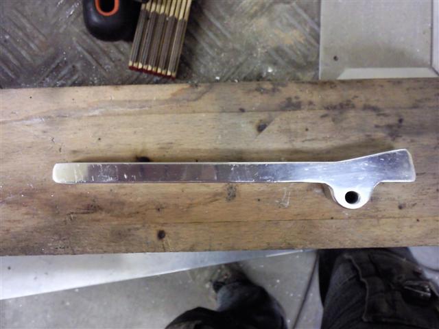

Dave here are the pics

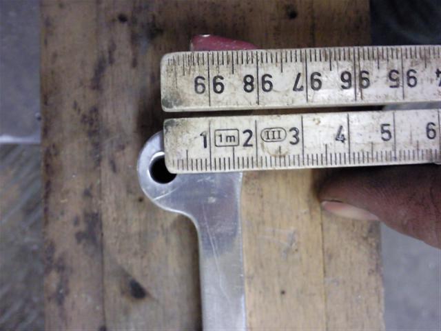

Thanks Frank:
Well now I have to decide casting or write a cnc program to make some billet ones.

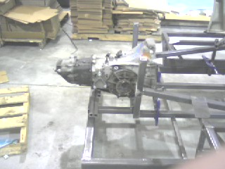

Have made a bit of progress lately. The dash bars are cut and tacked in place. I did have to cut my rear bulkhead uprights loose to reposition them farther back on the chassis

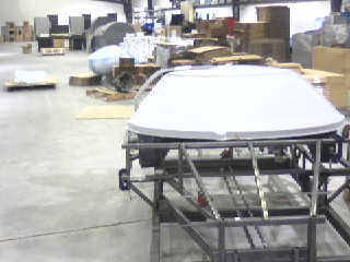

Re: Good bye Locost 7 Hello GT40!!
Anyone have good photos of door hinges and pin location through the door?
RacerDave is offline
Old 11-28-08, 11:31 AM   #48 (permalink)
RacerDave's Avatar
RacerDave
3 Tenths
Join Date: Dec 2007
Location: North Carolina
GT40: scratch build
Posts: 362

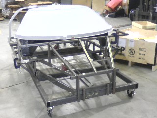

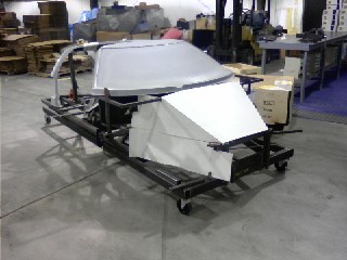

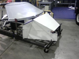

Made some cardboard templates for the aluminum cladding.
Suspension mock up is the next part of the project.
Hoping to buy a mig welder after Christmas and move the 40 home.

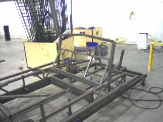

A few of photos of work I accomplished during the last few days.
I mainly work on the car during my lunch break which is about an hour.
Some days I run errands to run so it has not been an everyday ritual.

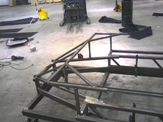

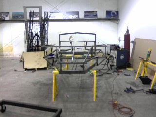

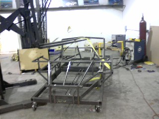

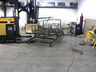

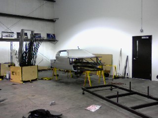

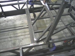

Yesterday was a great day got a lot done! All the welds on the upper side of the chassis are done Russ Noble and Kalun D had said the chassis would spring and possibly twist which I knew to be true. It was my hope that by tack welding and using clamps in key locations it would be a small amount. The moment of truth had arrived. I cut the tack weld and loosened the clamps. The chassis sprung about .150" over the whole length side to side and the chassis stayed flat to the jig no twist The next step is suspension after Christmas celebrations.
Fit the body parts without the chassis jig also welded the door latch supports in place to the bulkhead frame work. Also made end caps for some tube ends.

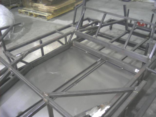

Have a bit of progress to report. The floor pan is welded in place. I chose to use .045" steel instead of aluminum.
