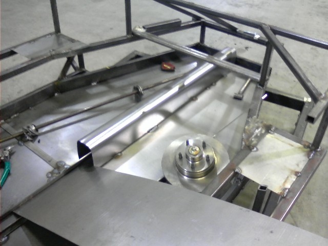

Yesterday was a good day. Along with the progress on the pedal box I was able to bend part of the cooling line tunnel cover. I used a piece of the same material as I used for the floor .049 thick. It was tough to bend.

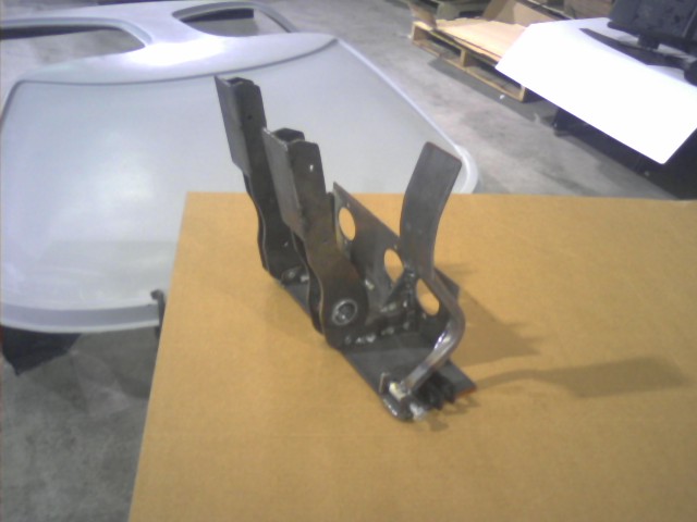

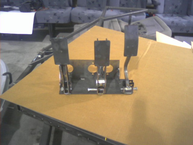

Re: Good bye Locost 7 Hello GT40!!
The pedal box is taking shape. Actually build time is about 8 hours so far shaping the pedal uprights has taken the most time. I have to do a bit more welding,grinding and procure a 5/16" female heim joint for the clutch rod pivot.

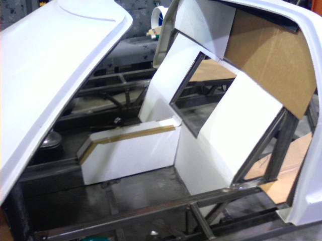

Been awhile since I posted. Life seems to take time from the GT. I have been busy making cladding templates for the interior and the rear chassis section. Also been chasing axles and stub shafts to fit the UK granada hubs. The local axle rebuild shop has been a big help. Unlike the gentleman that sold me the axles on ebay.uk and would not ship the parts to my freight forwarder there after I had paid him . I had a bright spark moment I took my hubs to the axle guy and ah ha the cadillac Eldorado has the same splines
