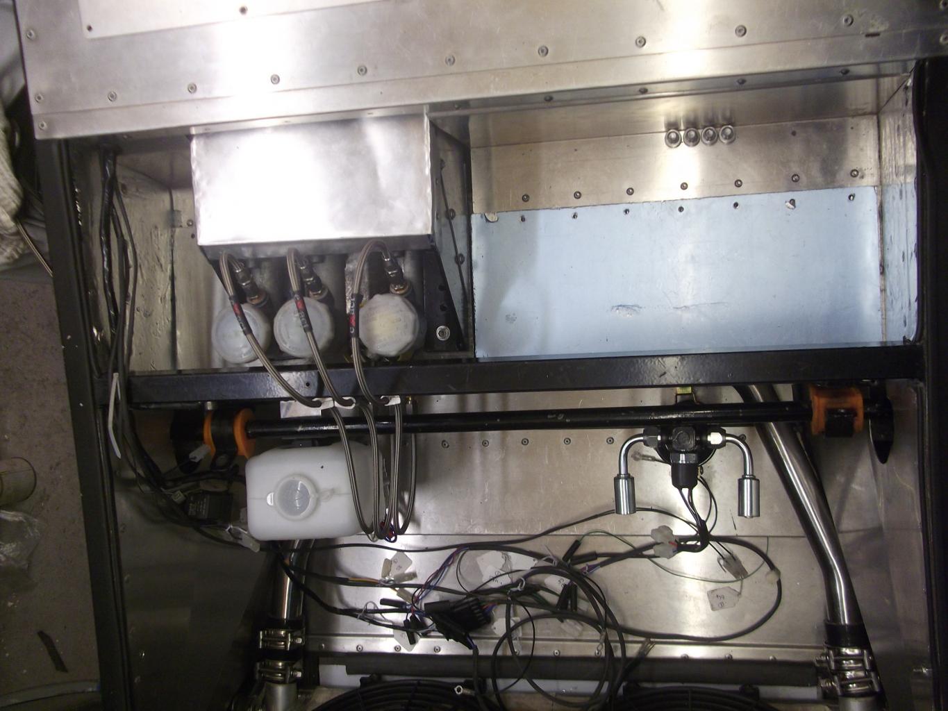

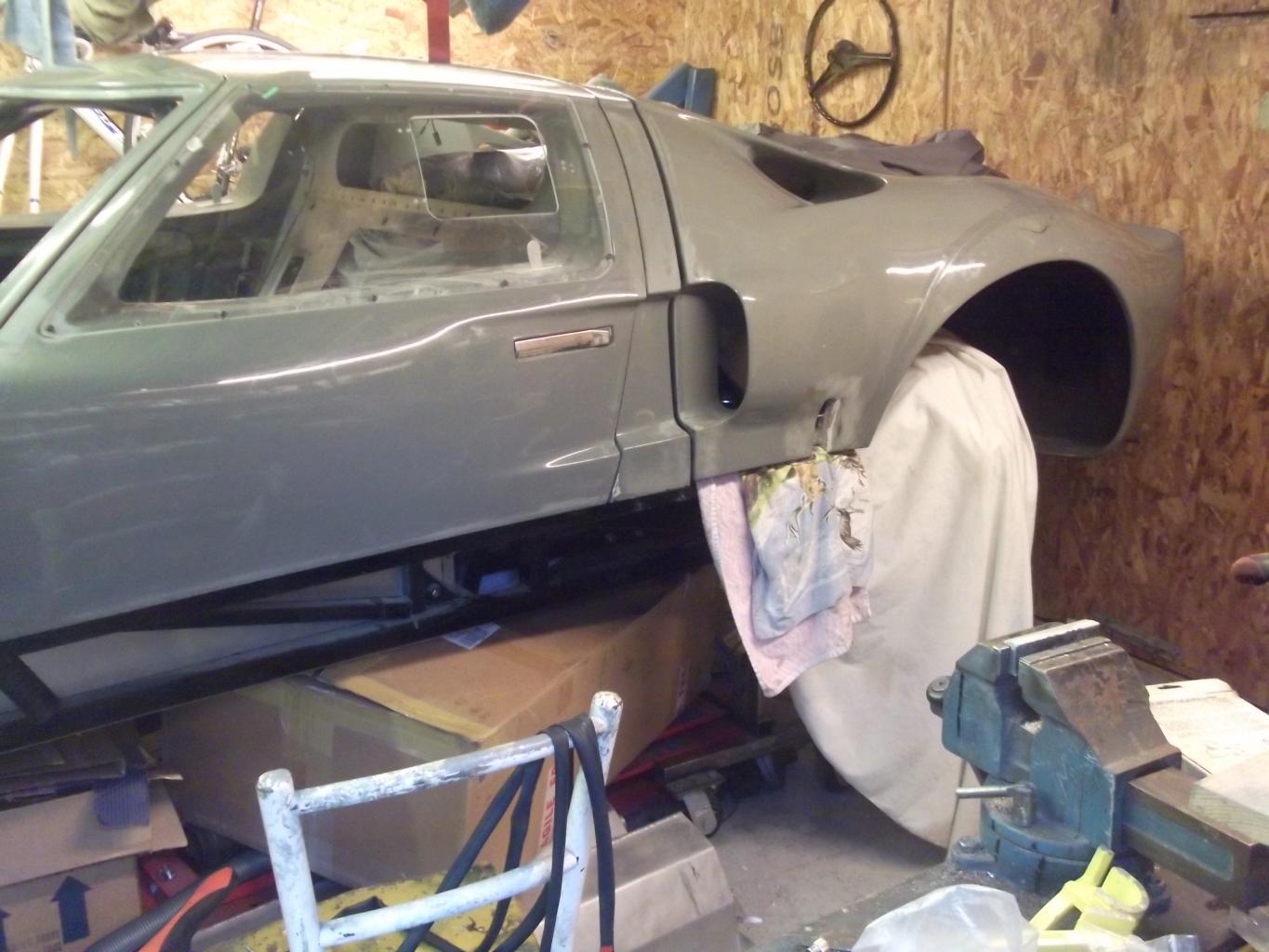

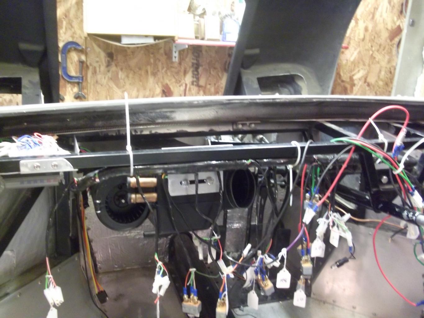

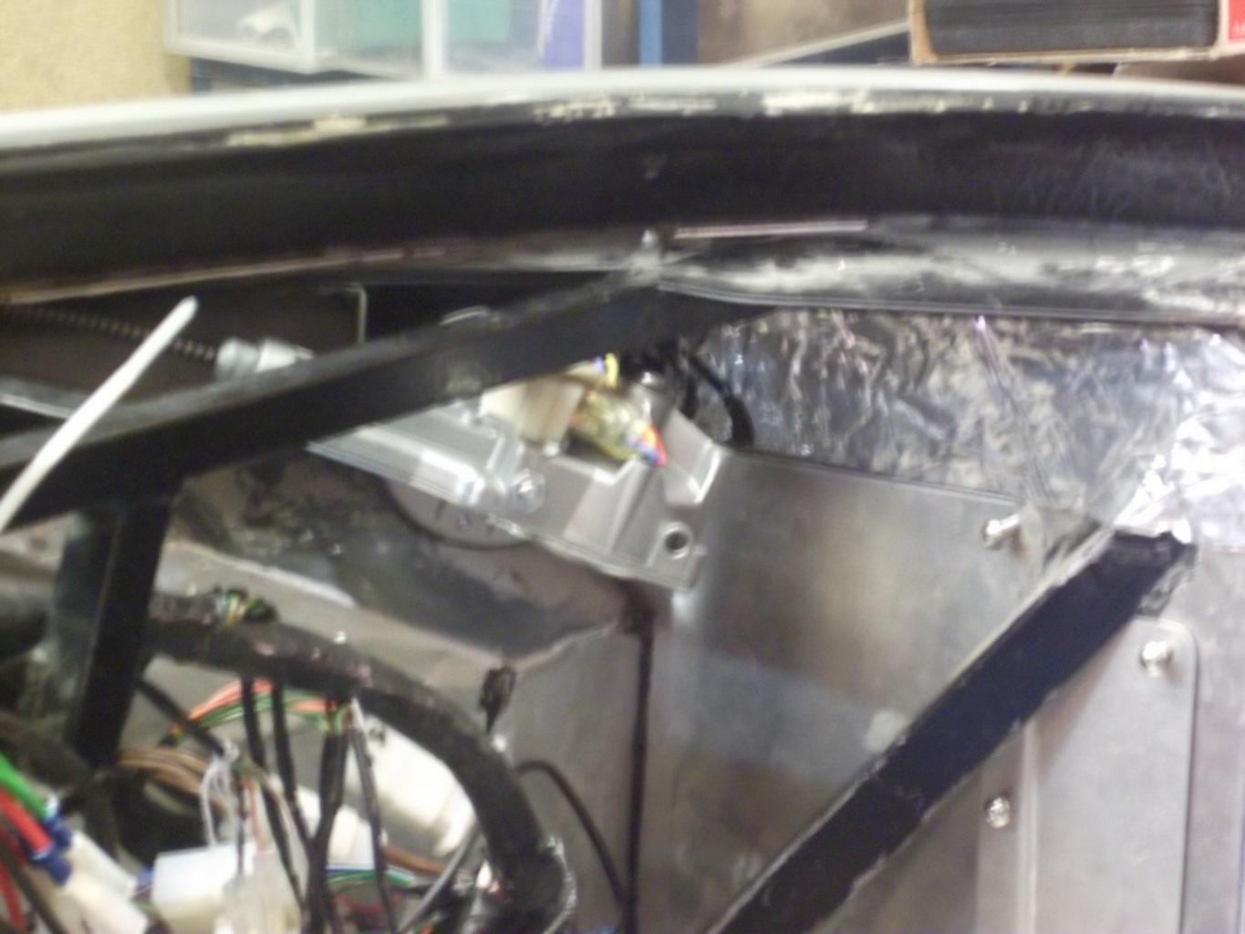

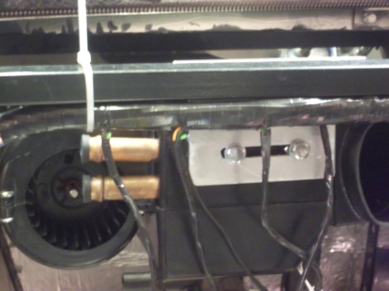

Air con and wiper motor in
Air con and wiper motor added.
Also a couple of pictures showing the space fore and aft and why I am so jealous of you guys with big garages.

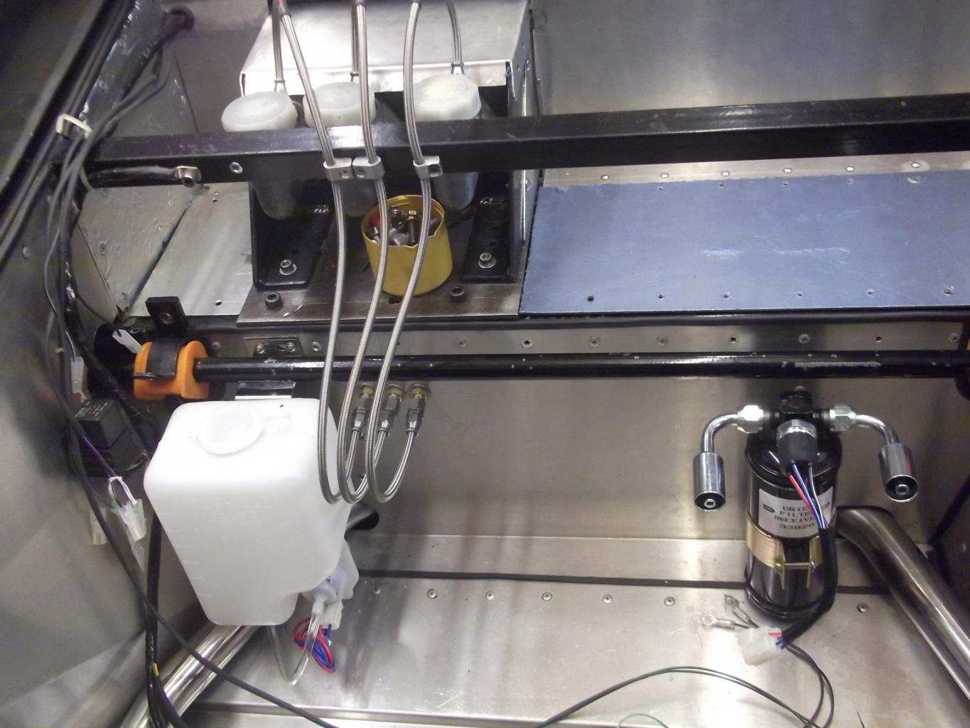

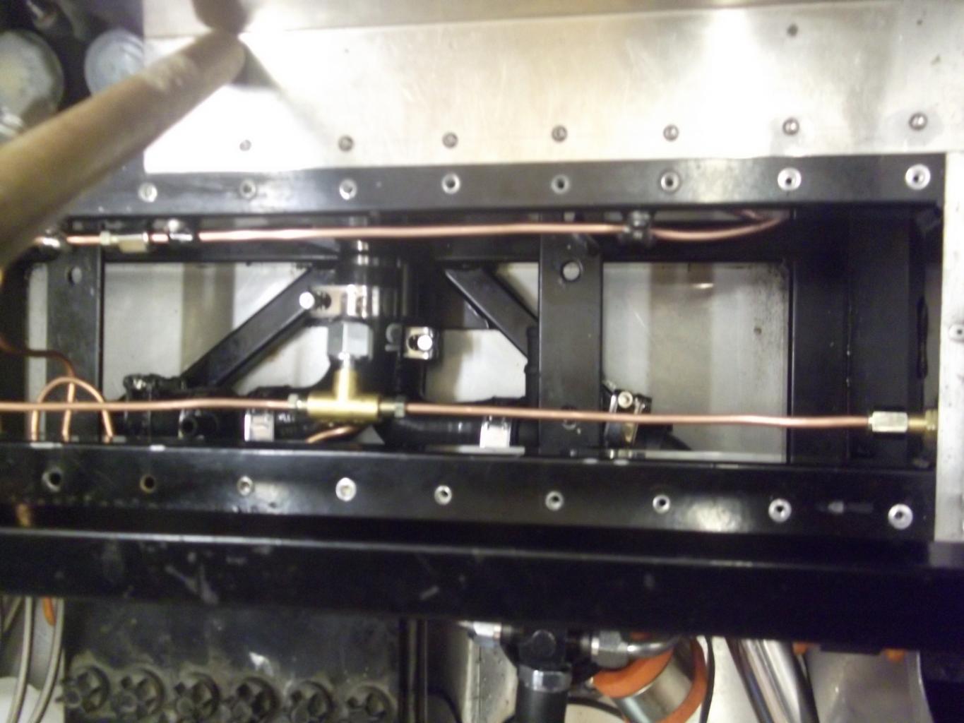

Water pipes and Master cylinders.

Regards
Nick

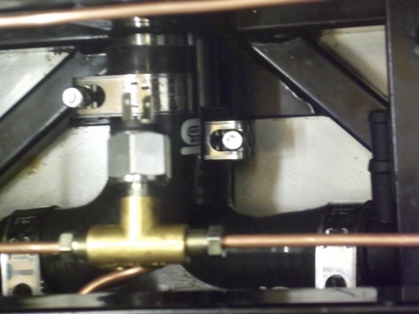

Nick
If you leave your aircon dryer open like this ( and if it is sitting like this for longer), you can as well buy a new one. They tend to "dry" the air in your garage, thus using all there capacity for that. Reco is to keep them closed until you tie them in the system , which than should be closed and filled asap.
TOM
RCR EUROPE by S-PERFORMANCE

Originally Posted by EGLITOM View Post
Nick
TOM
Ooops.
Thanks Tom don't suppose there is an easy way of checking what damage I may have done.
Regards
Nick

True, as Tom says.
When my air con man crimped up some of the hoses he said the same thing. I removed the caps to get the right routes for the hoses.
They are cheap as chips from car builder solutions so get a new one just before gasing up.

Originally Posted by Keith Baker View Post
True, as Tom says.

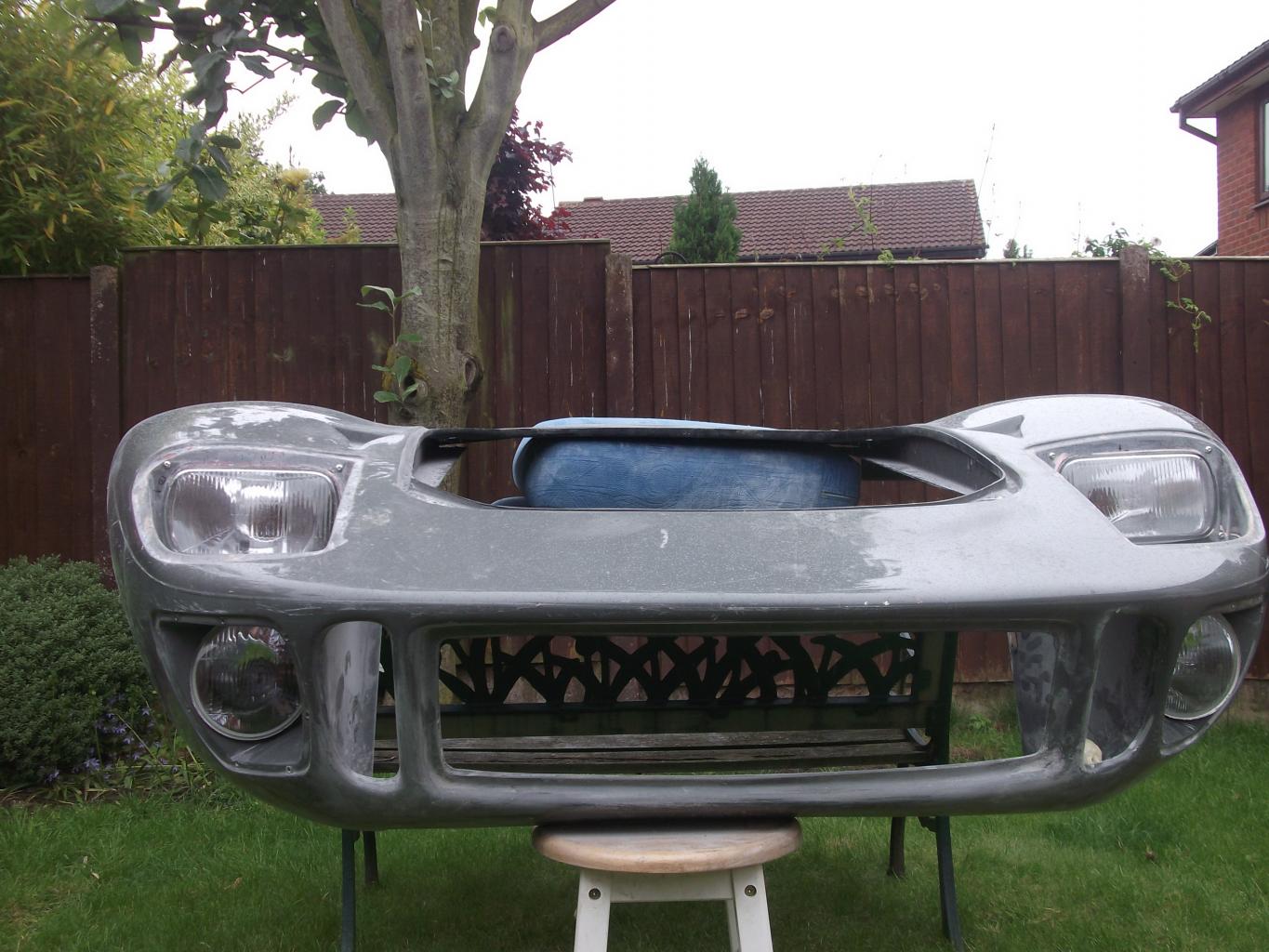

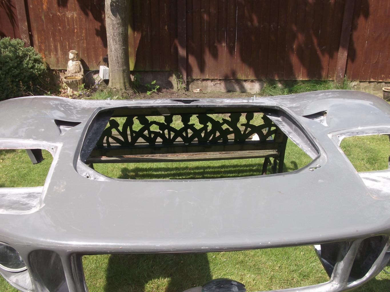

Front lights done.

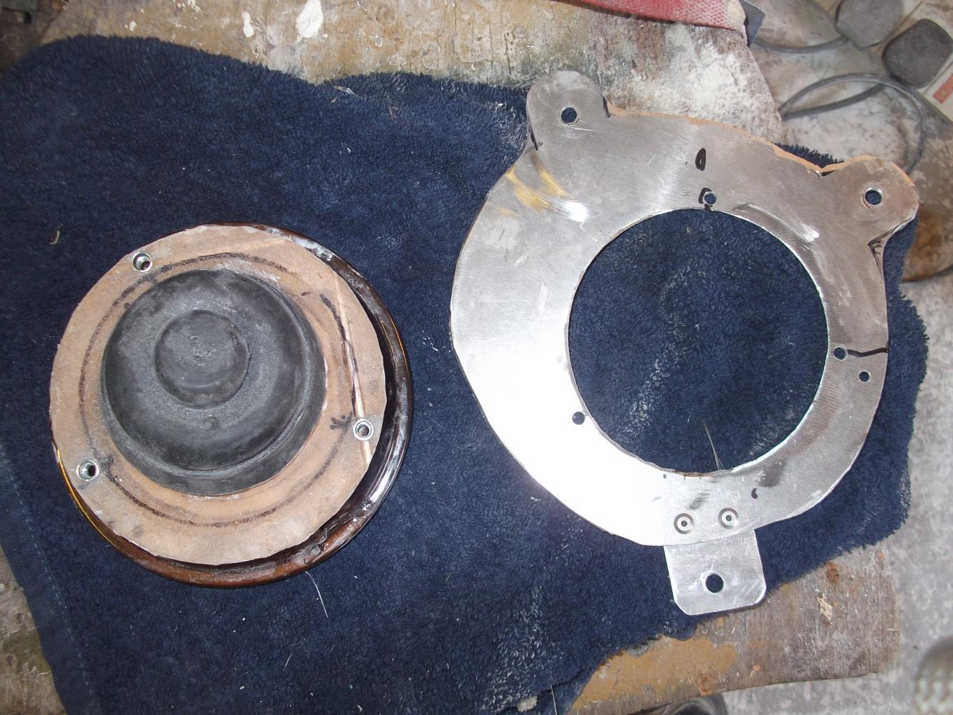

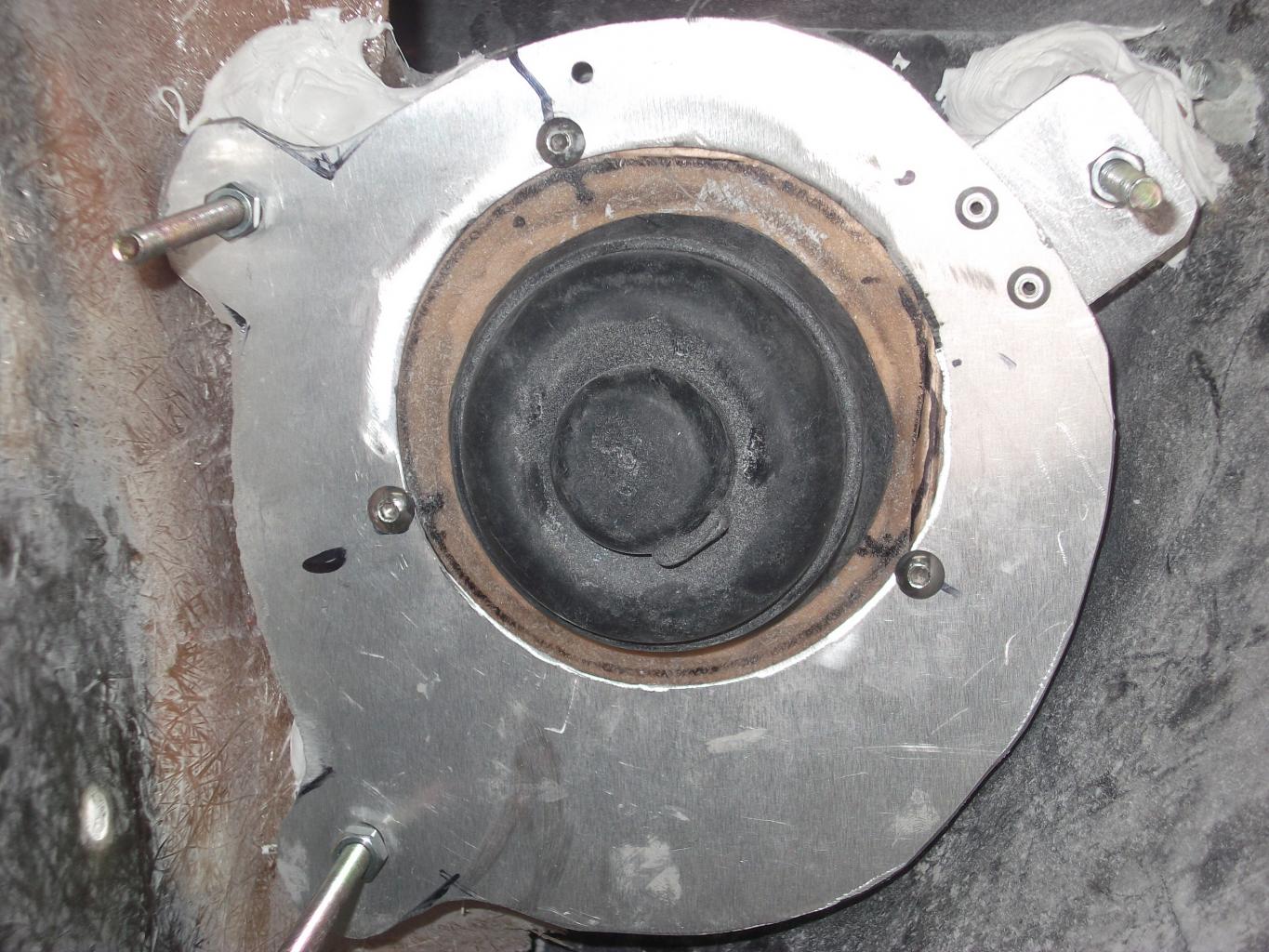

ID:	59763   Click image for larger version
ID:	59764   Click image for larger version
Regards
Nick

Front clips ducts opened up and Southern GT supplied ducting attached.

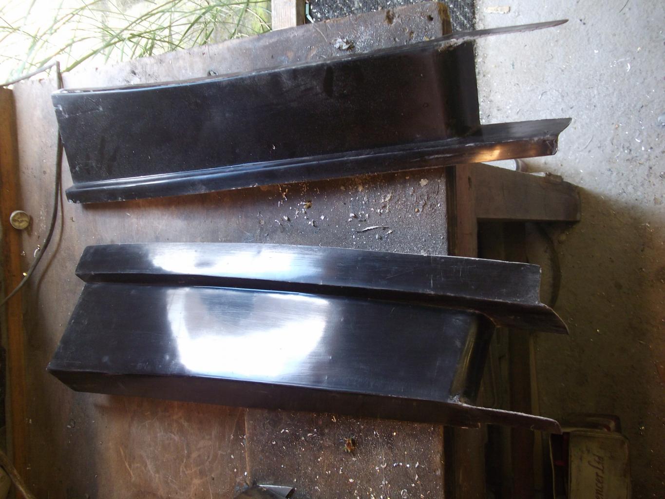

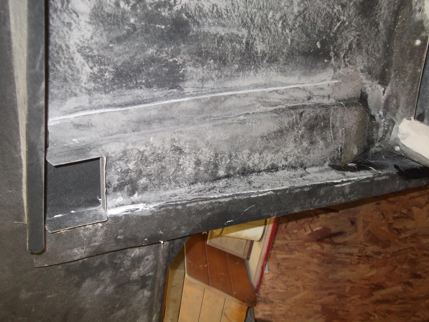

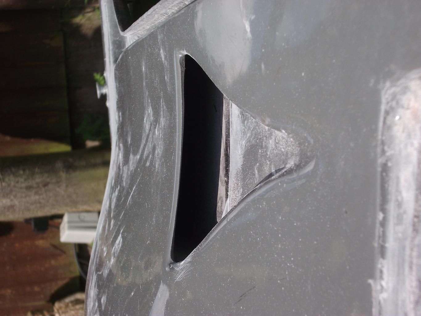

ID:	59766   Click image for larger version
ID:	59767   Click image for larger version
ID:	59768   Click image for larger version

Hi Nick, these vents you have opened up, where does the inlet air go to under the front deck ?
Hi Keith,
The red arrow on the attached photo shows where the air comes out at the end of the SGT ducting, the front of the ducting is (the vent) is shown by the blue arrow.
I then intend ducting air into the dashboard vents when Mick found time to send me some photos on how to achieve this.
I believe Glen Mason has this setup on his car.

I see, If the vents are open all the time would you not get a constant air flow in the cockpit of cold air, summer or winter or can you shut off the cockpit area.
Also I think I have a picture of the vents in Glens car.
When I get home I will have a look.
My 40 is at Micks now ..hold up with VOSA for IVA so what with painting afterwards as well I'm falling back on a conversion for one of my Ultimas. It's a Can Am converting to a fixed head GTR.
Need to keep my finger in.
When I get home I will have a look..
The dashboard vents can close if this is not enough when I hopefully hit 70mph down the Mulsanne straight one day, I can put and extra "trap" in line somewhere.

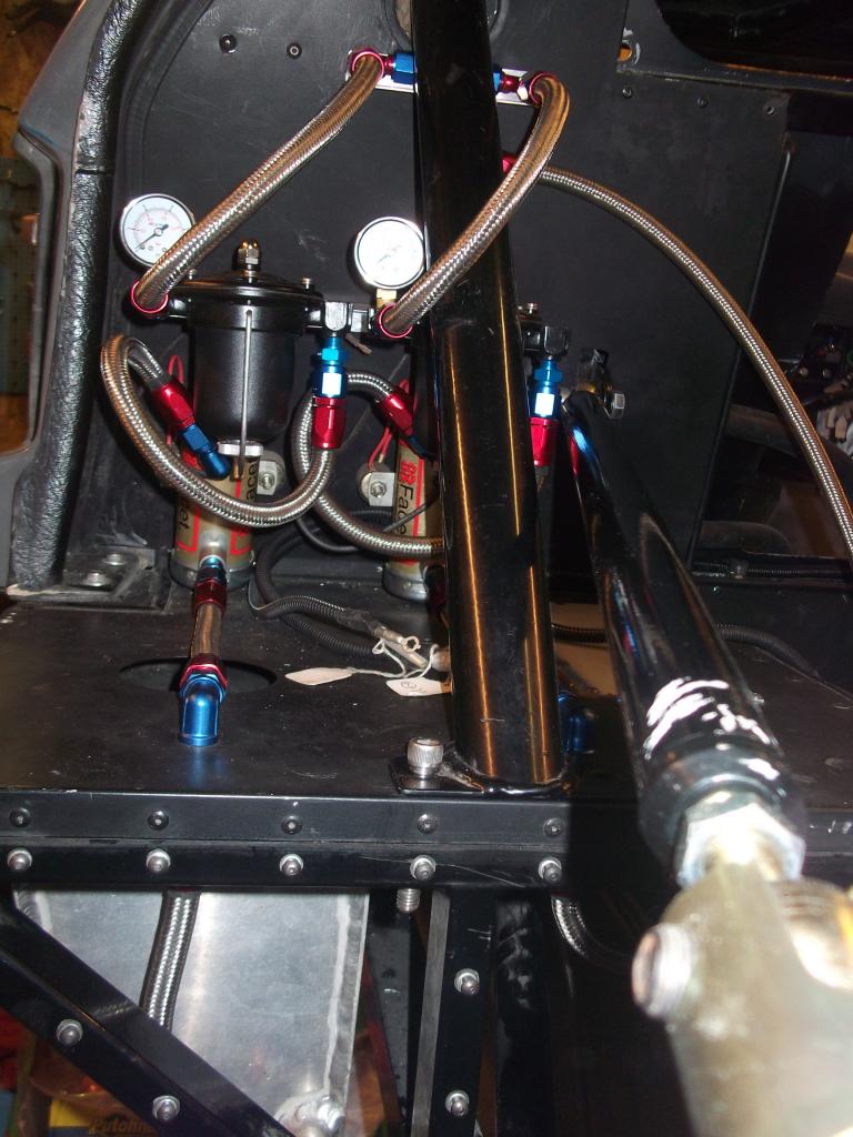

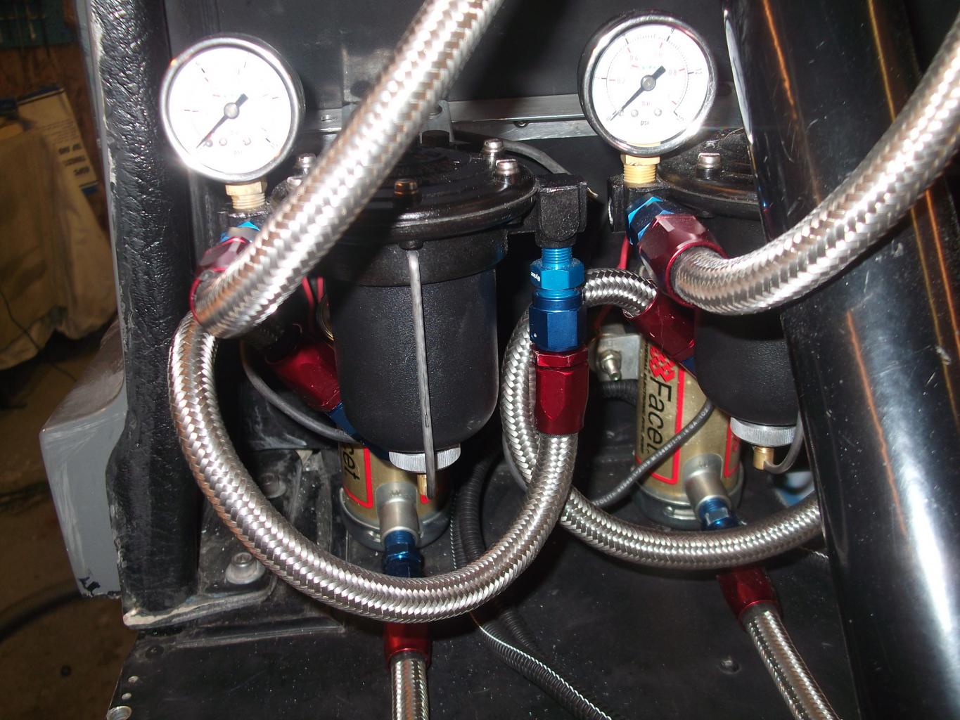

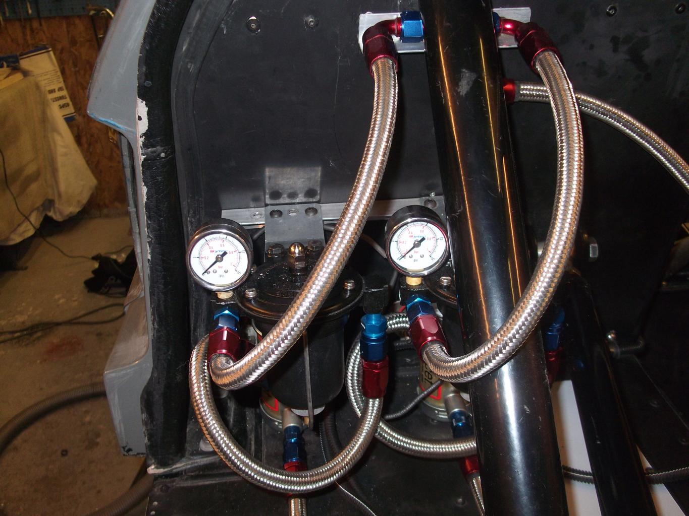

Fuel pump plumbing
Replica GT40 with replica aeroquip connectors

Hi Nick, Long time no hear !
Is that your fuel system ?
That picture shows fuel pressure gauges, which is fine for ensuring suitable system pressure but I was told that the gauges can leak and if they do they spray fuel at full pressure which is not good.
So when pressures are checked, remove said gauges and plug off.
I will do that before it hits the road, just in case.
Also those are Facet pumps I believe, not a big flow rate if using a big H.P. engine.
Wouldn't want to fuel starve the engine at high speed / revs.
