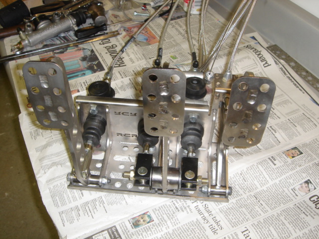

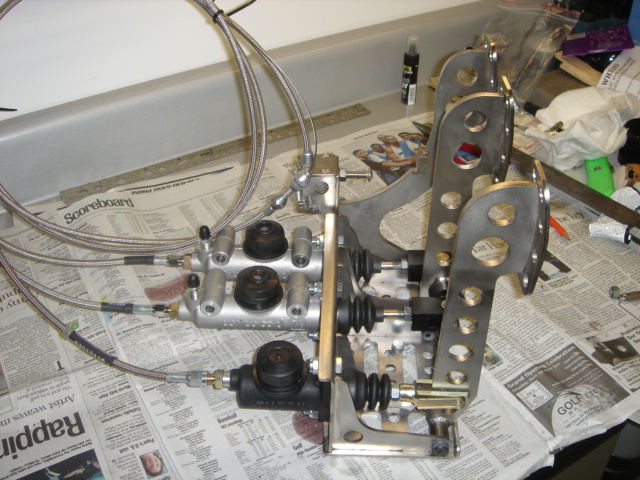

I have finished up the pedal assembly. The stainless pieces looked so good after I glass bead blasted them that I just left them that way. The throttle cable came from Lokar, it looks great and the service was even better..........I ordered it one day and it arrived the next. I took Chuck's advise and ordered the 9' length and it appears about right.
I replace the clutch master that was supplied with a shorter Tilton unit that will give me an additional two inches of travel on the adjustable pedal assembly.
When I reassembled the pedals I used .003" stainless steel shim stock around the shoulder bolts to tighten them up a bit. The pedal assembly looks good and I believe I am going to really like having the adjustable pedals.

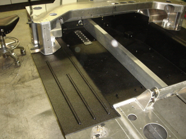

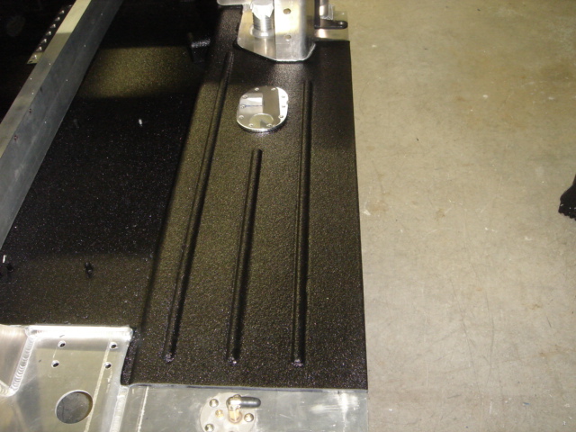

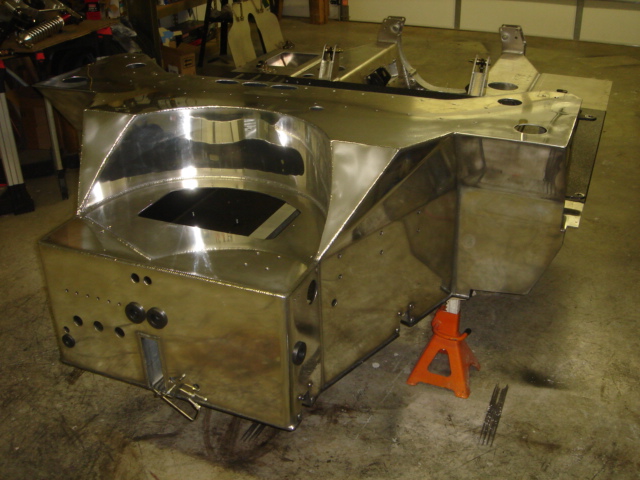

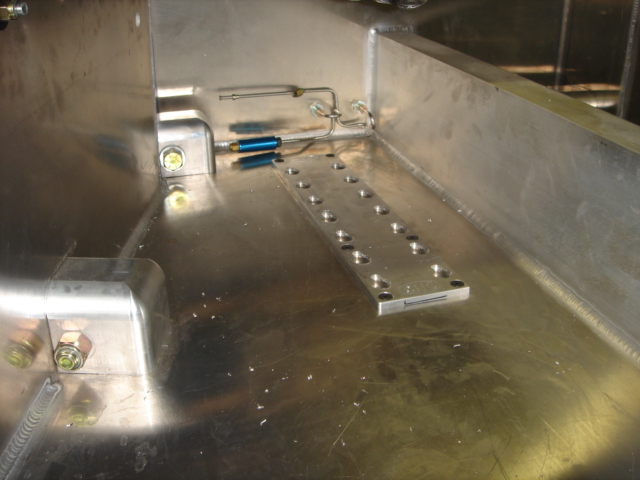

It has been a while since I have posted anything but that does not mean I have not been making progress. My build plan was to "dry fit" everything drilling all the holes making all the cut-outs and fabricating everything I needed so that when I did the assembly it would just be a "bolt it together" process.
After putting it all together I completely stripped the chassis and had the bottom and the driver/passanger compartments sprayed with Line-X.
I attached a photo of the chassis after I got it back from Line-X and I am pleased with the result. The fake ribs are half inch aluminum tube that I cut in half on the band saw and bonded in place. I set the fake access cover I made in place to see what it looks like and I am pleased with the result.

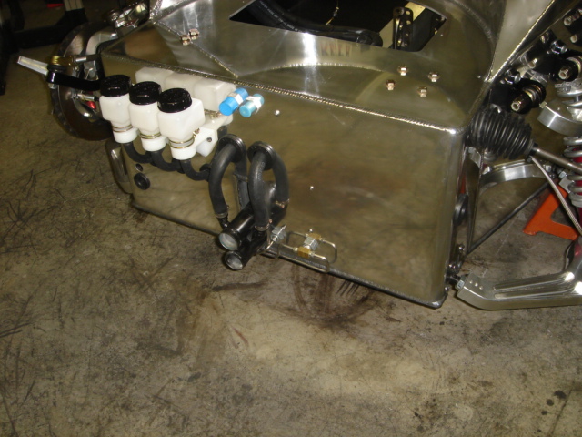

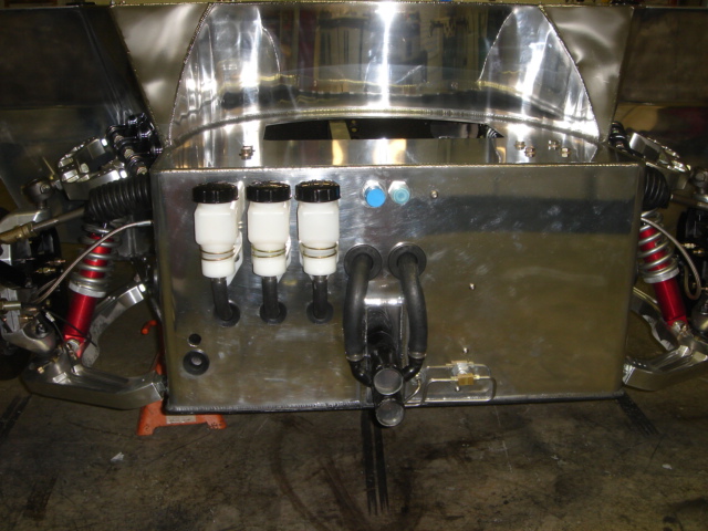

At the suggestion of some of my co workers I decided to polish the exposed chassis areas.
This has takes significantly longer that I had planned not to mention the mess that it makes, however, the end result is definately worth the effort.
As you can see in the photos I have completed the final assembly process for the front suspension and I am working on the brake and AC components.
I've been planning on powder coating my chassis and having the bottom done with Line-X. I may just have to re-think that plan...
If you don't mind my asking - how much did the Line-X treatment cost? It looks nice and thick!

Thank you for all your kind words. Believe it or not the photos do not do it justice, the only real problem now is everything I do puts fingerprints or smudges on it............
My buffing process has been 500 wet paper, grey compound, Mothers polish, red compound (on a softer cotton buffing wheel) then two coats of wenol the first hand applied and removed with an oribtal buffer the second hand applied and removed by hand. I am so sick of polishing (and I am running out of t-shirts) that I dropped the rear belly pan off at the powder coaters today.........my reasoning was the the belly pan will look much better black, but secretly I know if I have to polish one more thing I just may go mad.
The Line-x was done locally here in Huntsville. I had masked the chassis myself but they went back and added more masking as their masking has a wire in it so that it cuts a very nice edge when the masking comes off. I had the bottom coated, the back side of the firewall coated, the back side of the engine access cover coated and the back of the window frame coated plus the interior as you see it in the photos. I brought it to them on a Tuesday and I got it back that same Friday. They called me when they had the bottom masked so I could approve the masking then they called again before they sprayed the inside so that I could approve the masking, they charged me $825. which I thought was pretty reasonable considering the care they took to do it right. They also had a forklift so the load unload was a snap.

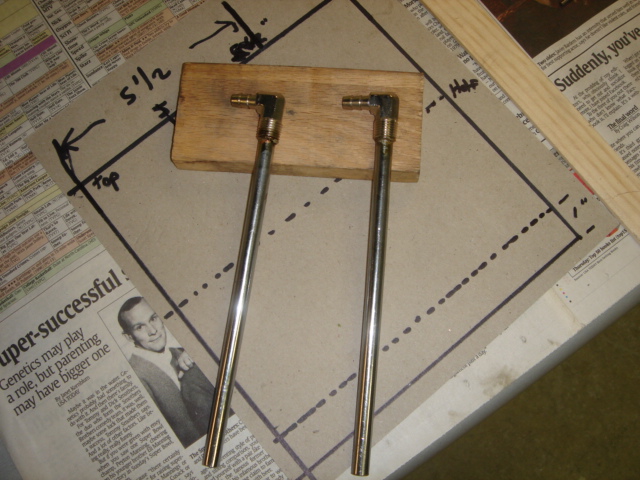

I am more than just a little surprised that I have not had a question about the "heater hoses", so, I will post the reply before I get the question.
Yes, I ran two one half inch copper tubes, one along each side of the coolant pipes for the heater. I made "pipe seperators" from inch and a half CPVC then ran the copper pipe down each side and wraped the assembly with aluminum tape before putting it in the spine. I made hose nipples from 3/4 pipe to 1/2 copper adapters on the lathe and silver soldered the fittings. This way the heater will actually be pulling hot coolant from the top of the intake manifold into the heater and back into the water pump just like Mr. Ford himself would have done it.

Yes, I would agree the Line-x was reasonable but I was really unprepared for the powder coating..............
I brought the roll cage the roll cage brace bars, and every other steel part I could find on the car ( the box must have weighed 20 pounds) plus the radius rods, the cross link rods, the rods that support the rear belly pan and the front steering arms. The did it all for $350. and I had it back in two days! And the workmanship was way beyond what I had expected.
I hope you extended the fitting that you have in the manifold down toward the floor of the coolant jacket and restricted its diameter so that it operates in the manner Mr Ford intended!

Yup! going to use the original fitting that Henry supplied with the 289, 3/8 restrictor and all..........

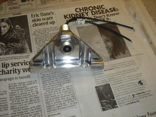

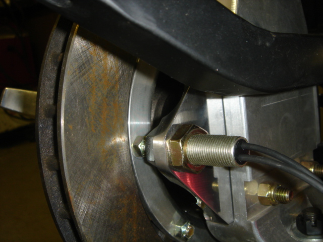

I fabricated a bracket for the speedo sensor but I did not like the final product so I machined this one out of 3/4 inch aluminum plate and it looked so good I decided to polish it.
I used 3/8 socket head bolts with heli coils in the existing 7/16 holes in the spindal.

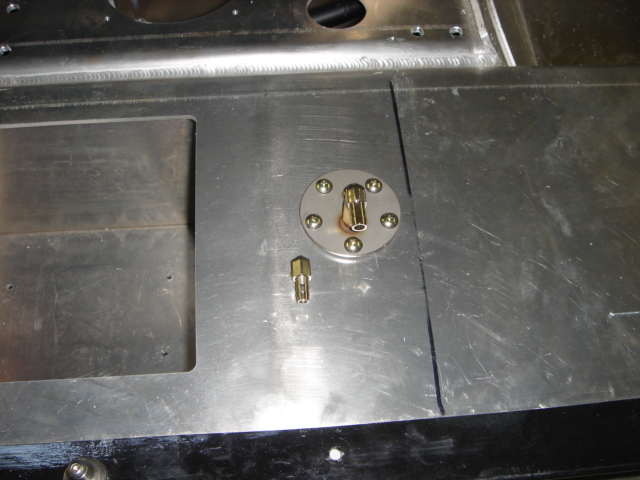

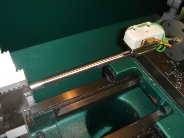

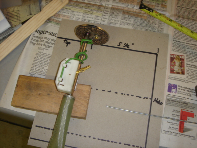

The fuel gauge sending units are very well built stainless steel parts. I wanted to use fuel filters/fuel socks on the pickups but the pick up tubes were too large so I had to turn the pick up tubes down to the right diameter in the lathe.
Chuck gave me some excellent advice about powering up and testing the sending units and the gauge to ensure they were assembled correctly before putting them in the tank. It would have been way to easy to put the sender back on the pick up tube upside down had I not tested them.
All in all I like the way it looks.
