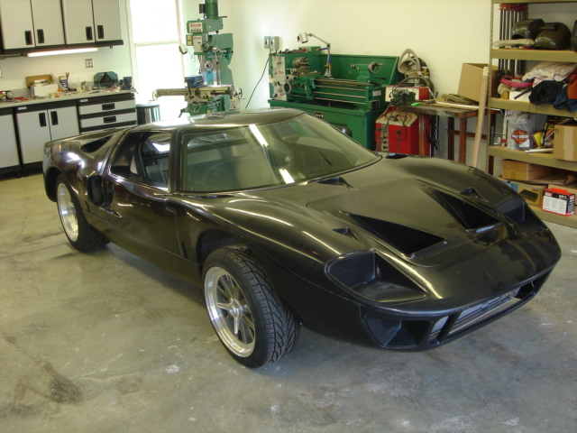

I had it home and in my shop by 9:00 that night (see photo) and spent Saturday sorting thru parts and marking boxes. Out of all the parts in the deluxe kit I only had two back ordered parts the door handles and the axle shafts. The only thing missing out of all those parts were the engine mounts and I believe this was probably my fault as Fran and I were discussing the mounts and I think they got put back on the shelf instead of in the box. Fran had the mounts and the door handles at my front door in less than 48 hours.

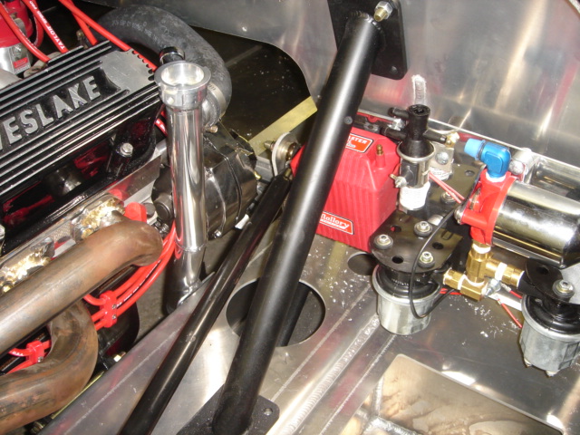

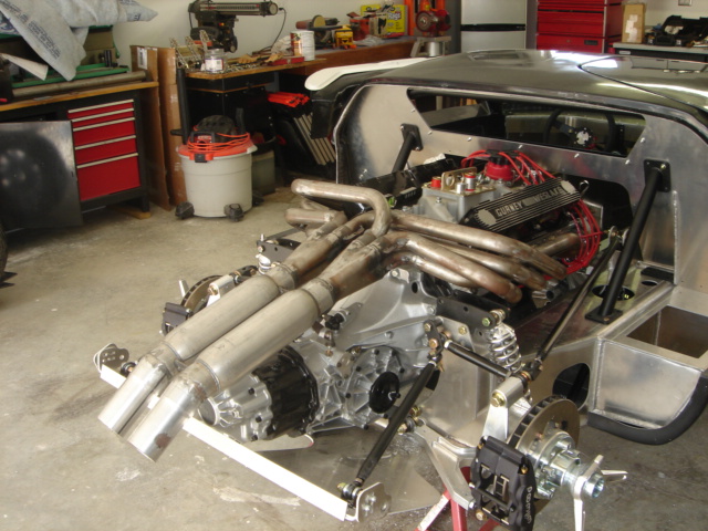

I have worked on the car untill nearly 10:00 every night and I am starting to see some progress (see photo).

You've already got the doors hung and the driveline in her!!! Holy cow!!!!

Congrats !! And WELCOME!! Did you fabricate the headers yourself? They look very nicely done.

Pantera, yes I bullt the exhaust system myself using photos I copied off the forum and U bends that I got from Headers by Ed in Minnesota. The collectors/mufflers were made using a tracing of an RF muffler system that a forum member made for me on a piece of Christmas wrapping paper. It took about 3 to 4 hours to fabricate each pipe. The most remarkable part of this is that they fit the RCR chassis/body with no additional modifications so I will send them off to Jet-Hot next week.

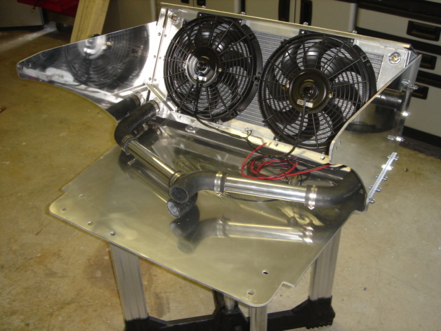

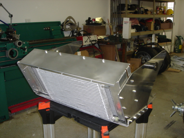

It has been a while since I posted an update. I have been spending my time makeing sub assemblies so I thought I would post a few photos..........
I took Chuck and Ryan's lead and made brackets for the fans and a cover for the radiator and AC condenser.

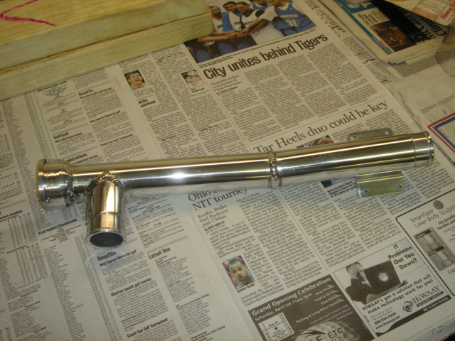

I have also been working on the other end of the cooling system. Unless I can't make it work I do not plan on using an expansion tank in the system. I plan on using only a coolant recovery tank that will collect the coolant as it expands and flows past the pressure cap and siphon it back into the system as the coolant cools back down.
I have attached photos of the coolant tube I fabricated.

Keith:
Radiator / fans looks really good. That is a great shine.
Do you plan to add rubber washers / spacers between the radiator and the suport bracket?

Tom,
Thank you, it actually looked better before the fingerprints......... I did learn a valuable lesson about buffing outside in the summer in Alabama. The rouge does not stay in it's original bar shape if it sits in the sun.
Chuck,
I did buy rubber washers but elected not to use them after running the fan with my old Harley battery. Running the fans at full speed produced little or no vibration, I did not run them thru the full range of speeds to see if I could find a resonant frequency so I may still have to go back and do some vibration isolation if I see a vibration during actual use. Adding the top cover (as I copied from your build) really added rigidity to the fan structure and made it very robust.
