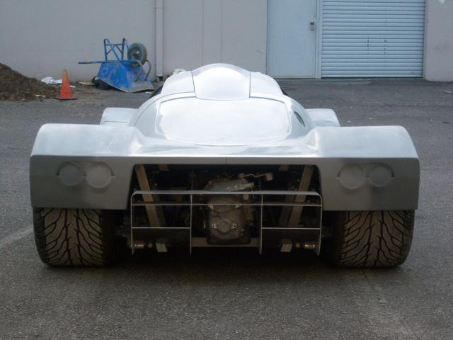

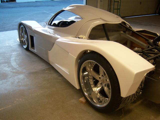

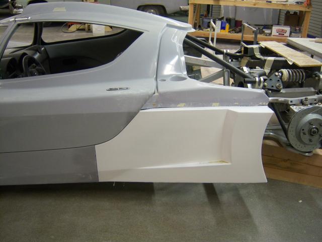

Next time your taking pictures, could you get a shot of the car directly from the rear with the bodywork on? I would like to see a pic that shows off the width of those tires and how they work with the rear bodywork.
OC_ is offline
Old 06-02-09, 02:37 PM   #83 (permalink)
Mesa's Avatar
Mesa
6 Tenths
Join Date: Dec 2005
Location: Santa Clara, Ca
GT40: SLC 001
Posts: 622
Re: SLC 001 Build

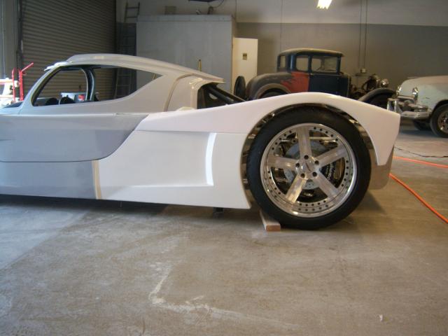

Oddly enough this is actually my least favorite view of the wide body.

But one of my favorites Rob!

Rear shot is bad ass! Like it a lot!!!!

That looks effin great!
I love your rear duct treatment, particularly how the top and bottom follow existing lines on the car and the radiused leading and trailing edges follow the wheel arch, matching the front.
Few questions though....
It looks as if the difference in extra width of the rollers was pushed out instead of split in and out. Just wondering why you elected to do it this way if that is indeed the case. Cosmetics, handling, etc????
It looks like the rear duct opening has significantly less area than the original, possibly limiting/reducing airflow through it. Given the extra width and the room created, it seems you could have increased the opening size (not just in height as you did) providing more air for what you mentioned what you wanted to do.
Are you planning on pulling extra parts out of the molds

Hi Dave,
The wheels have about .5 inch more clearance (relative to the CCWs) between the control arms and the inner lip of the wheel, so in this respect they are pretty close to the CCW option that RCR spec'd for the car. I know it looks otherwise. The wheels are 3 inches wider than the 13 inch CCWs and the car as it sits in the pictures is 6 inches wider total vs the stock body.
The ducting for the areas you speak about are yet to be made, there will be separate custom sized molds made for ducting air to the radiators or coolers that end up behind those now closed off side panels. Since I do not know what size the opening will need to be in the end, I decided to leave then closed and flat for now. Make sense?
Additional parts are possibility....

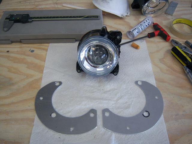

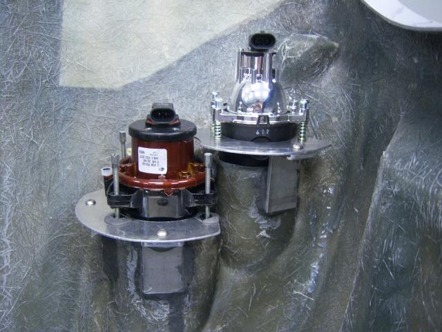

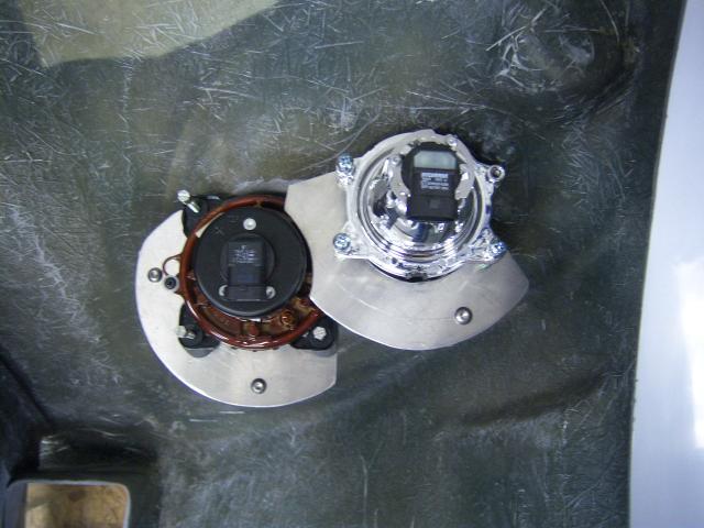

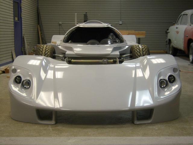

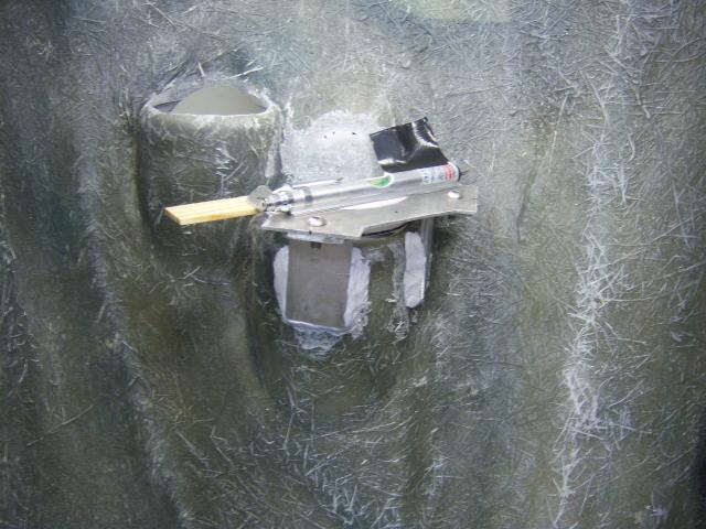

The headlight install.
To get some way to square up the headlight ports I leaned the hood up against the wall and squared it across the top back and bottom. This gave some possibility that the lights would be pointed somewhat straight down the road when done.
I fashioned the HL adjustment plates out of 090 aluminum sheet and the mounting "L" brackets from 1.5 inch / .188 flat stock aluminum.

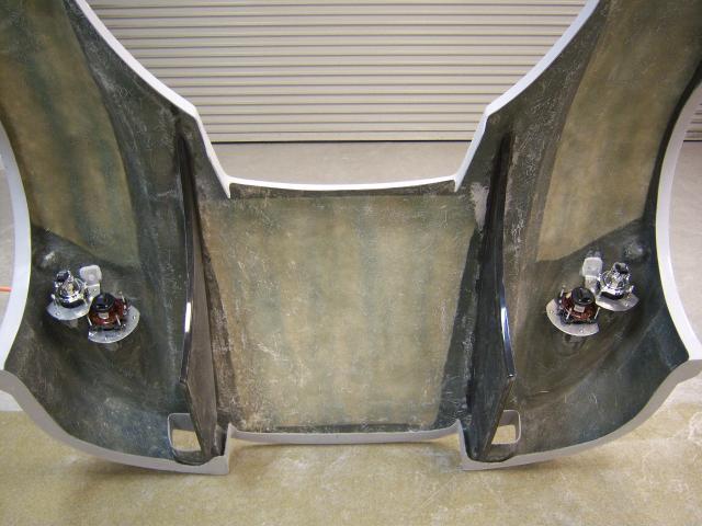

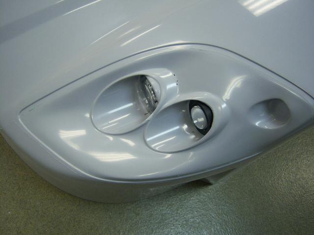

The high beams are 60mm units vs. the 90mm low beams as these smaller lights fit the smaller high beam opening better.

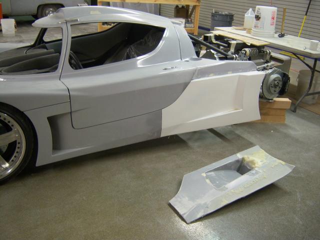

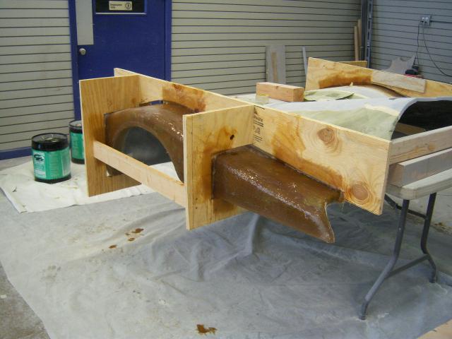

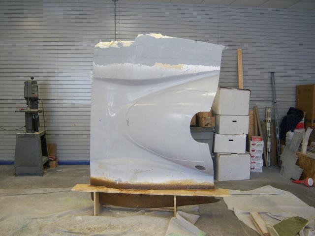

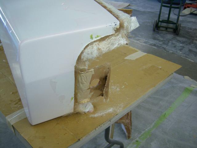

So what have I been doing the last couple of months you ask... Making molds. As you can see pulling the molds off is a little hard on the plugs!
Hey there were supposed to be some pictures here!? Wut up wid dat?
Trying through IE browser....Oh poo I give up for tonight, maybe I'll give it another shot tomorrow.

Let's try again..

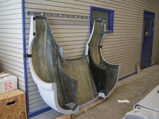

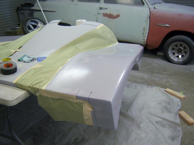

The first part pulled from one of the molds

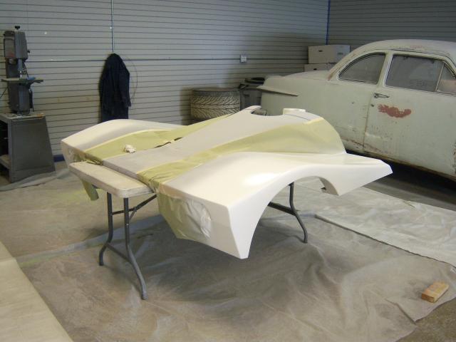

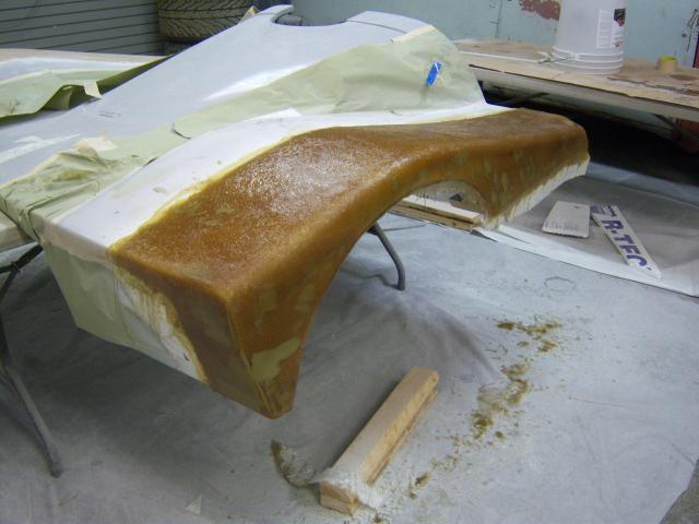

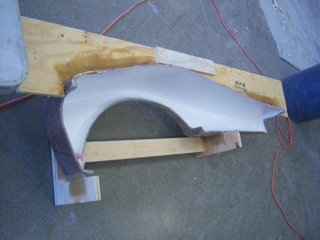

A lot of dirt and dust accumulates in a year's time - In celebration of my car's one year anniversary of delivery (last month) I gave my dirty car a bath. It's kind of tough washing a vehicle with no windows in it. Ah, but it gives one renewed energy to see all the bright machine work in its intoxicating glory.
Last weekend I managed to get one of the upper "flares" laid up, once done I like to leave it in the mold to cure for a couple of days. In reality the anticipation of seeing the finished product was killing me. Did I do a good job? Was it straight? Would it look cool on the car? Months of work were sitting in these molds....I managed to hold off extracting the part too early but it sure was tough. I am currently making the second (right side) "flare" and look forward to being able to join them to the deck lid. The anticipation of seeing all the pieces together in final form will once again...be a killer.
