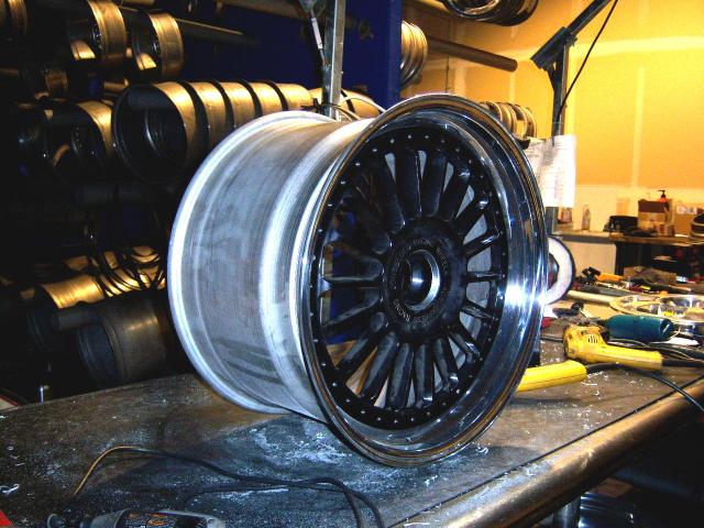

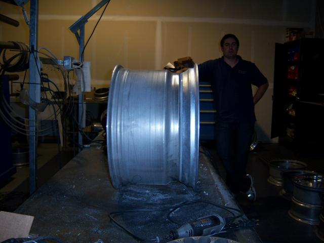

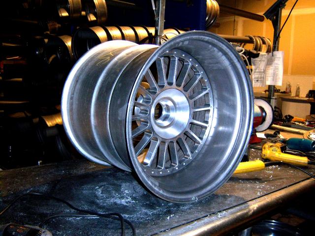

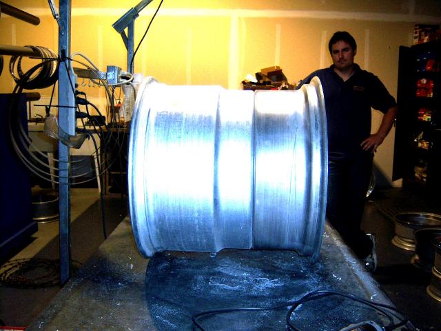

First week with the car - I spent last week taking a parts inventory, cleaning the car, getting the rear wheels pointing in the same general direction, measuring and re-measuring wheel offsets and brake caliper clearances. ''Measure 50 times - cut wheels once''. Now that I have something to look at I can contemplate the possibilities on wheel sizes/widths, centerlock? forged? three piece? one piece? John at CCW is a tremendous resource when it comes to knowing street tire to race tire dimensional and availability comparisons. I also made an appointment to see Jongbloed Racing Wheels since they are in my 'hood. Ryan at Jongbloed put together some wheels so I could get an idea what the measurement I gave him would look like. One possibility is to use really wide rims and tires in the back for visual 'impact'. The downside is the street tires available in this size are just 130mph speed rated and require 'coke bottling' the rear body panels to cover the extra width. On the up side the like sized race tires would be coming from a Lemans spec LMP1 car (Audi/Peugeot).
The more standard 11 inch front and 13 inch rear would be a no brainer by comparison, with Michelin offering every dimensional possibility imaginable! .... for a price.
See pics of the centerlock Jongbloeds made from unpolished and dust covered rough fitment pieces. (You can tell from these wheels I always wanted a Can-Am car! <big grin>)

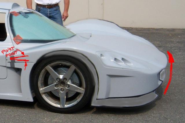

Another thing that has me thinking .... since the car will spend at least half of it's time on the street, .... how to keep the front end of the car from being busted up on driveways? After looking over the inner structures it seems this is a possible solution. Support the pivot point with a wide bracket the width of the flat area between the windscreen and the edge of the body. Bond the front splitter (which is fiberglass) to the nose for added rigidity and make plastic slide pucks the width of the underside of the splitter (or make from delron) too keep the splitter from hanging up on the ground. Use locating slides on the sides of the chassis located radiator side fences (there are corresponding fences bonded to the underside of the 'hood') to limit the upward sweep. To finish it off have a cockpit triggered lock down catch to keep it from pivoting under normal use. I don't like the fact the 'hood' will open the wrong way but don't see any other way to address this challenge without building a heavy reinforcing frame for the splitter. And making the whole splitter out of delron plastic too keep the pressure of a ground impact off the bodywork. Either this or build in a lift system for the front suspension that will be a whole lot more complex (and heavy) me thinks.
You gents have any ideas?

I agree with the idea that the front end needs to be liftable, and have spent considerable time thinking about it.
The GTM crowd is using the Delrin wear pads idea, but I really don't think it is a good fit for the SLCs with their even longer front overhang.
Fran mentioned to me that he thought he knew of a source of hydraulic spring perches. These look like thick bottom spring perches on a coilover, but expand in length on application of hydraulic pressure, neatly lifting the spring (and car) when needed. I hope to source such a perch and try it.
Another solution is to use a hydraulic ram to bear on a bracket that will lift the lower control arm. I haven't detailed the solution yet, just the idea.
I considered airbags but the apparent lack of a documented spring rate has made them look unattractive as a solution.

Latest findings - If the car is set up with 4" of ground clearance in the front, the suspension has 2" of droop. If a hydraulic spring pad idea is employed IMO it will not render enough lift. Cillian's idea may prove of use but I have not had a chance to inquire, although one would think it would require at least a longer shock/ram to get more lift. I'm still partial to pivoting "hood" idea with one addition - have the hood be lifted and controlled through a 4 inch range by small electric rams. This way one could lift the front without it ever contacting the ground, thereby eliminating the possibility of the splitter getting wedged in a crack and transfering the load to the hood. Visually it isnt much uglier than a Maserati (MC12?) being lifted by it's hydraulic suspension to clear driveways is it?

I always go for the KISS principle. I think a permanently fixed rubbing strip that lets the pavement lift the body is the way to go. Light, simple, effective.

Here's a out of the box idea. Do you really need to lift both fronts? I nearly always "crab" my GT40 over speed bumps. I lead the bump with either the L or the R front. This really gives the front of the car quite a lot of effective height as the tire that approches the bump first does so from the center of the car out, with the tires turned towards the bump and the low body point following. By the time the bodywork reaches the bump the tire has begun to climb the hill and raise the car. It nearly always seams to be enough. I have about 4" of RH in the front of my GTD.
There may be something very simple to build using this concept that might work. Only one side to deal with.

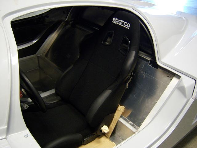

I drove up to Sears Point Raceway to have a sit in some seats. I would find/found it difficult to get a comfy seat without trying a selection first (as in mailorder). Of the articulating back units they had the Sparco Torino worked best for my body..... the other Sparco's were way off - I'm glad I made the effort. The seat fits pretty well except for it's slightly too tall or about 1" too tall if using the adjustible seat tracks. The seat bolted directly to the floor will cause the top of the seat to just slightly graze the roof at some point in it's arc. When fitted to the passenger side the issue is a little more as that side the seat is more outboard due to the driver side floor pan being a bit wider. I'm sure I could have shop reshape the top of the seat to clear or I could find a seat with a shorter back, the Torino is 35" floor to top. The seat pad is 3" off the floor and has about 2" of padding that could be contured to lower the driver more for the "max" headroom challenged individual, I am 5'5-6 and have about 2" clearance using this seat, more if I recline it to the max.
