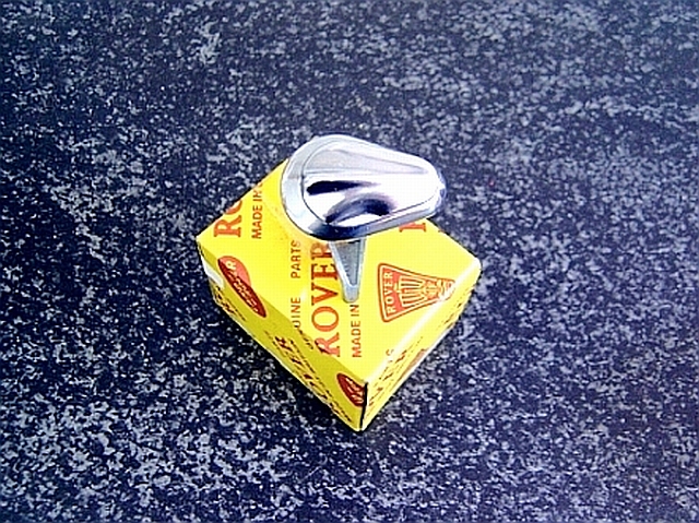

Originally Posted by RWoerz View Post
On the shifter medallions what do you mean by early, also what determined what color was used? Did you have these made?
It depended upon which gear lever set-up was fitted.
I have rarely seen these on original cars, definitely not seen one on a MKII and only one on a MKIII.
The plum knob which was fitted to Lotus cars were the type used and some knobs were flatter on top with a larger medallion.
Translucent Ruby Red was the original colour for the cloisonne but I had the black ones made up because we fancied them on our washbasin taps in the workshop.
James

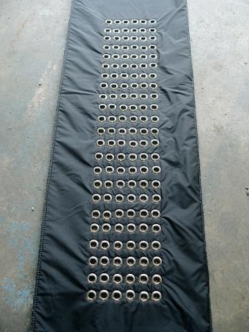

The matresses are coming together nicely at the upholsterer.
We used nickel eyelets in a fire-proof ballon skirt material. The seats should be complete in a couple of weeks.

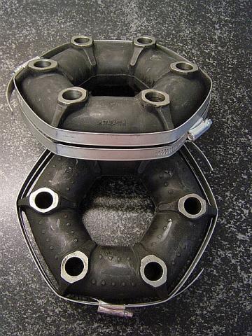

Brand new Metalastik couplings

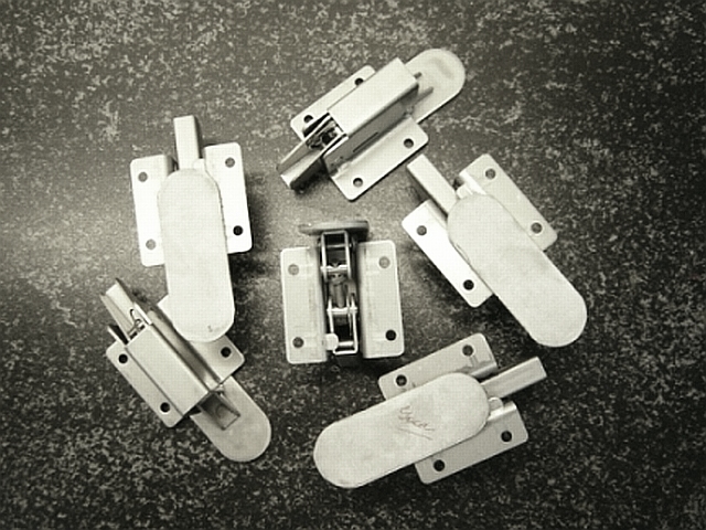

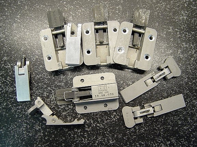

More bodyshell parts
Name:	Body Shell - Chassis Brackets.jpg
ID:	38336   Click image for larger version
Name:	Body Shell - Rear Clip Slam Catches.jpg
ID:	38337   Click image for larger version
Name:	Body Shell - Wheel Ties & Rear Clip Strap.jpg
ID:	38338   Click image for larger version
Name:	Body Shell - Hartwell Latches.jpg
ID:	38339   Click image for larger version
Name:	Body Shell - Door Lock.jpg
Name:	Electrical - 5-pin Plug & Socket.jpg
ID:	38341   Click image for larger version

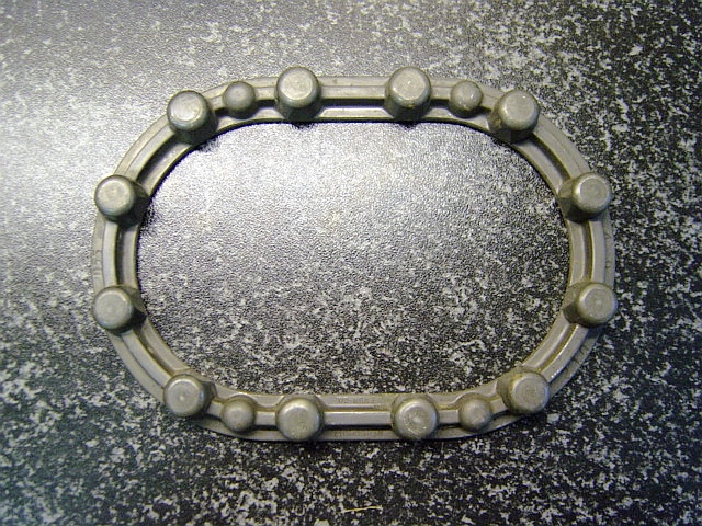

Name:	Fuel - Sponson Nut Seal Ring 2.jpg
ID:	38342   Click image for larger version
Name:	Body Shell - Front Clip Fasteners.jpg
ID:	38343   Click image for larger version
Name:	Cockpit - Window Fixings.jpg
ID:	38344   Click image for larger version
Name:	Body Shell - Door Strikers.jpg

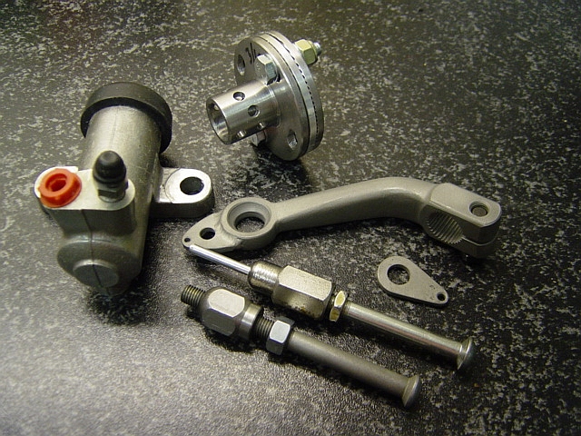

ZF-0 & 1 Ancilliaries ~ Clutch slave, lever and gearshift coupling.
That lever was hand fettled by a friend of mine.

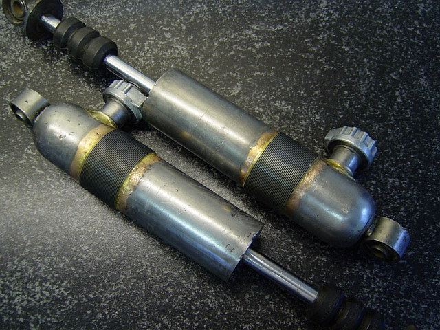

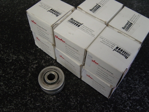

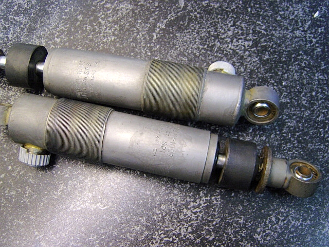

Original specification Shafer bearings and Konis dated 1966 for the suspension.
Also the later Armstrong shock absorbers.

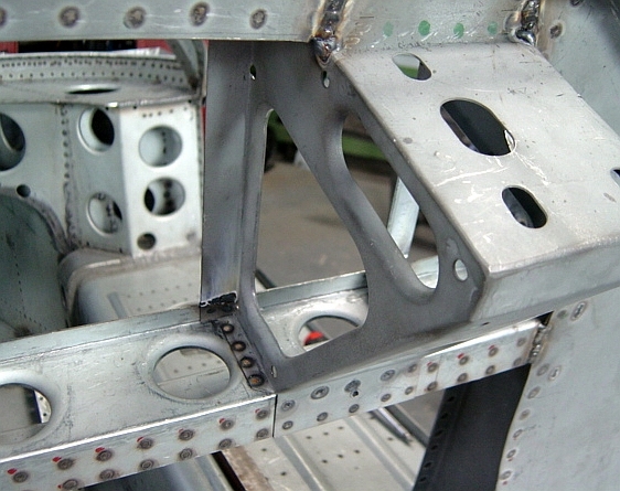

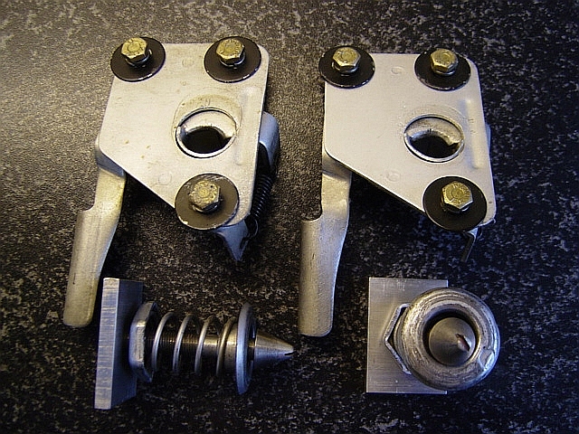

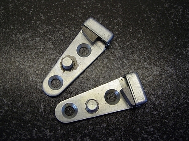

We decided to fit the early slam catch brackets as shown at the top of the photo.
This is a much stiffer member because it also fixes to the inner bulkhead with the two vertical straps. The lower simpler design in the photo is an original bracket for later chassis numbers.

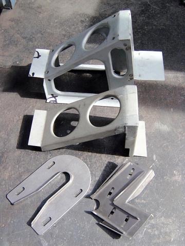

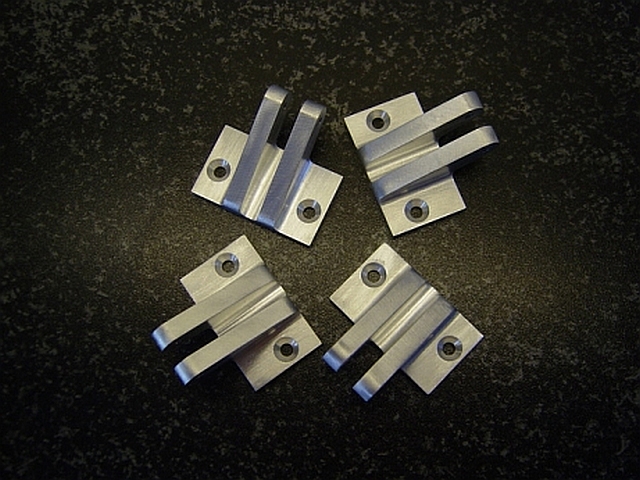

This is the preferred Mirage bracket fitted.

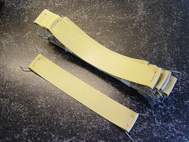

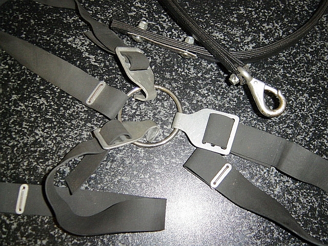

The seat cross webbing is in.
This is made with the original drawings and materials and the vertical straps will be rivetted when the buckets are fitted.

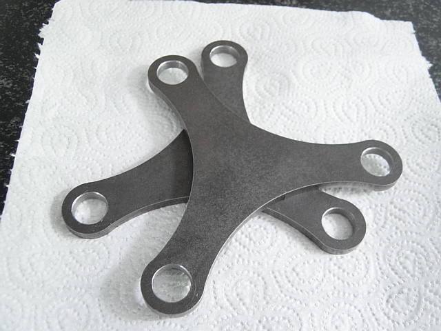

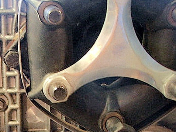

Spreader plates for the Metalastik couplings.
These need to be bevelled properly as shown in the second photo.

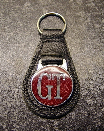

There is not many of these about in this condition.
~ A matching key fob.

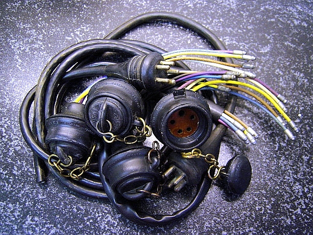

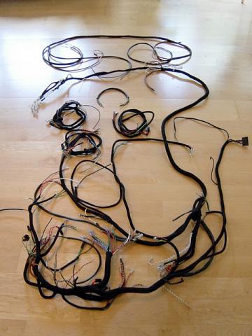

Here is an original loom.
We are now remaking the rubber 5-pin and modern 6-pin wiring plugs and connector sockets (the dies and brass pins are compete).

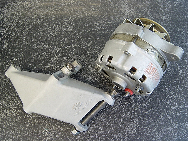

NOS 1967 Alternator & Original Bracket

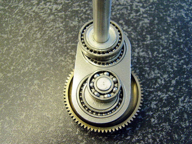

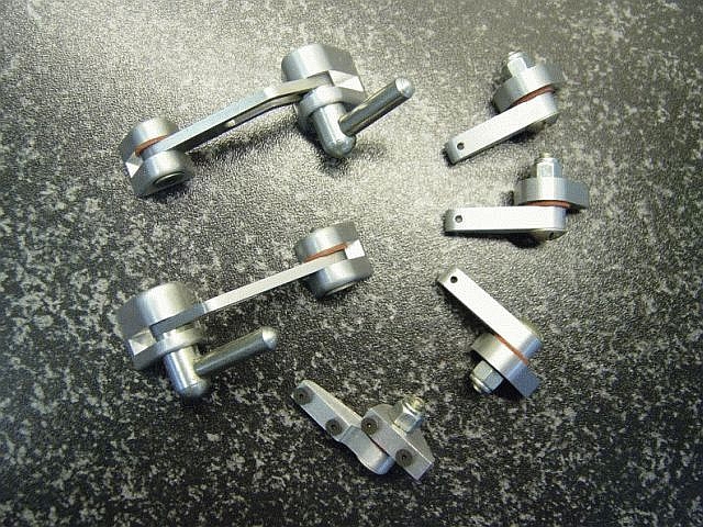

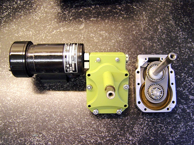

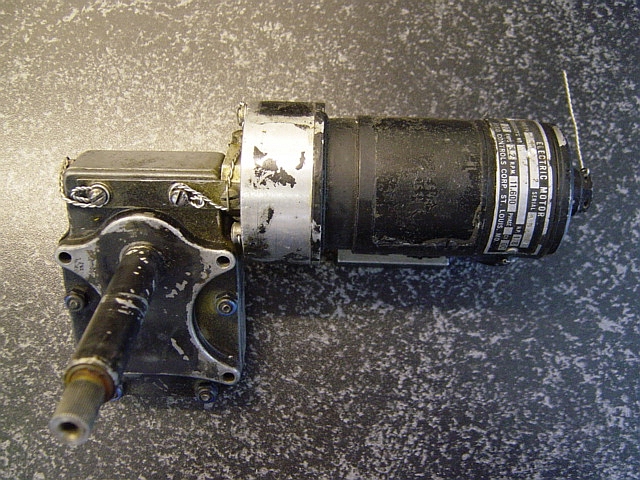

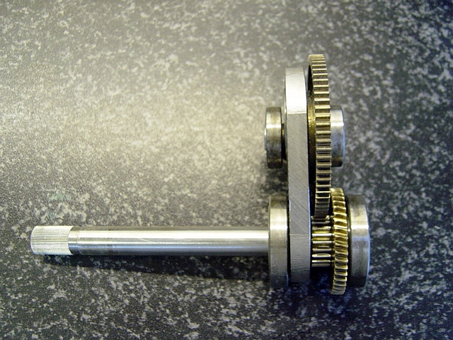

MKII - Wiper Motor Gear Train & Splined Shaft - 120 degrees
Stronger than the usual Lucas wire driven sprocket

In addition to a pair of new ones, I managed to get five used Wiper Motors so did a bit of restoration.
Name:	Wiper Motor & Converter.jpg
ID:	40087   Click image for larger version
Name:	Wiper Converter Restored 002.jpg
James
