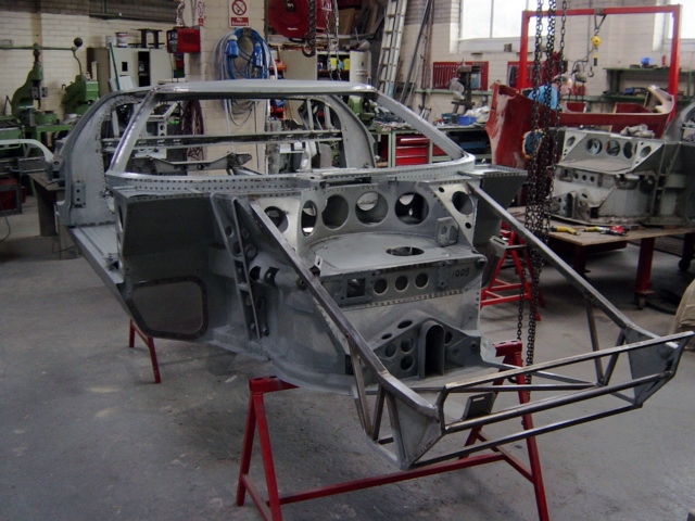

Dave,
You have got me thinking.

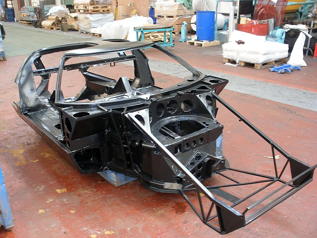

I have now decided to prime my chassis by electrophoresis here in the UK.
Shortly, the chassis will be chemically cleaned, etched then dip coated with zinc phosphate and a subsequent primer coat.
He is an original chassis recently done at the works.

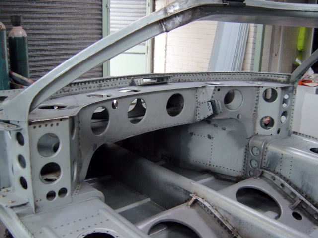

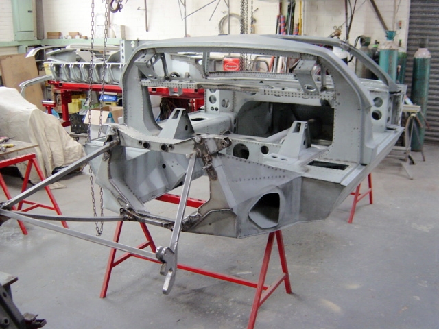

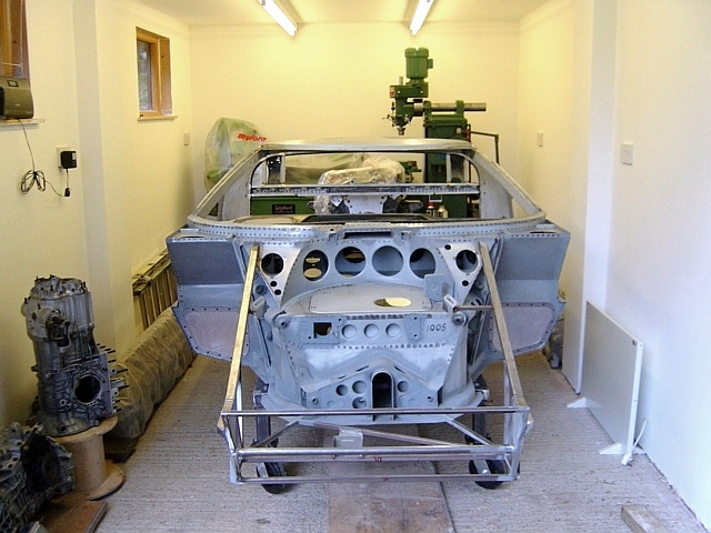

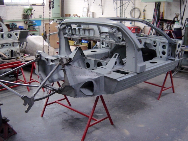

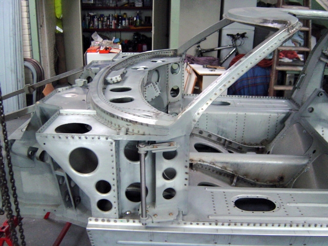

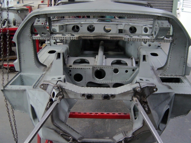

My chassis complete and ready for shipping to the electro-finishing plant.

James

Well the chassis was delivered this morning fitted to an excellent build table which greatly assisted in the RO-RO from the low loader.
I have decided to drill all the fixing holes and fit self clinching nuts before it goes for coating. Hopefully I will get the majority of them. I am checking off my list of parts and making a hole schedule along with a fastener MTO from the JW Automotive parts list and the drawings.
The wiring and plumbing layouts might take a while to coordinate but I won't be rushing in for the sake of it.
