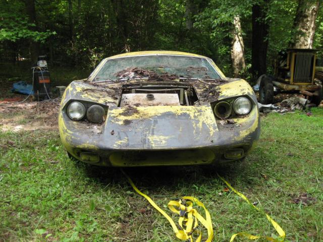

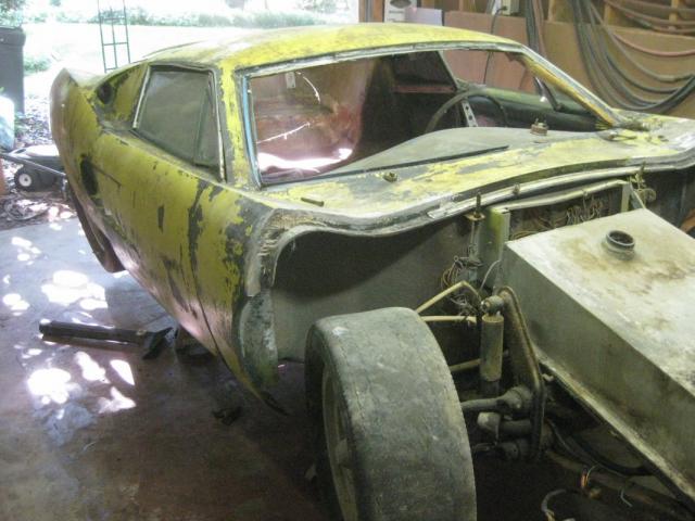

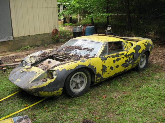

I know this not a "real" GT40 but it is all I can afford right now. This is a circa '69 FiberFab Avenger GT12, a grand daddy of the GT40 kit car. This has a '63 VW pan & engine. It sat under a tree on blocks for at least 15 years. It didn't even make into a barn. It had Porsche 356 motor that was trash.
Same wheel base & over all size as a GT40.
I am still in the demolition evaluation stage. I am looking at tail lights, scoops and etc.
Sam.

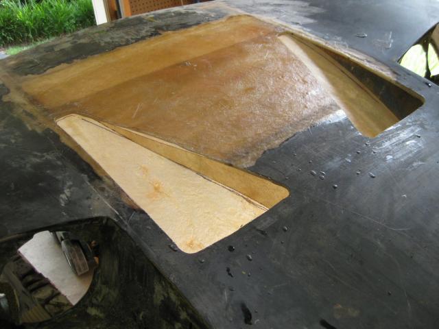

Thanx for the good words. I am having fun. I first had to rebuild the center of the nose section. Then I decided to add nostrils.
I was going to add the NACA scoops behind the headlights.
Were do the scoops put the air or are they just dummies?
Nice work there Sam!
Regardless the degree of your search for that more authentic look - You may want to add the spoilers at the leading edges of your nostrils. This will make them much more effective in drawing airflow through your radiator.
Other images can be found all over this website as well as the gallery;
GT40s.com - PhotoPlog - Gallery
On the NACA scoops behind the headlights - To my knowledge they were simply used as cabin air inlets. Be aware though that you may end up piping rain water into the cabin should you get caught in a storm..
Enjoy your project and please keep posting updates!

Thanks Randy for the close up of the nostril lip. I believe I can do that. The nostril is just for show since it has a VW engine. I may add AC & could use the scoop for the condenser
I may just put the two NACA scoops in the nose section in as dummies. They just look neat.
The scoop at the base of windshield can be made fuctional if I build in a water seperation chamber.
