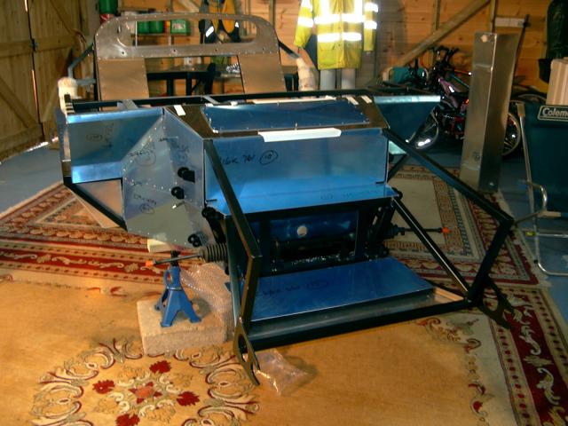

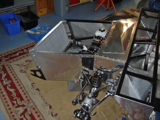

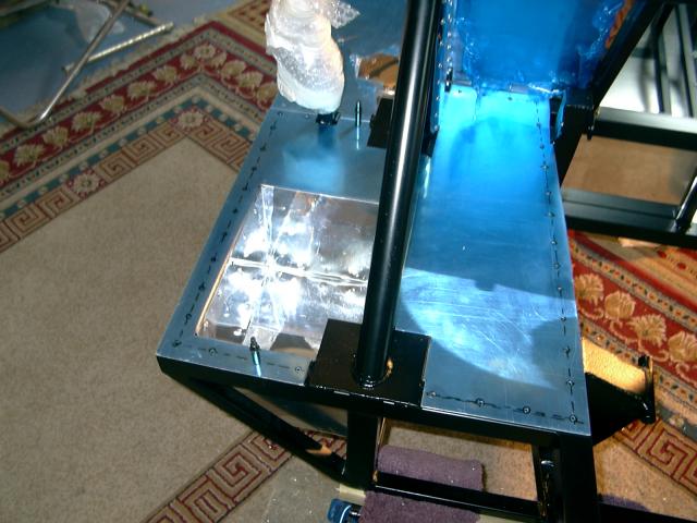

Made up a battery box this weekend, riveted in the rear section, and started fitting the front upper and lower panels...

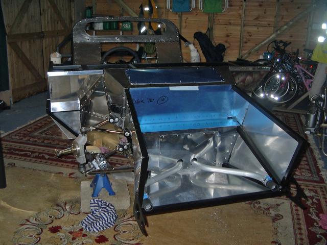

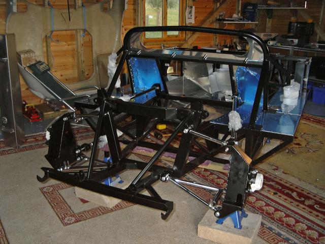

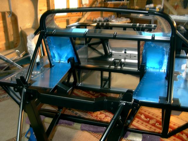

Re: Scotland Tornado

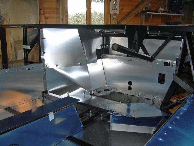

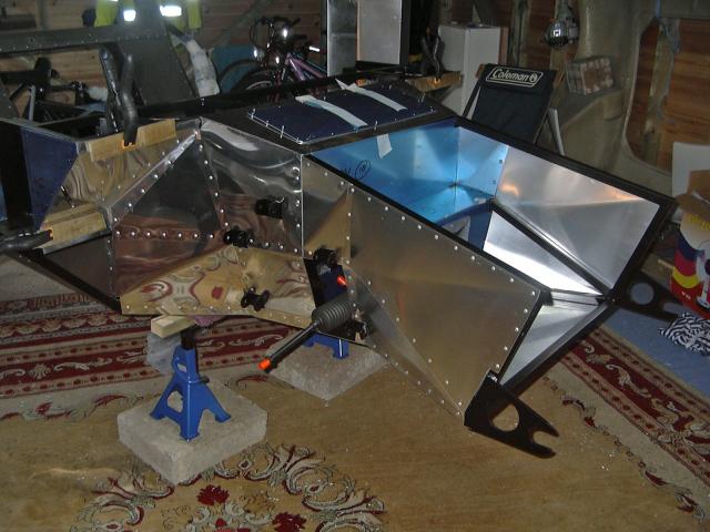

Started fitting removable inner panels for the front footwell area and an outer panel between the cockpit and fuel tank. Also started on the rear suspension...........

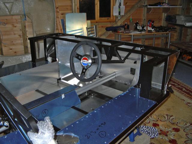

Hi Ian,
You’re making good progress on the paneling. As part of the interior paneling, you will need to consider how to close in the area where the fuel filler pipe comes up from the sill to the fuel filler cap. This area will have to be sealed for the IVA test.
Also if you are double skinning the inner sills, remember you may need access to the mountings for the gear lever (mine is different in this area and I can’t remember if the standard chassis has captive bolts)

Posts: 203

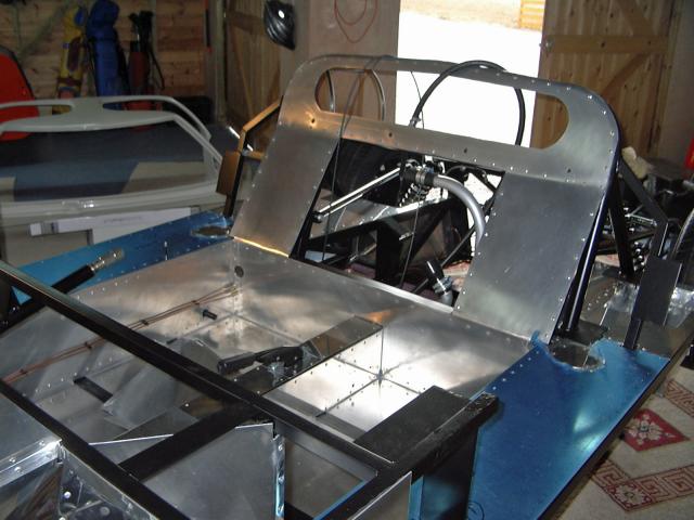

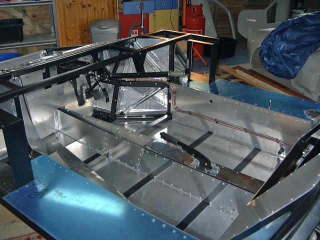

Bit more progress.......panelling almost complete with some panels left un-rivetted to make life easier later. Plan to start completing suspension, steering and cooling system next.

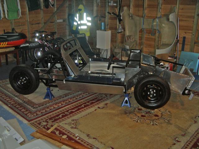

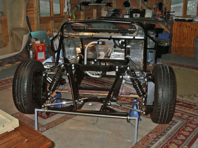

Posts: 203

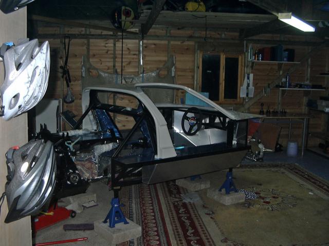

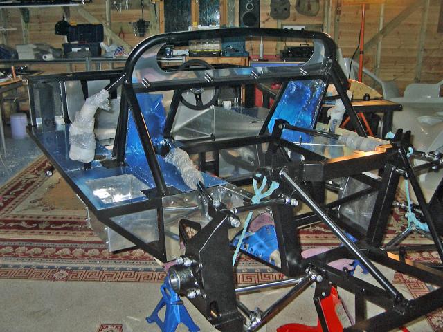

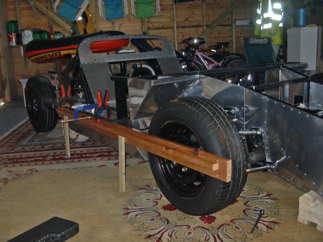

Main cooling pipes fitted, steering column fitted and front suspension fitted (almost). Fuel tanks back in. Put the lid back on so its starting to look more like a car (than a boat, re my wife!!)....

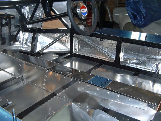

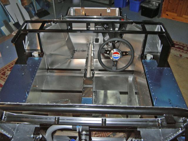

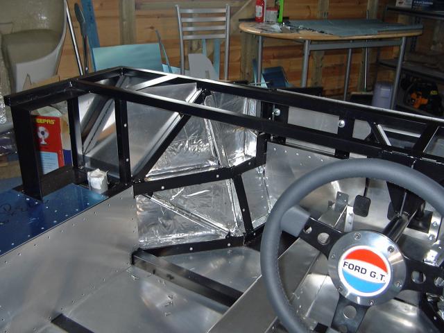

Its been a while since I last updated my build log. The snow started on 17th December and only just recently went! Lost my motivation to work in the garage in the long dark nights even with the heater on full blast. Now with spring in the air, have started again with vigour. I now have the car up and running on its own suspension and the temporary wheels and steering are aligned The radiator is in as are the servos (had to remove a panel to fit the near side, but that was my fault for not forward thinking!). I also wrapped the centre cooling pipes in heat wrap to hopefully eliminate some of the heat in the cockpit.
Next job is to start lining the cockpit area inner skins with some insulation (using something very similar to Dynamat but without the high price tag) then will start on the hydraulics and brakes once the side panels are rivetted in. A few photos below showing current progress (and the missing front panel, doh!).

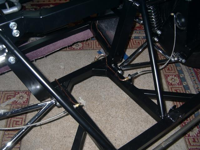

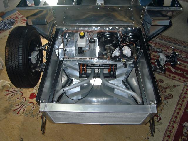

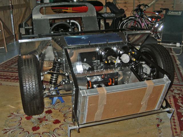

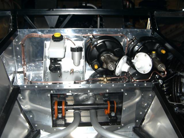

Have now fitted the brake servos and almost complete on the brake and clutch piping.

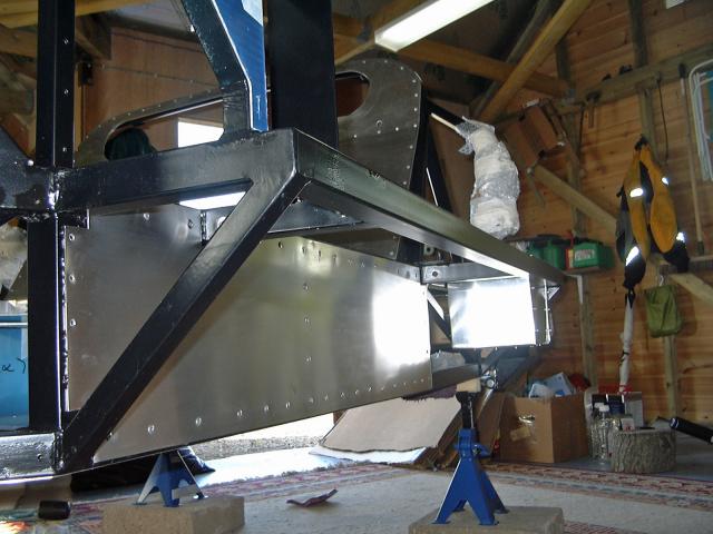

Finished running the brake cables and the servo vacuum hoses. Put the side panel back on and made up a cover to accomodate the near side servo which protrudes slightly outside the frame. Also fitted the radiator and made the connections to the cooling pipes. Fitted the accelerator cable and ran the cable back to the engine. Ran the accelerator cable and the servo hoses through the centre tunnel. I'll get hold of some P-clips and secure these to the tunnel wall. Also fitted the handbrake but havent yet made the cables connections to the brakes. Finally riveted in the top panel and put in some angle to neaten up the edges.
Your obviously making great progress and your workmanship looks excellent. Just one thing the brake pipes along the cabin could be vulnerable to being knocked and potentially damaged, will you be covering them? I thought about running mine in the same place but opted to run then down the sill side if that panel.
Keep up the good work and keep posting pictures.
Martin, thanks. A cover is fitted on the drivers side that covers the gear linkage and the brake pipes that run on that side. I am also fitting inner panels at the front and the brake piping is run behind them and within the chassis as far as possible so they wont be knocked.
